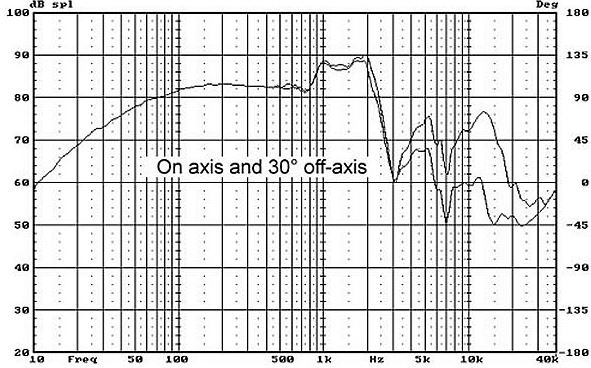

A little homework reveals that the Kevlar HiVi D5G is quite an odd driver. More of a high inductance bass unit in fact.
The tweeter is a fairly regular metal type.

If S7's graph is for the D5G a standard two way is a world of
pain, the midrange is pretty unworkable with a simple x/o.
Fixing the 3 way may be the best idea.
All 3 ways do not follow the Duelund criteria, pointless aside.
rgds, sreten.

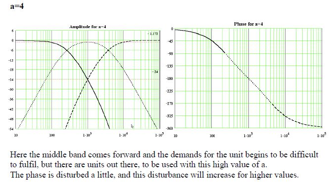

Also have a read of Allen's sticky thread http://www.diyaudio.com/forums/mult...designing-crossovers-without-measurement.html
The best way to design the filter is with simulation, preferably with actual measurements of the drivers, but you can also use data traced off manufacturers curves.

The best thread for you to start with is "introduction to designing crossovers without measurement" by allenb.

Just looking at the datasheets, the peerless, tang band and dayton look the friendliest on your list.
The only thing I don't like about the tang band is the dip starting at 300Hz and ending 5db down at 400 Hz, probablty the bigger problem though is that it doesn't fully recover until around 1500Hz. Other than that I'd say it looks like the best of the three from an ease of crossover point of view.
I'm not sure about the Hivi datasheets they all seem to exhibit the same sort of response, and I wonder if it has something to do with the way they do their measurements, perhaps in 4pi space rather than on an IEC baffle (and then nearfield spliced in at lower frequencies) They just don't look natural.... The datasheet doesn't specify that I can see.
The peerless does have quite a breakup peak at 5Khz that may need dealing with with a notch filter but apart from that looks very good.
