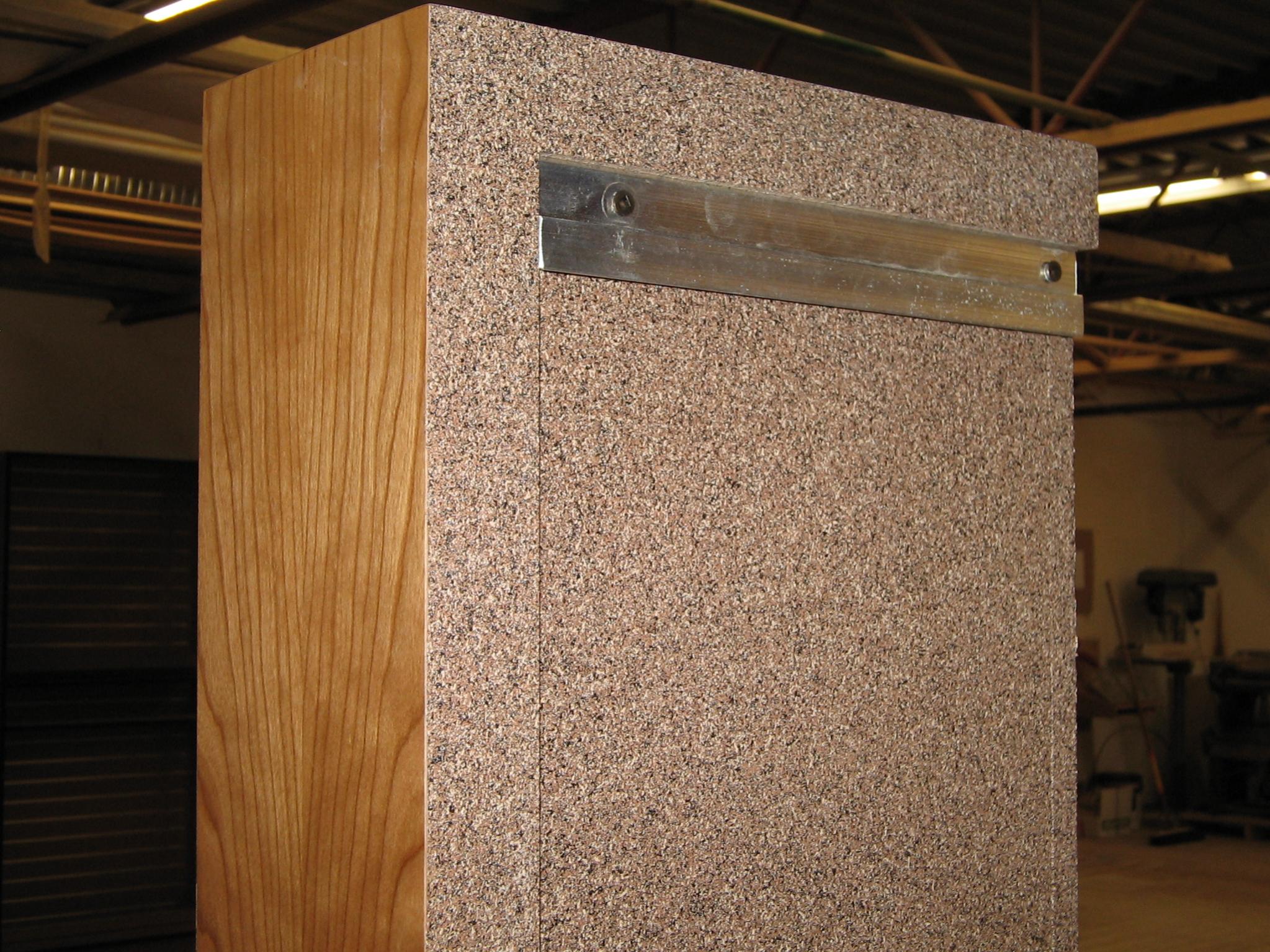

Part of the design brief for the build in photo was to be as shallow as possible so as to not extend past the face of wall mounted flat screen TV, so they were built with 1/2" BB plywood - more than sufficient for this application AFAIC. Including provision for wall mounting Z-clip cleats (here shown on woofer enclosures) the total depth of the front sound bar was approx 120mm.
The micro enclosure isn't all that complicated a build - the trickiest step for some folks might be the driver cutouts - rebated on the front for flush mounting and chamfered on the back for "breathing room" around the very shallow driver when using material thicker than 1/2" .
