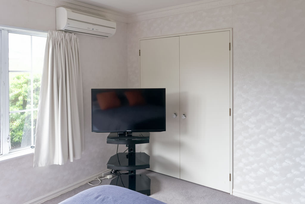

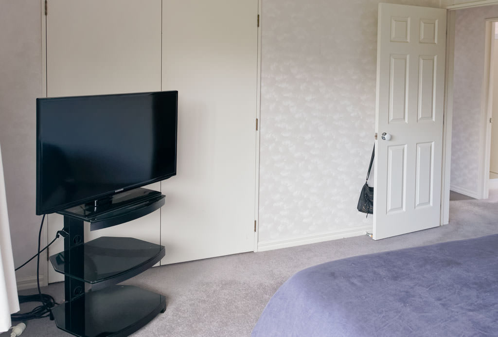

Any guidance or recommendations on the above would be greatly appreciated. I've attached a couple of pics for reference too.

Only really need to access one cupboard door. If I go with a larger TV and bigger speakers I had thought of building a new stand with wheels underneath. Then I can just roll it forward a tad to get in and out of the cupboard.
It's not a very audio friendly room unfortunately.

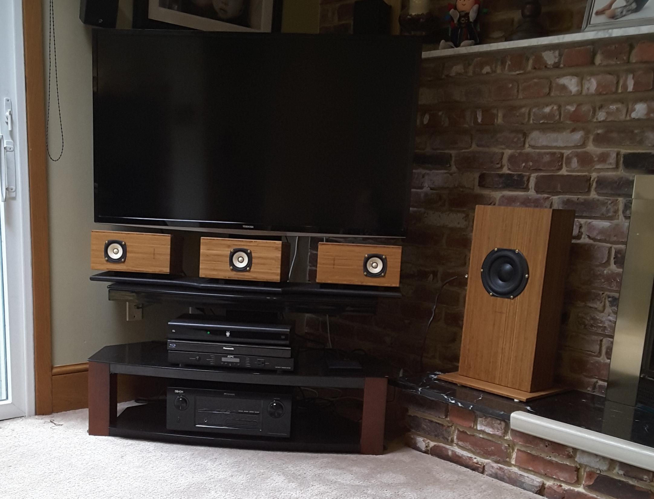

Built this 5yrs ago for a customer - the wall mounted cabinet for front row consisted of 3 "micro" size vented enclosures incorporated with storage compartments. The dual SDX7 woofers were also built for wall mounting.

Here's what i did with my main system, which is in a non-rectangular shaped room. The front L/R/center and sub are full range from Blumenstein audio. I had to make a custom shelf for them to fit on the av stand. I also out some wedges underneath them so the point at the correct height while seated.
After the audysey auto room correction, i tweaked it for better dialogue.

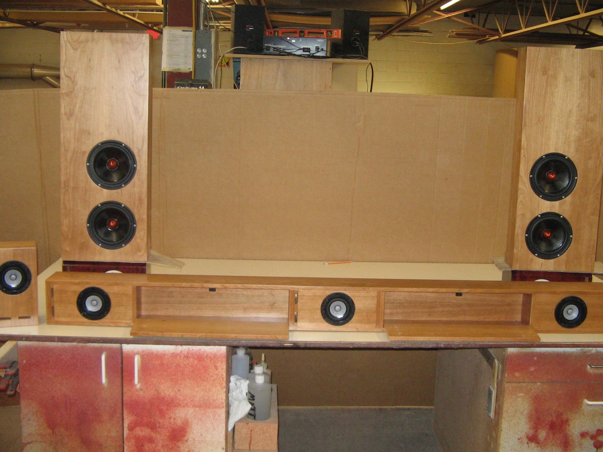

More pictures:
A6.2PeN in the 4.7 litre milliSize mMar-Ken6p
These are the rears that went with the soundbar Chris posted:
I don't have a picture of the uFonkenWK handy but it differs from the older uFonken only in the width of the vent spacer:
The upmarket uFonkenSET with FF85wKeN (in solid black walnut here/Chris' computer speakers):
dave
