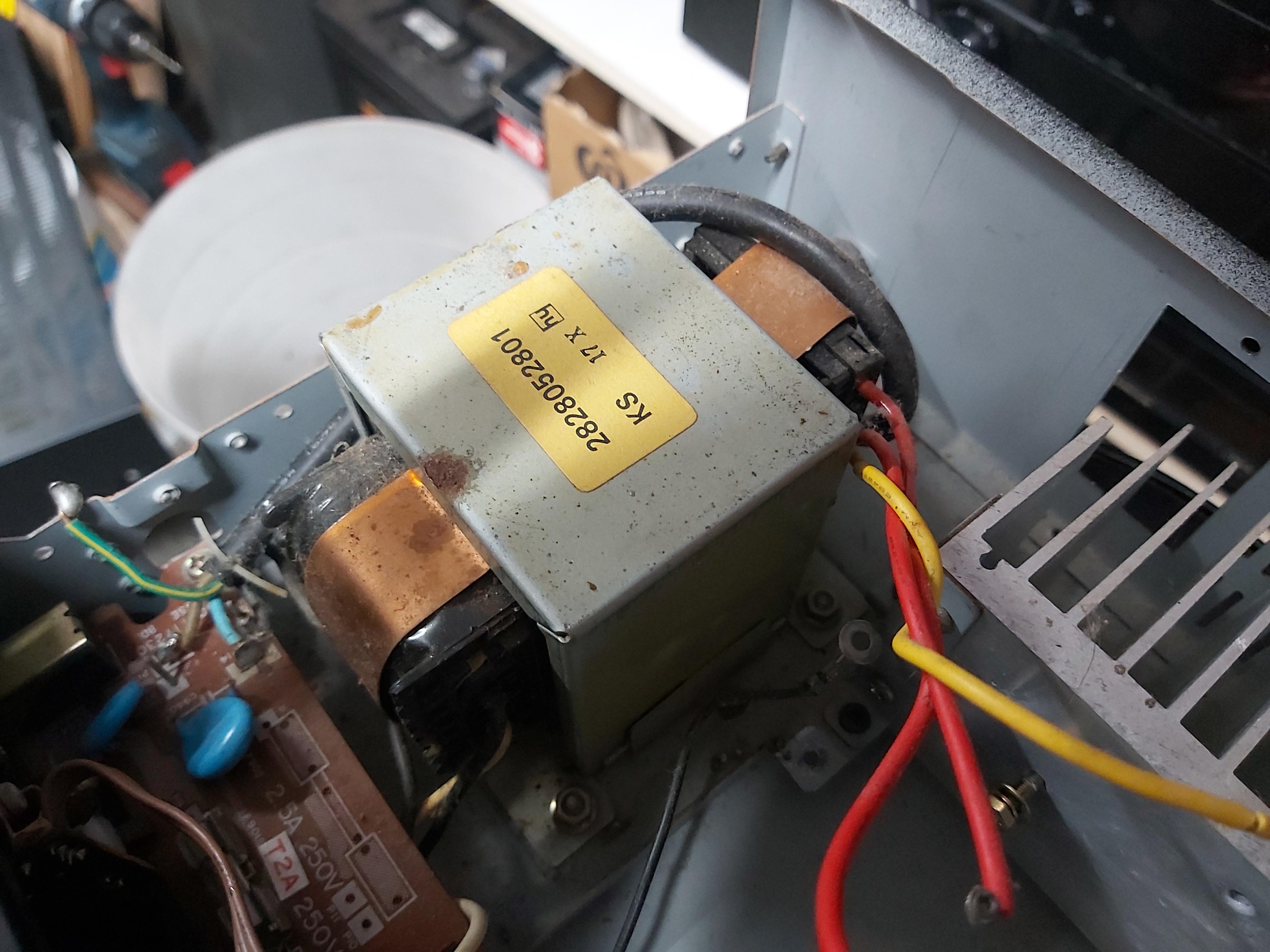

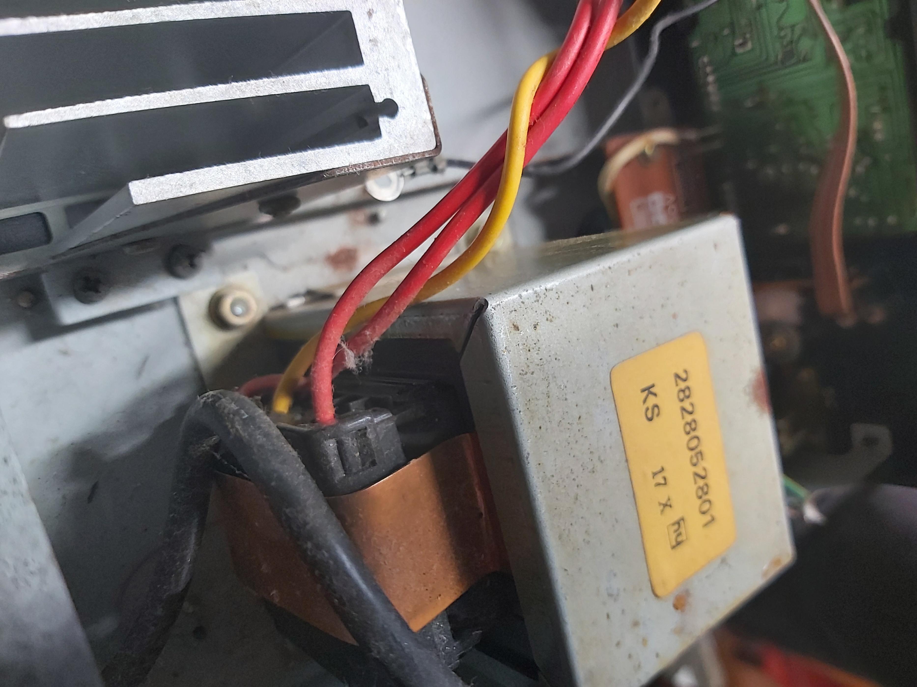

The transformer is 32-0-32VAC (measured unloaded), so I was thinking of having separate boards for each channel.

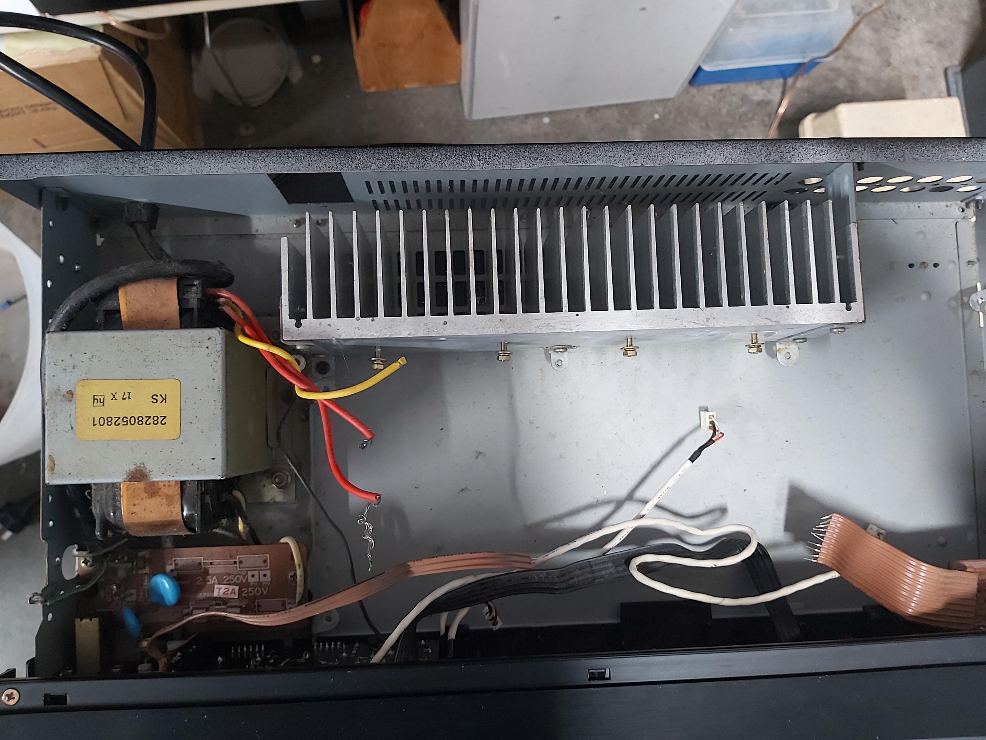

The donor amp was a Sherwood AI-1110. I will take a couple of photos after work tonight showing the inside. The transformer does not have any specs shown on it and I can’t find any details online either from the manufacturer or the numbers written on it. Just has a sticker on the back of the chassis saying 230W. It was a surround sound amp with 50W RMS per main channel. It is has a decent internal heatsink and well ventilated chassis but now am thinking that even with fans the heatsink may not be enough given the high input voltage. If so I could modify the chassis to have large external heatsinks on the side.

If necessary i will. My original question was is this necessary? Not very environmentally friendly or economical to throw a perfectly good transformer in the bin. I find that sad. Just because it puts out 32v does not make it crap. It looks like a well made transformer built for use in audio. I beleive it may perform better than the cheap generic toroidals that many people use.
You can measure the resistance of the secondary winding of the transformer with a multimeter.
You can load the secondary winding with a resistance of 30 ohms 150 watts (heater or electric kettle). See how the transformer feels - a voltage drop, heating, fire.
Sherwood has a weak transformer and heatsink made of thin aluminum tape.

I think people here try to help you save money in the way to invest on something they see from start that it don't work out. I took a look a the Sherwood Integrated amp.
Try to address that CLASS A for you a bit. In CLASS AB mode transformer delivers the power according to how much the user turns up the VOLUME CONTROL. Bias will be at max 100 / 200 Milliamp MAX, and this is already high. So that Transformer of the Sherwood will fit.
Now Class a is not that way. CLASS A draws from beginning when the POWER SWITCH is ON the full POWER . So that transformer of you will not be able to deliver that Power constantly, because the A cirquit does not CARE about your Volume Control how much it is open unless it's open all the way..Then and only then the AMP will be able to deliver its power without excessive heat or say less heat.
Now, to use a LM317 is not a bad Idea but it's max output is only 2 amps if I read the Manual correct. It wont last longer than 30 minutes and then you will need to exchange that regulator. If you with CLASS A try to get 10 Watts out of that Amplifier then you must input about 4 times the power you like to get at the output. I'm talking about the efficiency of 25% of the class a. which is already very high if you can achieve that. I do not know this JLH amplifier. But I know that for 10 Watts output you will need at least a 350VAC transformer for 1 Channel to be on the safe side. Not only the output gets hot, the draw of the Current for BIAS will also load the PSU, and this the Transformer.
I'm sure that transformer will a run a CLass AB just fine, but not a Class A.. May a 5 Watt and I think as soon you will connect that Class A even if its only 5 Watts the output voltage of at the end of the PSU will drop by 10 - 15volts without even have sound on the AMP.

The Case of that Sherwood, if also just for 10 Watts is far too small to handle two channels. About the Fans, OK you can do that but when listening on little volume but the fans are turning on highspeed because otherwise the cooling is not enough, exactly then you will sure try to find another way to have that cooled down to a normal Range.. Normal range for CLASS A without FAN is 80Degrees -100 Degrees Celcious and not 40 - 50. With 50 you already will find it HOT.
I do not say, do not build that, I just say before you build it with that in mind what you have, make sure that you don't waste time and money. Buy a suitable transformer and the Sherwood Tranformer and Case you can use to a later day when you build the Line drive which will not take that much current and size. Looking from that aspect to your Project, it's all a Win Win situation.. you can re-use that Sherwood AI-1100 and also invest a little money to get that Class A build.
