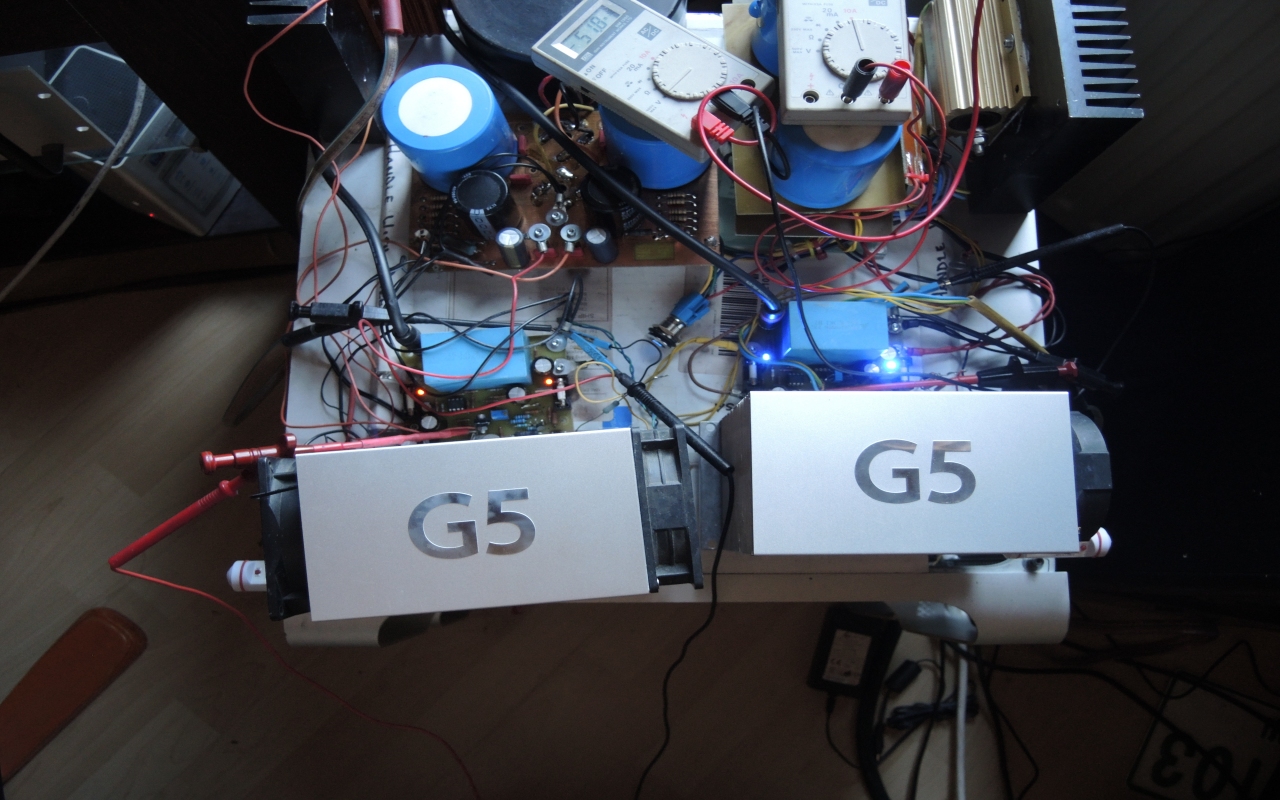

Efficiency Class A - Single End
Theoretical maximum efficiency of a class A amp is 25%, one might say 30W can be reached.
You will be happy if you get 20% with a Push Pull
My daily life last few Decades is constructing Class A Amps, besides working..
My Single End gives me 17% with
Rail +-42 and
RE7.5Ohm = 5.,6 AMPS
Vout RMS is "14Volts",
Exactly 13.885RMS @8Ohm Distortion 0.0245%@ 1Khz
0.564% 100Khz and
0.0306% @20Khz
I would like to get 15Volts RMS,
And I get15.245Volts 0.776% @ 1Khz
But it clips before that at 100Khz.
Distortion 1.004%@100Khz
So I use the Lowest level under 1 % with 100Khz which can be achieved. =13.885RMS for my measurements
Clipping level is 13.885 @8 Ohm..
I do not use a Tornado to cool the heat off, but a dedicated fan control and MAC G5 Active Cooling sinks.
Anyway Case is almost ready- soon the AMP will find it's way into the case
