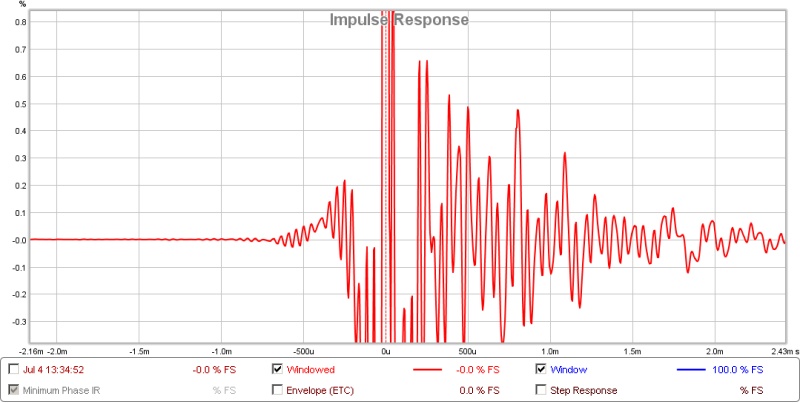

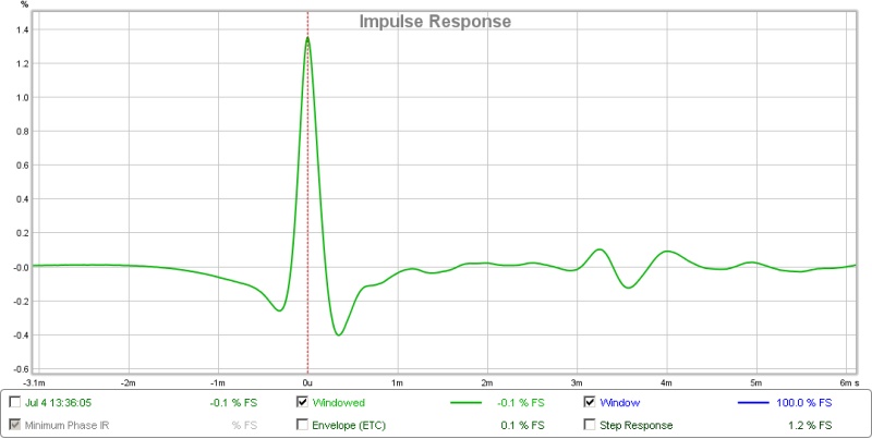

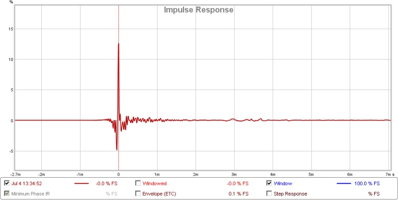

Here it is.
I think i see some ringing in the tweeter impulse response with its 2KHz LR4 HP filter enabled.
Please comment.
The pre-ringing at the sampling frequency is at a frequency that will be inaudible (if I have understood the scales correctly). It is pre-ringing around the crossover frequency that would cause problems because it will be audible given the tweeter and midranges outputs cannot cancel everywhere (assuming that cancelling is what the filtering is seeking). There seems to be only about one period of this which I doubt will be an issue.Here it is.
Please comment.
So that leaves the movement at 0.5 seconds before the impulse. If it is real then you will hear it as a quieter pre-echo if you play a short transient sound like a click. It may be clearer if you listen close to the tweeter or midrange or well off-axis given it might be arranged for the tweeter and midrange sound to cancel on axis. If you can hear the pre-echo then this will be audibly degrading music and we will need to find the cause and fix it.
Andy can you clarify what points to movement 0.5 seconds before impulse? The ringing appears to be IN -1.0 ms range.
The pre-ringing in post 447 does not look a problem. The pre-echo in post 429 is a problem if it is real (not an artifact of the measurements or whatever that plot is). The simplest way to check if it is real is to play a click, a very short transient sound, and have a listen for a quiet pre-echo of it. If you hear that pre-echo then that is very likely the source of the loss of clarity you have been reporting. It should be straightforward to find the cause and fix it.Andy can you clarify what points to movement 0.5 seconds before impulse? The ringing appears to be IN -1.0 ms range.
Any impulsive sound that lasts only a short time is fine. It doesn't matter what it sounds like because the OP is only listening for a quiet echo of something related to it before it arrives.Where can I find a click to play and how do I know how it should sound like?
When I was messing about with acoustic cameras a few years ago we used a small plastic clicker during setup. It was probably one for dog training and cost a couple of Euros. An alternative might be to use some software to generate a small file with an impulse.
Per the REW/Help/Impulse information found Here, that first leading spike in the Impulse chart (when in the dBFS mode) is a result of the 2nd harmonic distortion. The more friendly way to see and interpret this with the distortion chart where we can see the second harmonic distortion plotted by frequency. All speaker measurements will show some level of peaks in this view of the Impulse chart when in the dBFS mode. The help within REW also covers this and there it is presented in a slightly different way.
Thanks that is helpful. That would make the pre-echo an artifact of the measurements/plotting and so it should not be in the FIR coefficients or be audible as a pre-echo. Still hunting for what is causing the lack of clarity and, possibly related, the higher than expected level of measured distortion in the tweeter.Per the REW/Help/Impulse information found Here, that first leading spike in the Impulse chart (when in the dBFS mode) is a result of the 2nd harmonic distortion.
