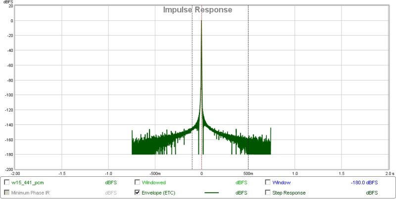

Can you please show us the impulse response of the FIR filters you are using on the mid and tweeter. The reason I have been asking is to rule out significant amounts of preringing which will not be apparent in the frequency responses but can be audible if present in large amounts. Preringing means the tweeter and midrange start moving in opposite directions before the signal arrives. Mathematically on-axis they should cancel but off-axis they won't and even on-axis one or two real world considerations can intrude. It doesn't matter in small quantities and is fixable in large quantities but a check is probably worthwhile.

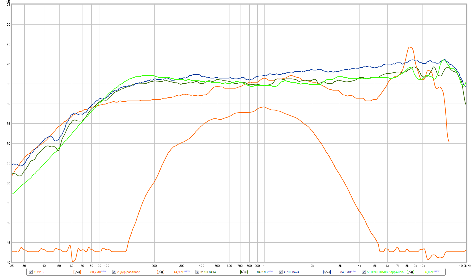

Just a thought, if you like to hear how your speaker sounds with mid/tweeter XO point upped to area 3-7kHz Madisound and PartsExpress have Tymphany TC9FD18-08 at only $13. Orange in below plot show W15 and present pass-band from post 407, blue is 10F/8424, green 10F/8414, and lime is TC9FD. Three of them is traced from manufactures datasheet and TC9FD is traced from Zapp's blog.

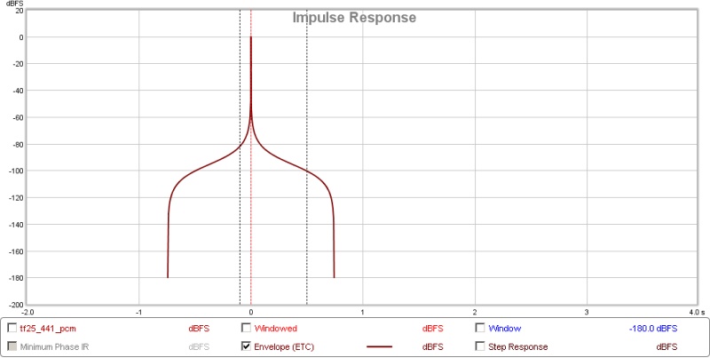

I will post the impulse response of the mid/tweeter filters.

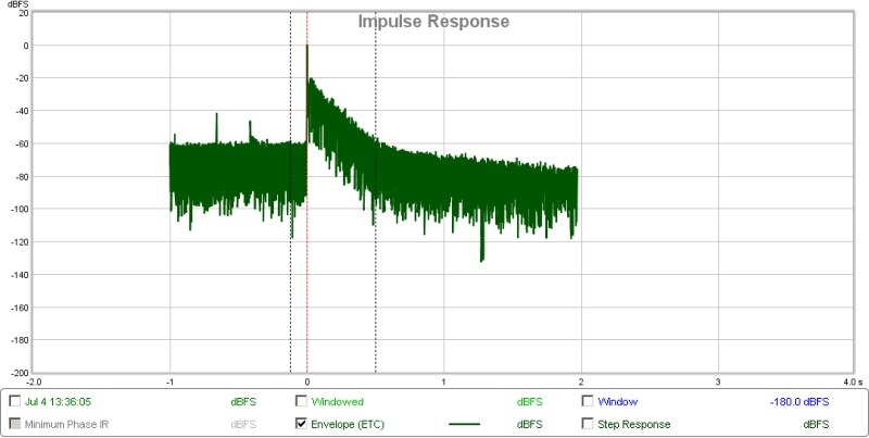

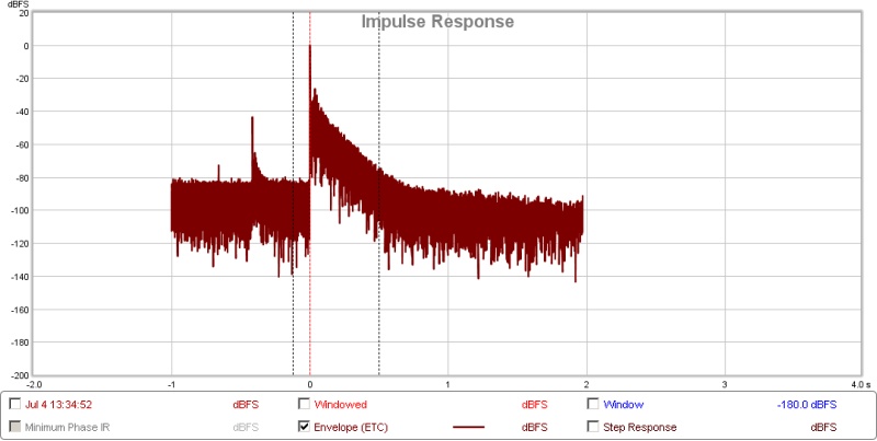

What is that a plot of? Would like to see a conventional impulse response windowed to show the degree of motion before the impulse arrives. However, the plot does suggest motion a long time before the impulse arrives which is not good. The motion might be low in level (is it?) but any coefficient calculating algorithm that creates motion a long time before the impulse arrives is a concern.IR of Mid and tweeter driver measurements with filters.
These are from a full range sweep measurement of the loudspeaker using REW.
All channels except the tweeter or mid is muted. REW can then display the impulse response from the test.
Are the smaller pulses before the impulse at 0 what you are referring to as early motion?

An impulse response shows the response of the driver to an impulse as an input. It is plot of pressure vs time and typically shows a spike with some wiggles with both positive and negative values. Your plot appears to have a log y axis (cannot log negative values), no values at minus infinity, grass before the impulse with a range of roughly -100 to -60 but after the impulse the maximum value of the grass falls below -60. It seems to be related to an impulse response but I don't know how and when checking for mistakes it is important to know precisely what you are looking at.These are from a full range sweep measurement of the loudspeaker using REW.
Are you able to plot the actual impulse response in a window showing the height of the pulse and for a time range covering 10-20 time periods of the crossover frequency before the impulse and after. What we are looking for is significant motion before the impulse that would turn the sound of a click into more of a chirp which might well line up with a loss of clarity you are reporting hearing. Wiggles at the sampling frequency are less important.
The bumps out of the grass half a second before the impulse are suggestive of something being broken. A driver that is reacting to a sound half a second before it occurs is obviously wrong. But we don't really know what we are looking at because it is not the raw data (e.g. the coefficients) but a processed measurement of some kind. It might be an artifact of that measurement processing. It looks wrong and significantly so making further investigation worthwhile to find the cause and fix it if it is real.

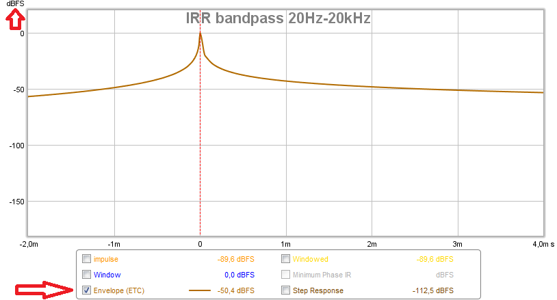

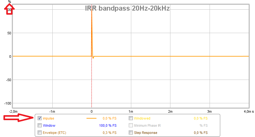

Thanks for that. I was looking for something like the one on the right if m is for msec. It will not show the problem at -0.5 sec but will hopefully show if there is a click to chirp issue.jojip plots show "Envelope (ETC)" and scale is "dB FS", guess you like them presented as "Impulse" and scale as "% FS".
Below example is how 20Hz-20kHz band-pass device looks into those two presentation settings.

My thought was only to replace W15CY with a driver that seems also can fulfill low frq corner (LR4 300Hz or higher) as seen into plot at post 423 but have break up nastiest much higher than W15CY so XO to tweeter can be tested higher in frq as talked about. Pointed to TC9FD because of its fantastic low cost and if relieved by a tweeter in 3-7kHz area think it will perform as fine as much more expensive 10F/8424, also member Barleywater show very impressive data with TC9FD (in a Lxmini build) here in diyA domain, and thought for mounting was same enclosure as W15CY and make adaptor with outer diameter as W15CY and mount TC9 inside this adaptor and if possible maybe offset it little bit downward closer to tweeter.
