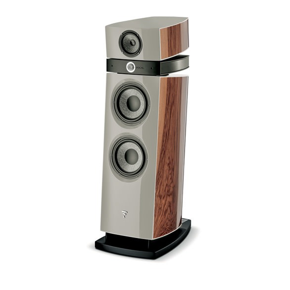

Further, I would have your treble device (be it a horn + compression driver or Great HEIL) on it's own stand free of the baffle for the midbass drivers. This is because the midbass drivers will produce a LOT of vibration and you don't want that transmitted to any treble driver. So at a bare minimum each speaker would be two baffles but they could be "stacked" (placed next to each other vertically) to achieve a similar profile to what you already have. You could also alter their vertical orientation to better suit your listening position - perhaps like Focal's more expensive loudspeakers.
ex. imagine the tweeter module stack removed and the upper midrange is where the treble driver is located:
