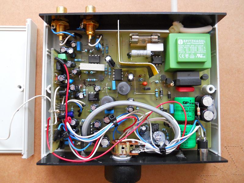

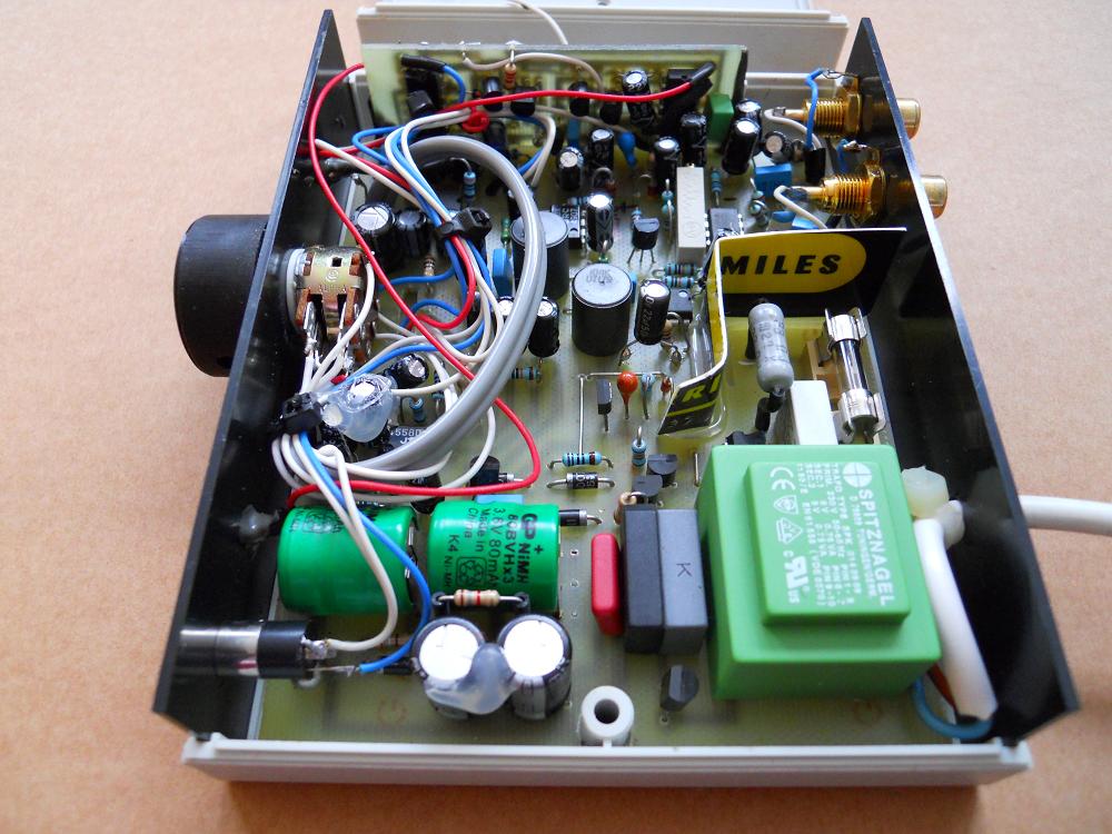

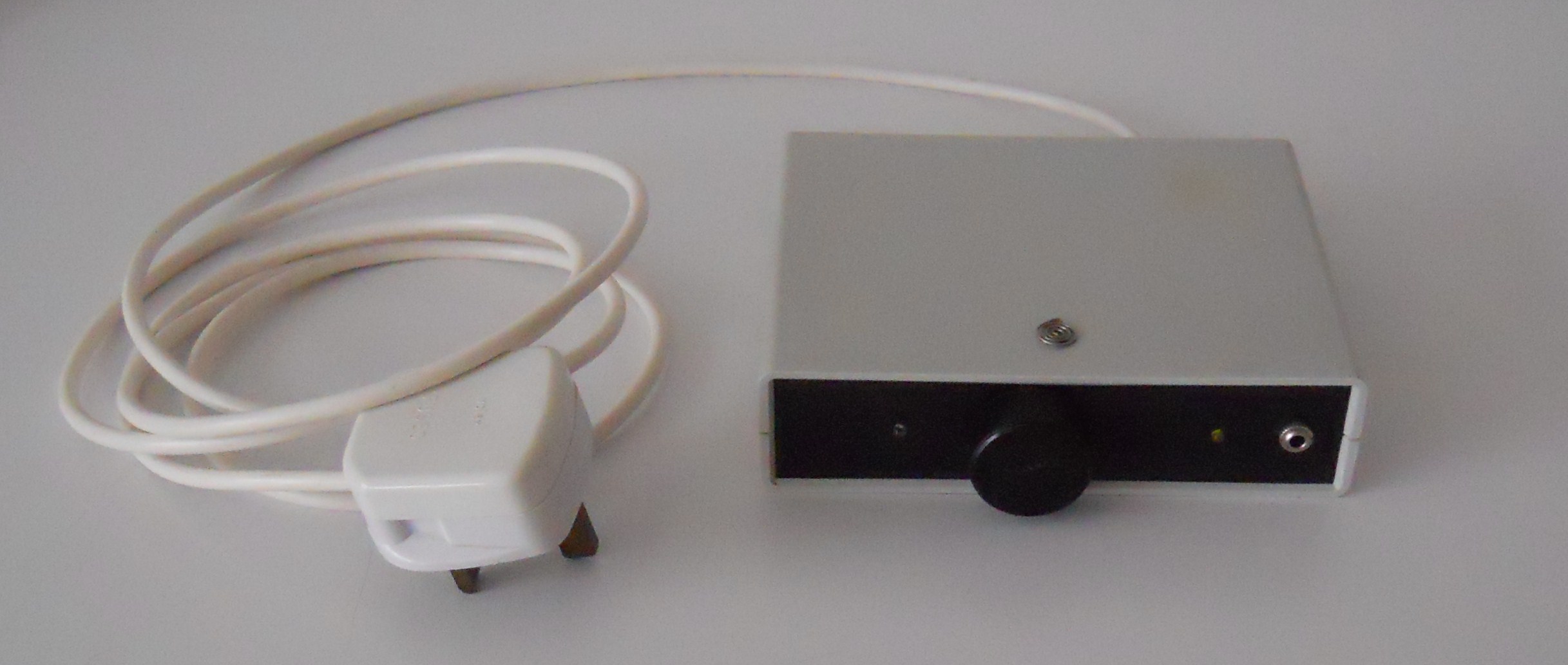

Well here is the beastie.
I used the circuit as part of a headphone amp which ended up quite complex. Audio is detected by an ultra low power opamp detector and resetable timer that triggers an opto coupled triac to switch the mains to power the device. All that is fed from a nicad cell. When mains appears that takes over via diode gating and charges the cell. The "stand up" board along the edge is a "capacitive" touch switch to a pad on the top of the case to provide a mute function.

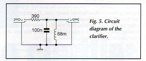

The quality of the coil is important, you want one with as low a DC resistance as possible to give the best "Q" but it's a case of try what you have and alter to suit.
Credit for the LCR circuit to John Woodgate.

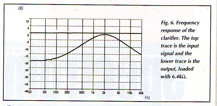

for speech intelligibility the required bandwidth is ~300Hz to 3000Hz.
It sort of reproduces a form of music but not as we know it.
If only that bandwidth is amplified and fed to the nearfield speakers and/or headphones then the drivers and amplifiers will have a much easier time coping with that narrow band audio signal.

Finally had a chance to look at that diagram.
That inductor, surely that has to be 0.68mH ?
scan isn't all that clear..
This is similar but has a dc resistance of 220 ohm. As mentioned, try what's available and alter R and C to suit.
Check your pm's too 🙂
MURATA POWER SOLUTIONS|22R686|INDUCTOR, 68MH | CPC
That's where the majority of speech resides but the most important part is in the 3K to 6 Khz range where the soft F,S, & P sounds reside. Without the ability to hear consonants well in that frequency range, you'll be lucky to understand 50% of a conversation.
