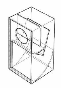

Sooo i am thinking something like these:
Back Loaded Horn Design | Parts Express Project Gallery
Oak Will indeed look sexy behind some thick polycarbonate, and not something you see everyday!

Backloaded horns will never be small i'm affraid. And that driver in the kit you mention is known to be ringing so i would not build that. There are way better designs than that one.
This is a better example, that is build and tested by many in Germany. And that site has many designs, all tested and build before (often from german diy magazines):
W8-1772-Horn
But if it has to be small, a ported or sealed box will do the job better for a smaller size than a hornloaded speaker.

They dont have to be small. But about 90cm or so. I think ;D
The design i have linked to, is only to show what i am looking for. I am after that type of design with smooth internal shapes.
Driver choice is undecided at this moment.
Smooth internal shapes with complex curves do not necessarily make for a good sounding BLH, and as Waxx points out, compact size will severely limit the low frequency performance.
Take a look at the FrugelHorns - now enumerating four sizes with the recent Jane for Alpair 12P. I built and lived with 3 of these designs with multiple makes and models of drivers during the evolution / expansion of the family, and highly recommend them. As is no secret, my most favoured FR drivers are those designed by Mark Fenlon, and for a first time full range build, I’d suggest any of the 10cm size.

Smooth internal shaps are rare in speakerland, and not important but for the asthetic side of it. You could make a backloaded horn like the one l linked with a bended thin woodplate for a smoot ending of the horn like they do a lot with scoop horn used as subwoofer on reggae and dub soundsystems
