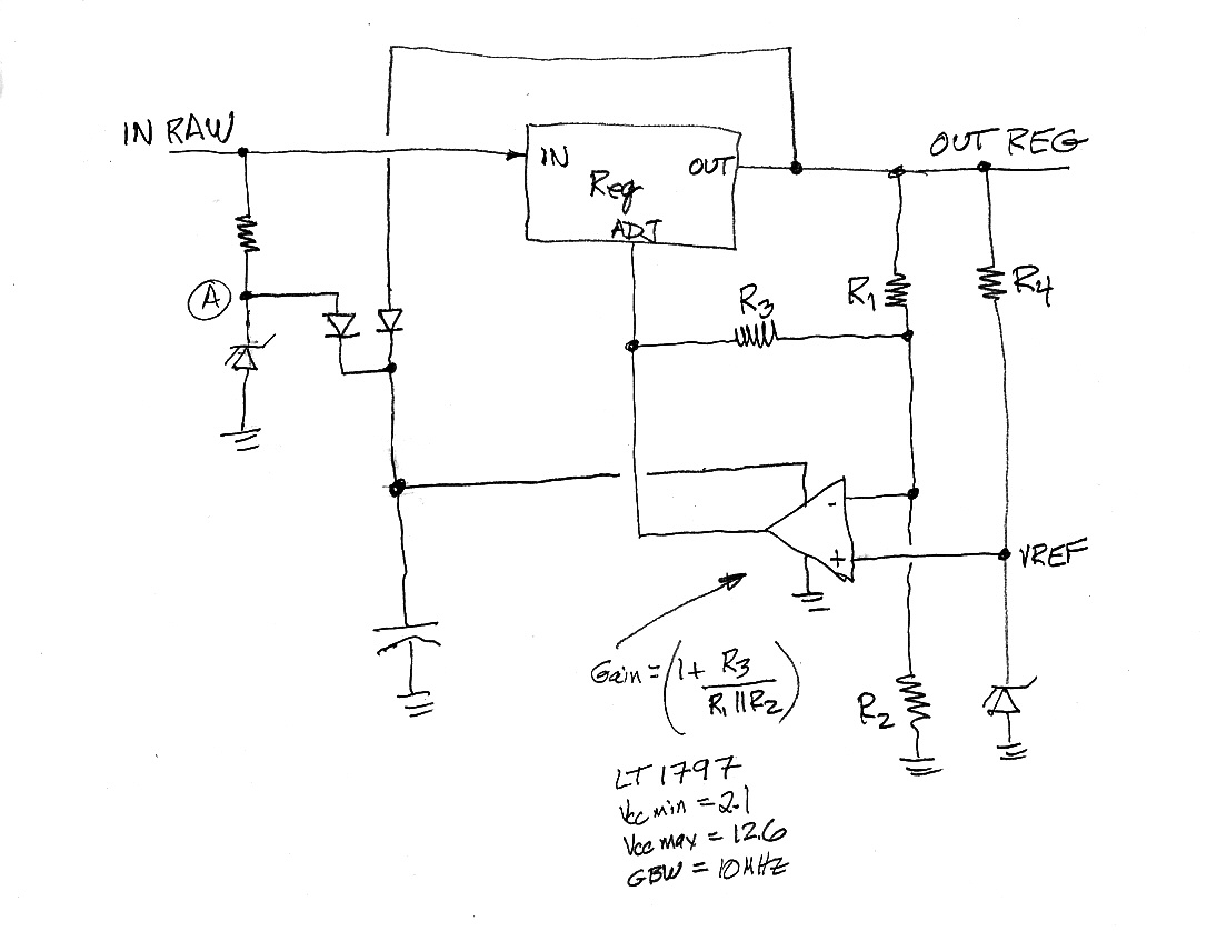

If this were my problem, and thank god it is not, I might consider something along the lines of the attached sketch, as a first possibility. The designer has the freedom to select among different amplifiers with different Gain-Bandwidth Products; one is not stuck with whatever GBW the mfr happened to put in their TL431 clone. If a Linear Technology amplifier is chosen, this increases the likelihood that the datasheet will include the openloop gain and phase; AND it increases the likelihood that the vendor-supplied SPICE model will match the datasheet quite well.
An external amplifier with external feedback resistors allows gain to be traded off against bandwidth by simply adjusting a single resistor (R3). You can dial up any phase margin you like. If the opamp GBW is much much greater than the IC voltage regulator's GBW, the opamp contributes very little "excess phase" to the cascade-of-amplifiers, and so it has only a small effect upon stability margins. LT sells some nice little opamps that work from 2V to 12V and have GBW in the neighborhood of 10 MHz. (So do other makers, of course; but now you're back in the should-I-trust-this-SPICE-model conundrum.)
Most of the extra components are squandered on the purifier circuit at far left. Node "A" is a DC voltage comfortably above the opamp's minimum supply requirement, and also comfortably below the regulator's output voltage. For a 12V regulator I'd set VA= 8volts, and for a 3.3V regulator I'd set VA= 2.7volts. At startup, the opamp's power supply pin is fed from node "A"; once the regulator wakes up and starts regulating, the second diode begins to conduct and the error amplifier is powered from the regulator output.
So...
- use something like an LM329 or LM4040-2.5 to set Vref for the op amp (I need to check fit for either to fit the same board)
- set R4 to provide enough current for the zener to operate properly
- Vout = Vref x (R1+R2)/R2 (as before)

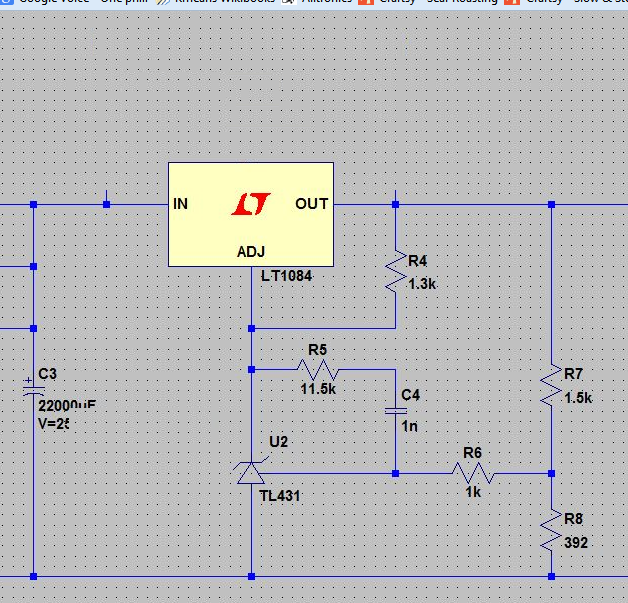

Isn't this just a step or two from a discrete version of a TL431/SPX431 etc? I wonder what the advantages/disadvantages might be of going further. I was also trying to relate this construction to the Jung/Didden super-regulator and the Fidelity Audio description of their regulator (I own one in 12V - at times it would seem awfully efficient to buy a 5V and 3.3V and move on but that wouldn't teach me much). Here the op amp is 'driving' the adjust pin of the LT1084 whereas in those circuits the op amp drives a pass BJT or power MosFET. It would be good to understand these better.
After a good deal of reading I think I now have a better grasp of series pass transistor regulators, although I am a long way from understanding the intricacies of the Jung/Didden super regulator.
How does one determine the GBW of the LT1084? I ask because if I model with the low noise LT1677 op amp (GBW 7.2MHz) which we used in our earlier measurement circuit discussions in lieu of the LT1797 (10MHz) things oscillate at gain settings which are fine for the LT1797.
(I still haven't gotten to the bottom of the load constraints issue but will try to find some time to look at it further today.)

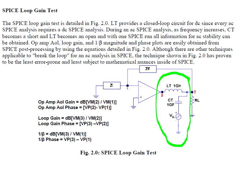

When I have been looking at stability I have been breaking the feedback loop, injecting a small signal AC voltage source and measuring -Vout/Vx where Vx is voltage on the other side of the injected AC voltage source; this I understand to be Loop Gain. I then look at phase margin Loop Gain is unity (zero dB). I ask because at no point are the plots flat like the ones you (and Jack) presented.

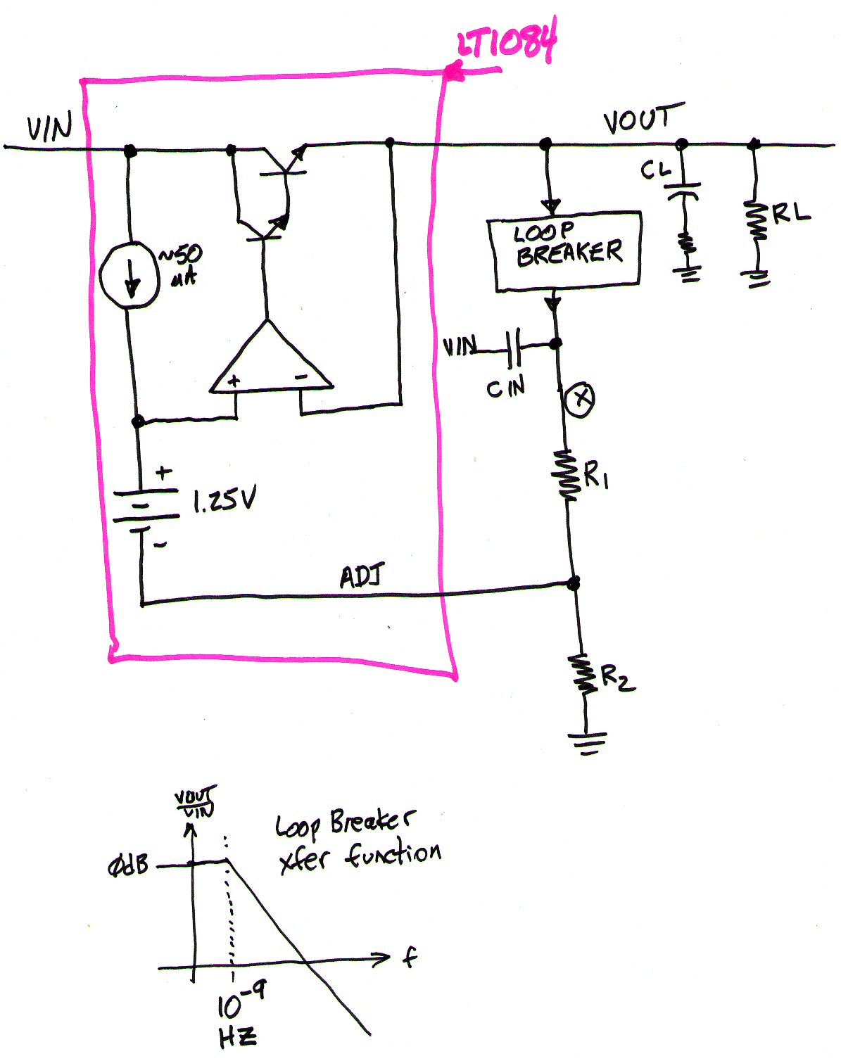

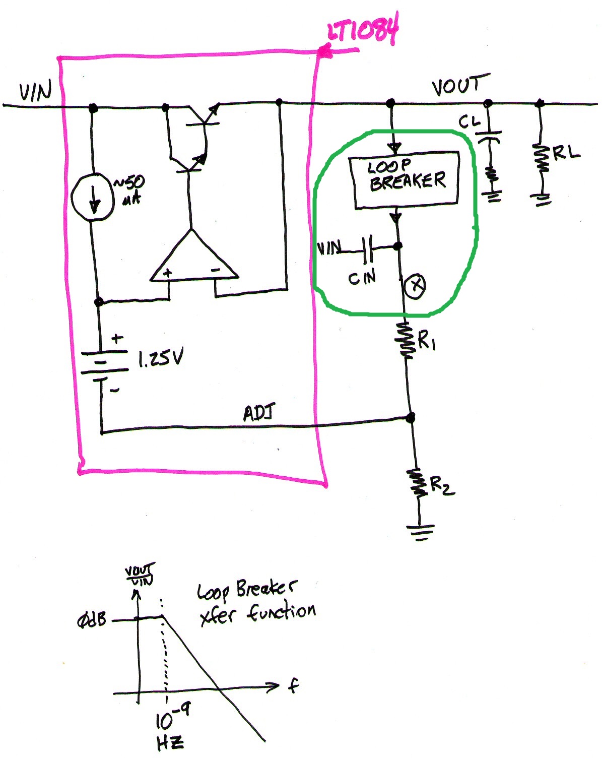

A common mistake people often make, is to forget that the loop breaker must close the feedback loop at DC*, while at the same time opening the feedback loop at all conceivable input signal frequencies. I personally like to have oodles of safety margin, so for audio work I choose to position the loop breaker pole at or below 1/(100 x OpenLoopGain) Hertz. Don't ask me what dark moist place I pulled that from. It's super-conservative, that's all.
In this case I'm guessing the OpenLoopGain is less than or equal to 140dB (1 x 10^7) so a comfortable choice of loop breaker pole location is ten to the minus nine Hertz.
In the attached diagram, the AC input signal is applied through Cin and the open loop transfer function is V(vout)/V(x). If you set the magnitude of the AC input signal to be 1.0 unit of sinusoidal wiggle, the denominator of the transfer function becomes 1, meaning you don't need to perform the division, meaning the transfer function is now V(vout). Fewer keystrokes to get wrong.
(*) to converge the simulator at the correct DC operating point
edit- don't forget that the output voltage setting influences the open loop gain (through R1 and R2). it appears to me that the worst case will be Vout = 1.25V, i.e., R1 = zero. but of course the entire purpose of simulation is to correct faulty human intuition. in other words, don't trust my intuition. do your own work.

Breaking the loop as I depicted in LTspice still generates the same operating point as the unbroken circuit.
If I sever the circuit where you have marked Loop Breaker and then pass an AC amplitude of 1 signal (add new voltage source, -ve to ground, +ve to the cap, small signal amplitude = 1) via a tiny capacitor I don't get the correct operating point and V(vout) is garbage. I'm clearly doing something wrong here.
Maybe it is merely a function of the circuit I have been looking at that its AolB declines (immediately) with frequency whereas the Jung/Didden circuit maintains AolB flat for a considerable period?

How are you generating these (bode?) plots?
Okay, so these are plots of Open Loop Gain vs frequency; Open Loop Gain derived as Vout/Vnfb where Vnfb is the voltage at the inverting -Vin of the op amp.
For my stability analysis I have been plotting Loop Gain or AolB; derived from Vout/Vx where Vx is directly after the injected AC signal and if the AC signal conveniently has an amplitude of 1 then AolB is Vout. I've then been checking phase margin at the frequency at which loop gain is 1, 0dB (with the stability criteria being phase < absolute 180 degrees and a margin from that of at least 45 degrees).
Correct?
If the above is correct then the plots make more sense although the concept of phase does my head in. I get the concept that if x "causes negative feedback to become positive feedback at some frequencies, instability can result" but expressing it in detailed terms of phase becomes as confusing as all hell.
A common mistake people often make, is to forget that the loop breaker must close the feedback loop at DC*.....

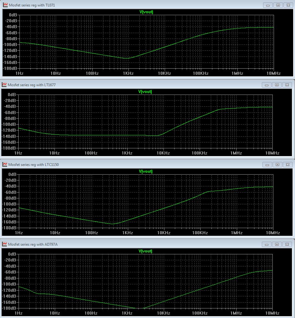

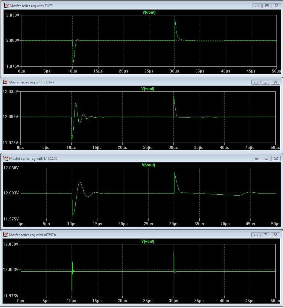

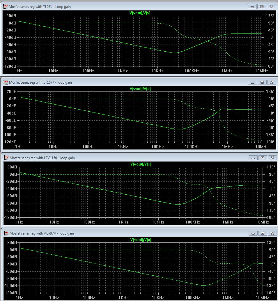

Picking up from the discussion in the super regulator thread, with Mark's kind tutoring I have been looking at Mosfet series pass regulators as I simply could not get comfortable with the stability of the foregoing reg circuits. The basic circuit is presented in the attached graphic. I have modeled four different op amps: TL071, LT1677, LTC1150 and AD797. I also went through a number of Mosfets for the pass transistor. The first 3 op amp scenarios use the same Mosfet while the AD797 seemed better coupled with another.
Presented in the attached graphics (hopefully the screen grabs are legible enough for discussion purposes) are three analyses (1) noise rejection, (2) transient response and (3) loop gain AolB and phase margin.
The noise rejection charts speak for themselves. From not at all bad performance from the TL071 to almost otherworldly (too good to be true?) performance from the AD797. But what about stability?
The phase margin charts suggest 90 degrees of phase margin at the AolB=1 (0dB) frequency and at least 30dB of gain margin when phase hits -180 degrees. Hopefully these tests are valid. How to evaluate the transient responses? The test kicked the load from 0.25A to 5A and back again. While the TL071 seems well-damped, the AD797 settles to the right new Vout considerably faster. Is it appropriate to integrate the error term and choose the one with the lowest error?
Note that the AD797 produces a different Vout from the other circuits. The analysis uses the AD797 model from LTspice's Yahoo Group files section and seems to be an earlier version from Analog Devices. If I use the AD 797A model from Analog Devices' website the error term is worse. I'm wondering about the reliability of these models.
Breakdown voltage for these circuits is high. It comes from three sources that I can see. First the drop across R2. Second, the Vgs required to deliver the load current. This can be observed in the Id versus Vgs curves in the transistor data sheet. Third, there's a limit to the extent to which each selected op amp's output can approach its supply voltage. Do I have this correct?

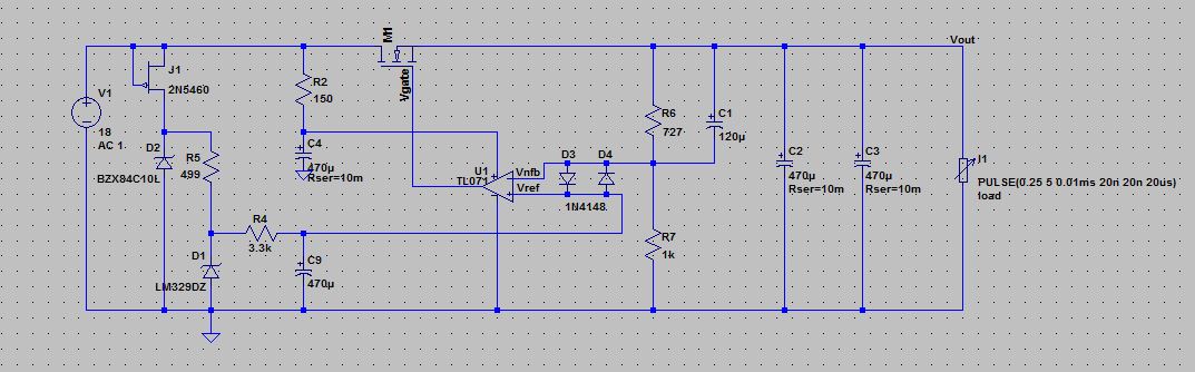

The standard trick for avoiding headroom issues because the opamp's output doesn't swing rail-to-rail, is to insert a DC level shifter between the opamp's output pin and the series pass transistor's control pin (base or gate). Almost all opamps swing their output pin within 2xVbe of their top rail, so a general rule-of-thumb that often works is to make a 4-diode-drop level shifter. Either with 4 diodes, or with a VBE multiplier, or with a zener diode, or with an assemblage of LEDs, or some other equivalent contrivance.
Be sure to heavily bypass the level shifter with a monstrous capacitor, to keep its AC impedance appropriately small. The capacitor also reduces the excess noise contributed by the level shifter. For quick simulation verification an ideal DC voltage source ( ~ 2.5 volts ) would quickly let you see what happens.
You can of course use a voltage reference IC like the TL431 to implement the level shifter, and get the benefit of its extremely low DC impedance as well. Be sure to choose a bypass capacitor at least 10X larger than the rightmost instability borderline on the datasheet. For the attached datasheet excerpt that would mean 10X 3uF. I'd use at least 100uF. Or you could just select the LM285-2.5 and whistle past the graveyard, since its datasheet displays no stability boundaries. You'd still bypass it with a huge capacitor, of course.

You've lost me there, care to explain what you're doing, where exactly is x on the sheet? (or simply post the .asc).
Hi Elvee, see post 26. It shows where the AC signal is injected and where X is.

The level shifter is (Q2 + D2). Q2 ensures that D2 gets at least 5mA of bias current, at all times, whether the regulator output is lightly loaded or heavily loaded. Q2 is sized to provide (max(Ib(Q1)) + 5.5mA) across all variations in temperature, input voltage, and component tolerances.
Notice that the level shifter's bias current must come from Vin_unregulated. Vout_regulated is too low.
