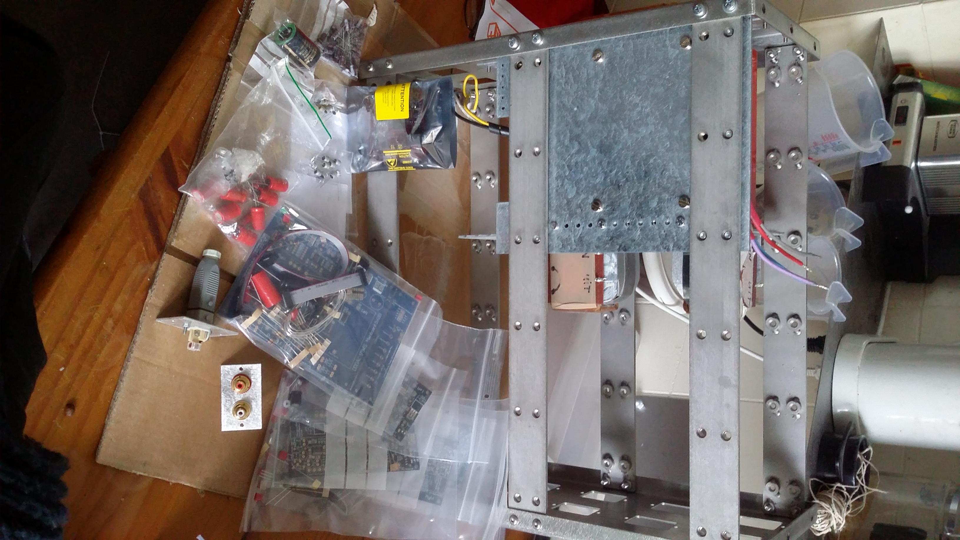

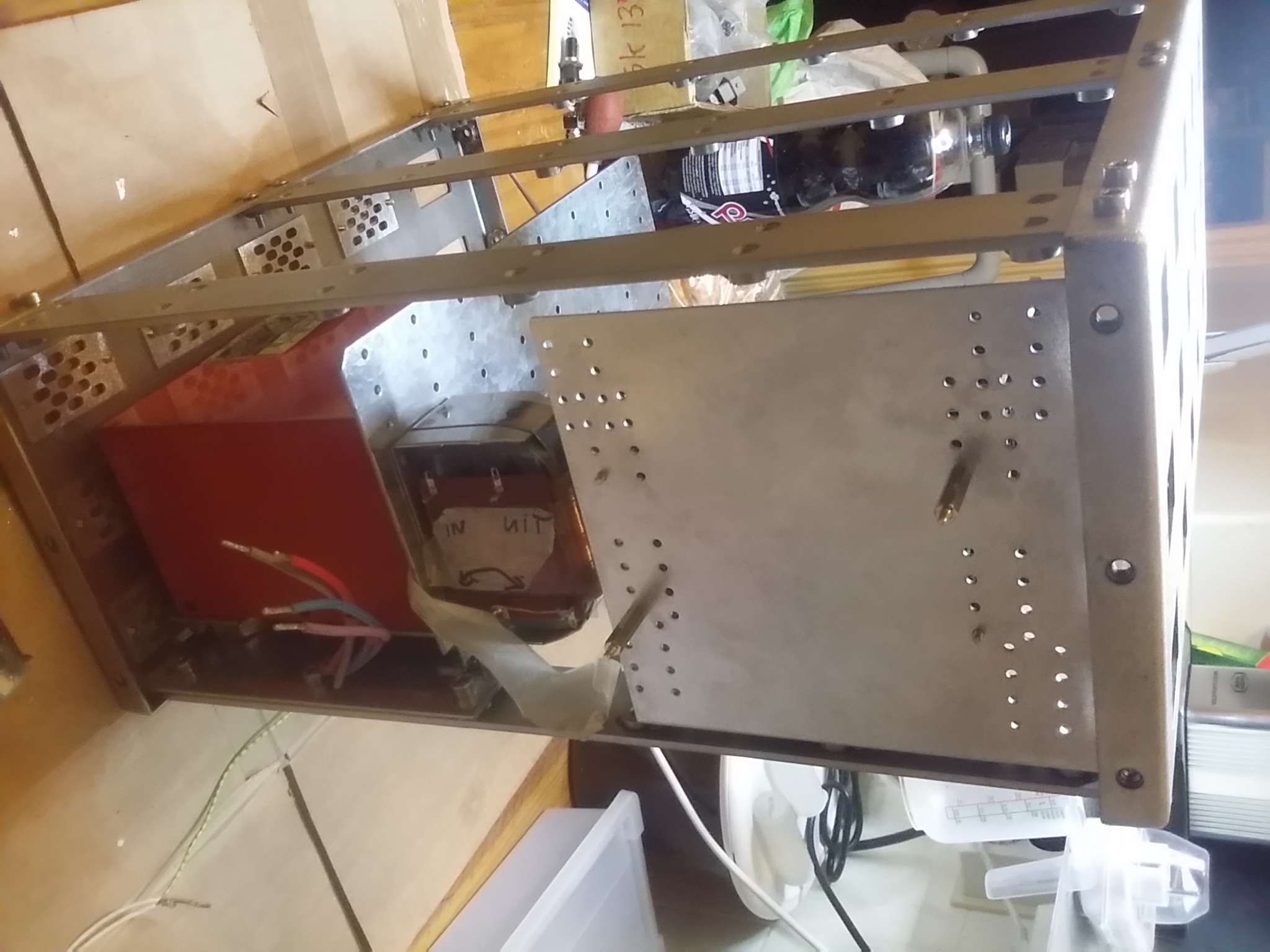

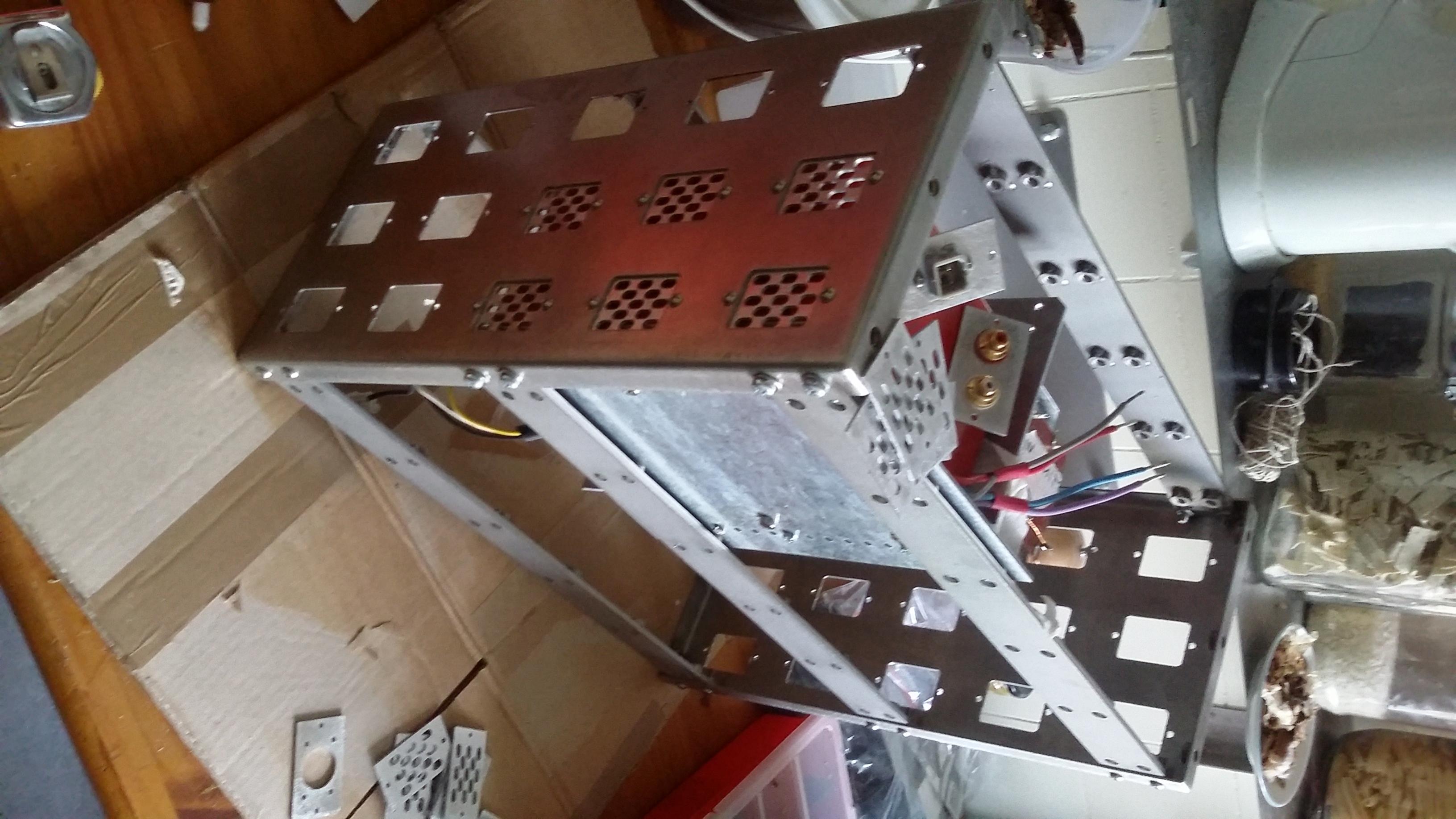

Months ago I did start with construction of the dddac mainframe. I want it to be sturdy because there is some heavy iron inside. I don't want it to twist no matter how I hold or put it after all there are circuit boards inside that don't like to be twisted.
The two sides have rectangular holes that are closed by mounting small plates with threaded holes ( so much easier to install) . When no function is needed they just serve for airflow. Other can serve for mounting cinch, bnc 75 ohm input ( my present dac uses bnc in), power connector, you name it and within a few days it can be changed. No need to start drilling in your precious dac.
Wanna make it in such a way that it can function like pictured. There will be no connections to other gear on the back side.
Have to find a way to make a nice look at the front side. Not sure if I need these led. Maybe just the input switch.
My 4 board dddac will have the boards mounted vertically to have better airflow and shorter connections.
At first will be used with cd transport. Later other boards can be added for .....things all new to me. Haven't got a clue to be honest.

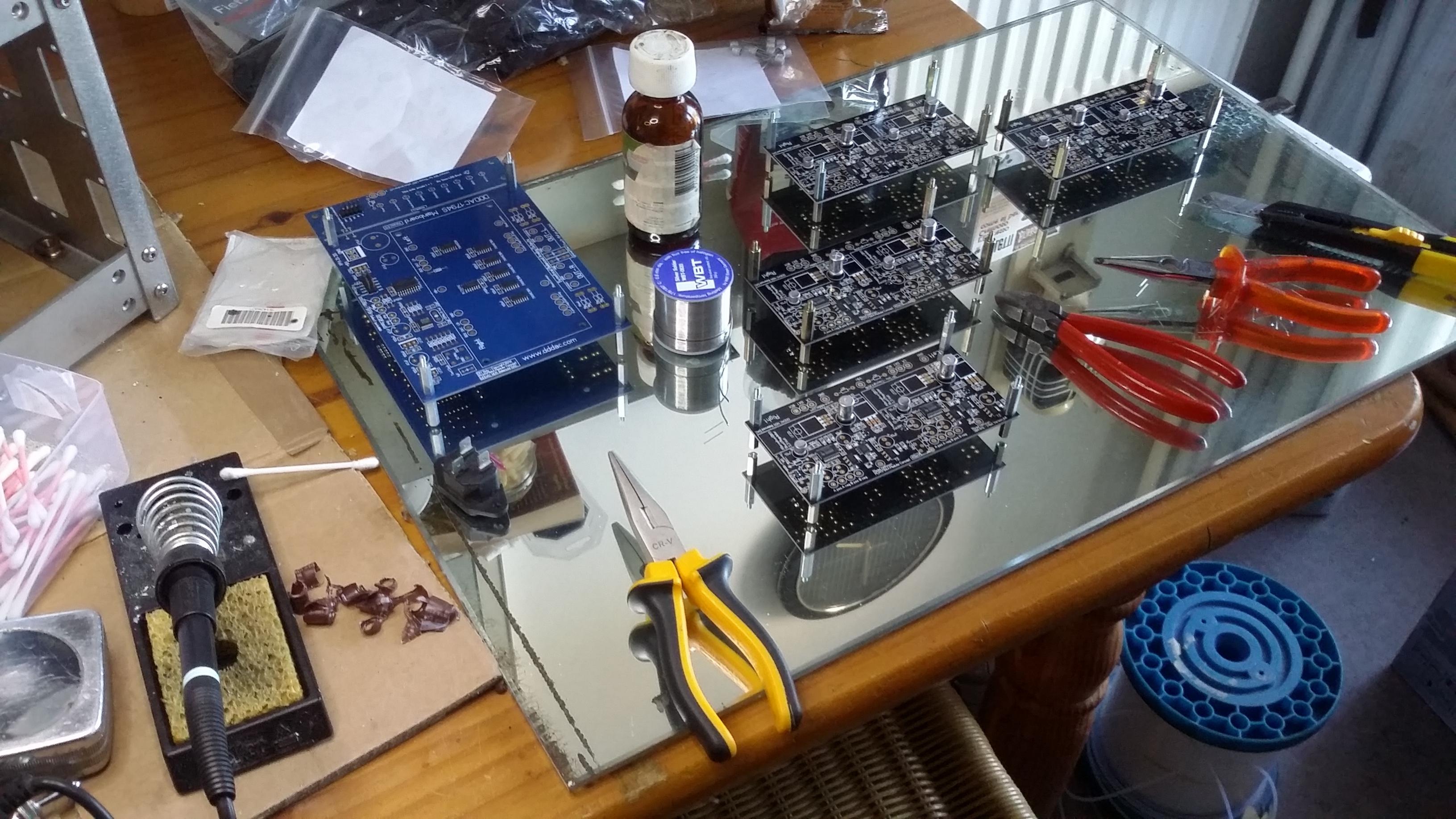

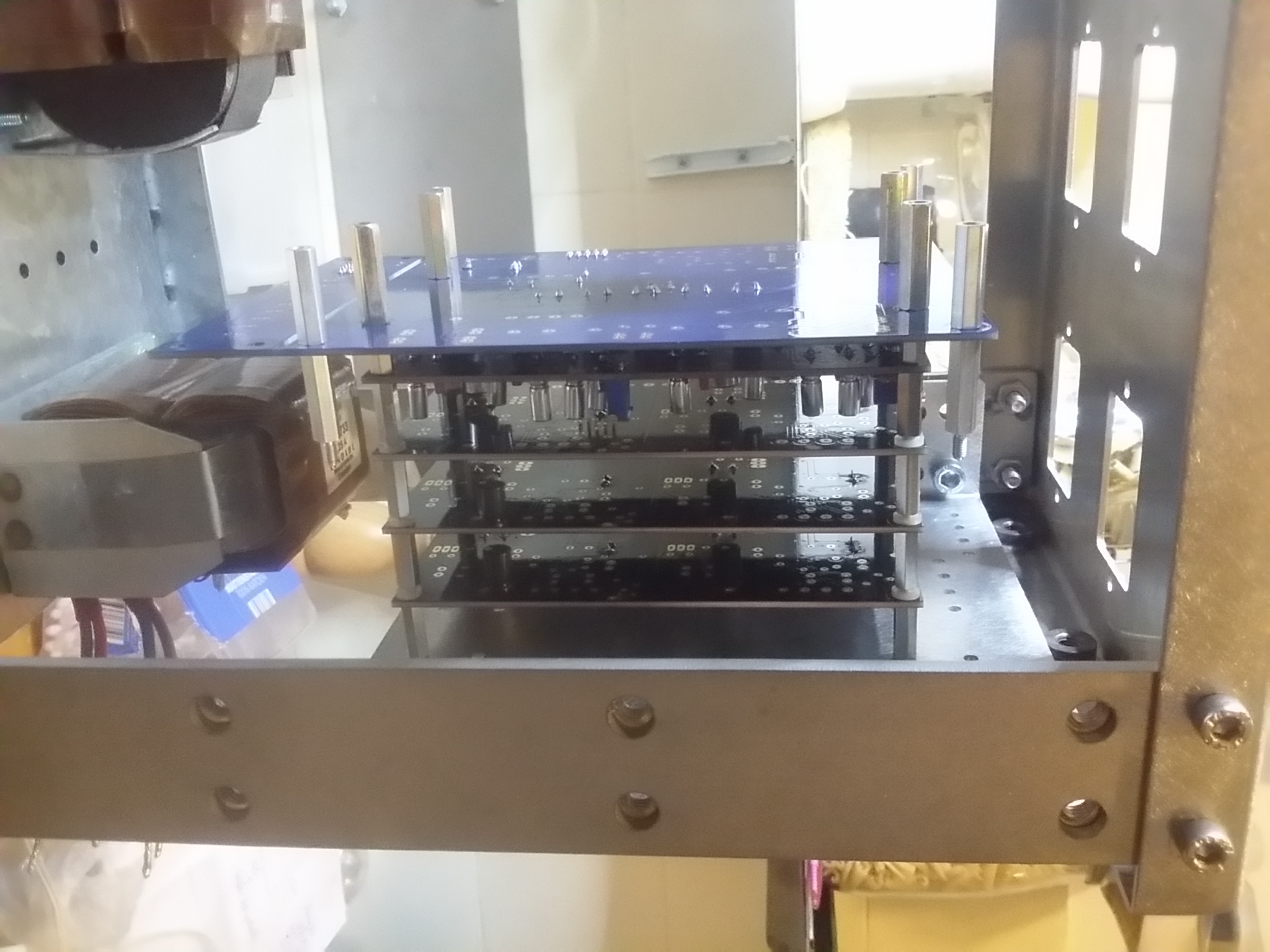

Hello,
Did so some metal work in order to mount the boards. I remember someone asking about the nylon washers included in the new updated kit.
When your soldering height is just a bit higher than average you might need the extra heigth of the washer to prevent the cut of wires touching the same cap on the board underneath.
Usually i will solder and after that cut the excess wire maybe you should cut them before soldering. Once there is solder it is rather difficult to cut the wires REALLY short.
This is tricky business.
Greetings, Eduard

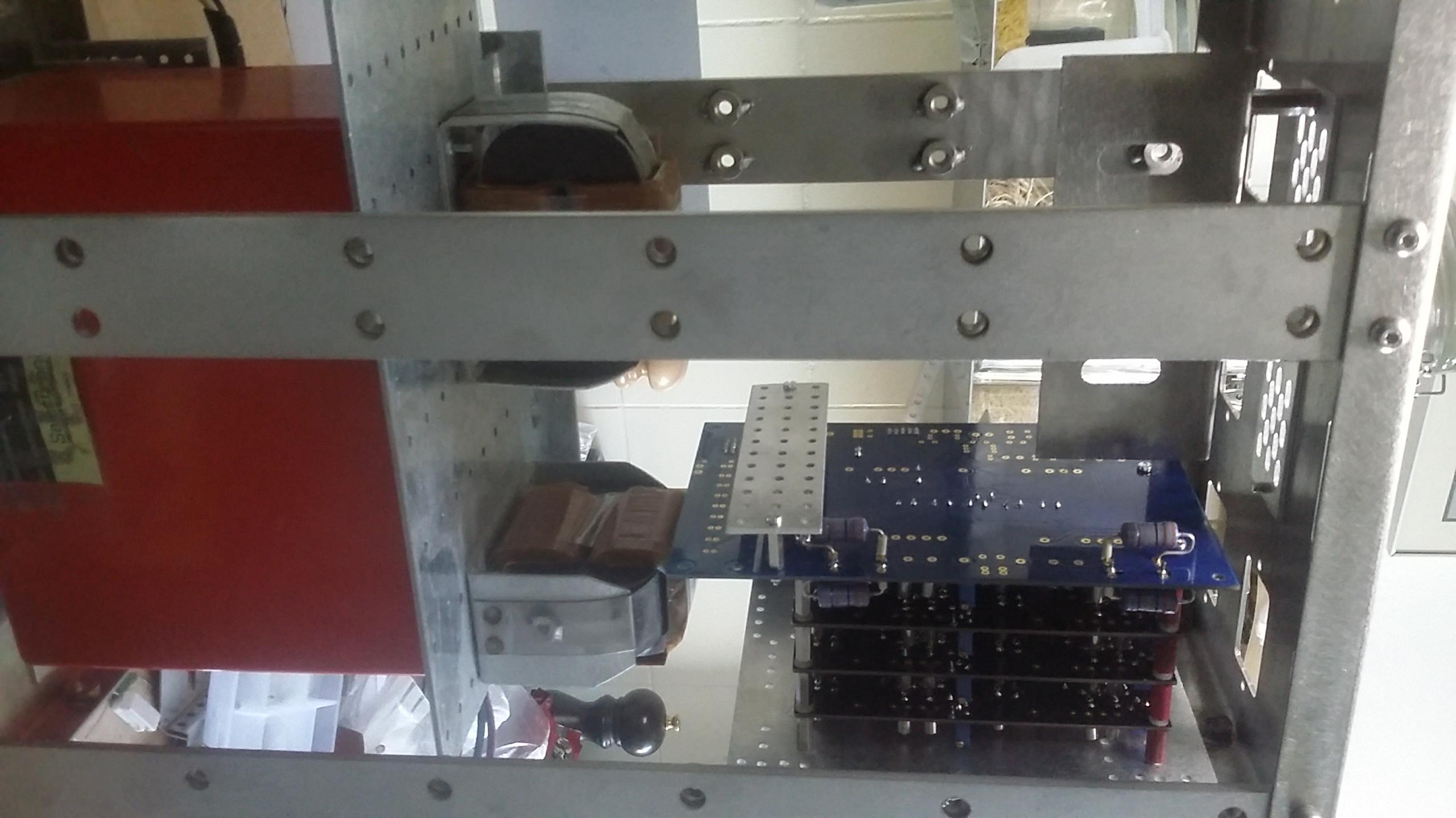

Hello,
Did make some extra metalwork to mount the circuits in my mainframe.
Not sure if I will use the led part of the mother board anyway I will have to move it to the front panel to be useful.
Did make a metal plate with the pattern for mounting the motherboard or the little board and did copy and paste ( long live cad/cam manufacturing)that pattern on that plate so the position of the board can be moved around.
Don't know where I will put the Sowters, probably on the side using the hole pattern also used for the cover plates of the rectangular holes. If the wires are about 20 centimeters I can use the 2 supports I already made. If they are not must make another support . We will see.
Greetings, eduard

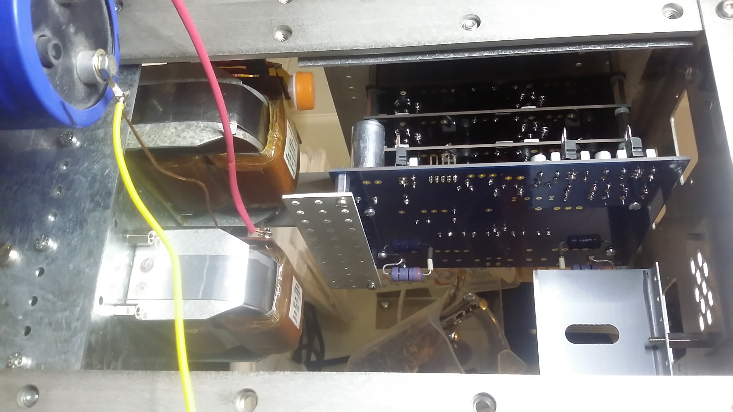

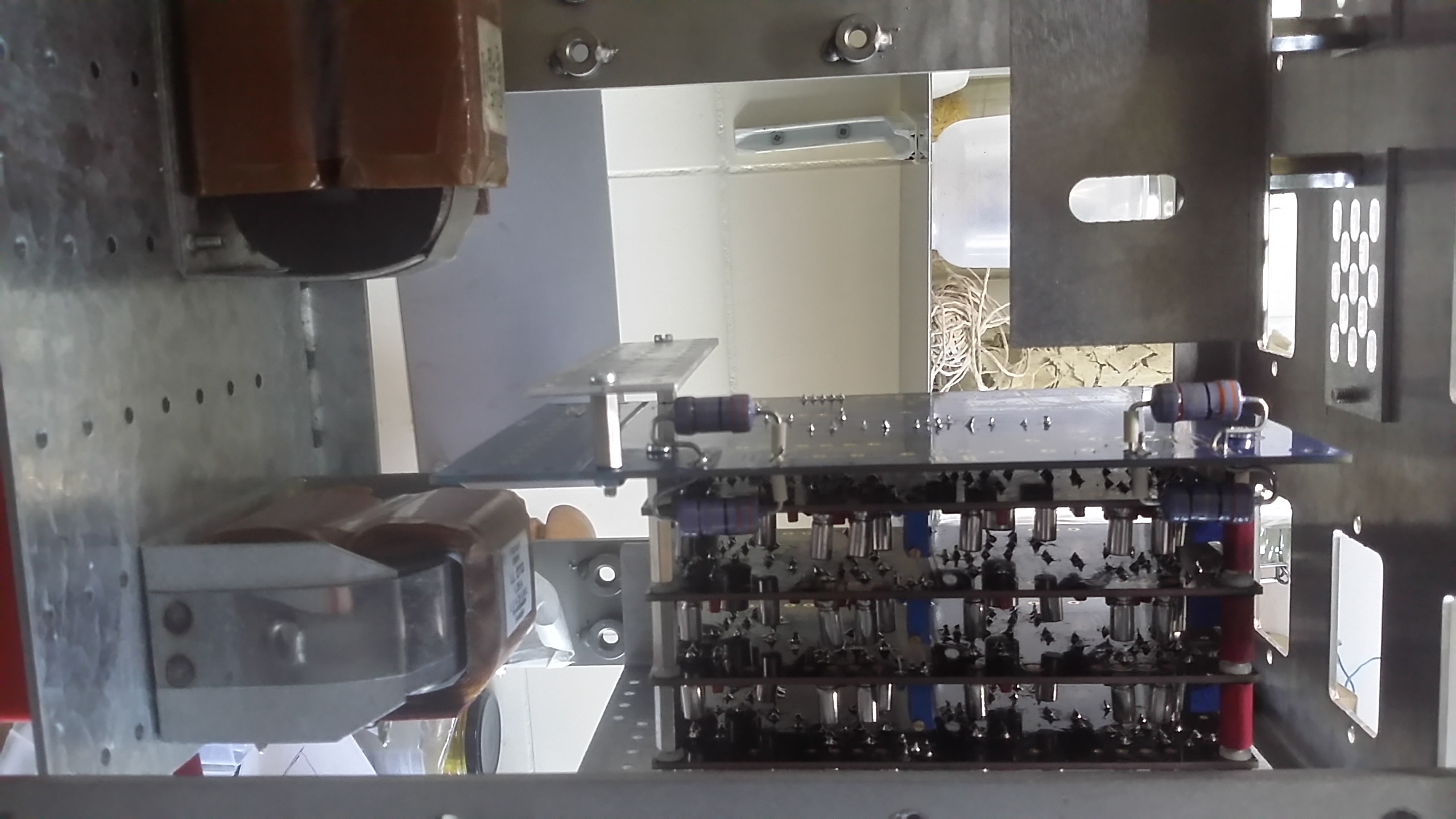

Hello,
Did put most of the parts on the circuit. Things fit well into the mainframe.
Made a small piece of aluminium attached with the holes originally intended for mounting the motherboard in a chassis. This aluminium piece can support one or two caps so they will be really close to the 12 volt input.
The LCLC power supply will be were the chokes are now.
Chokes and circuit boards can be moved around because I did "" copy and paste "" their mounting pattern.
The piece of metal with the 2 oval holes is used to mount the Sowter outputs from Doede. This piece is mounted with the same holes as the rectangular plates that cover the holes in the two sides.
If I decide to add extra boards the Sowter mounting panel can be moved further away.
Greetings, Eduard

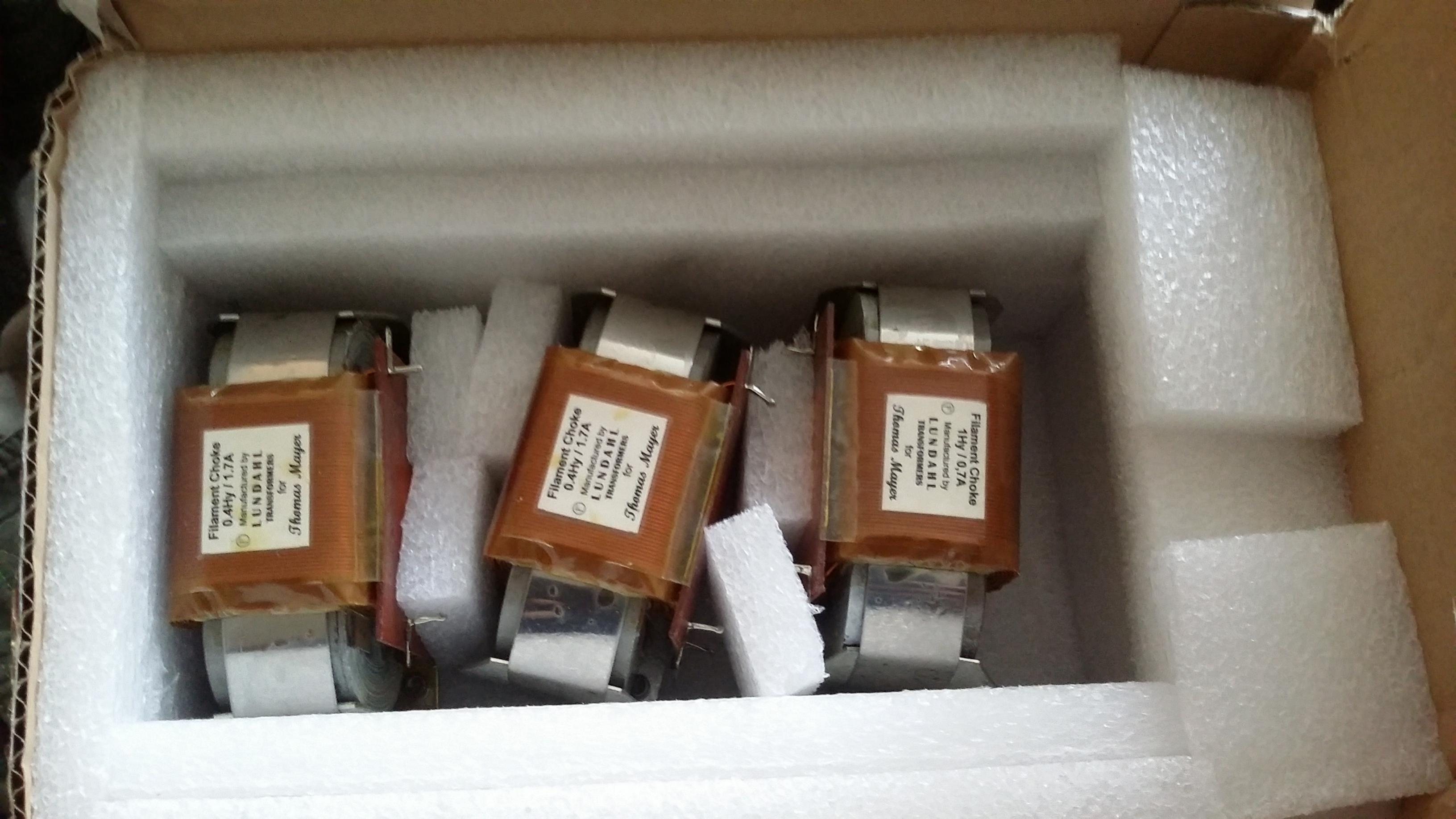

Hello,

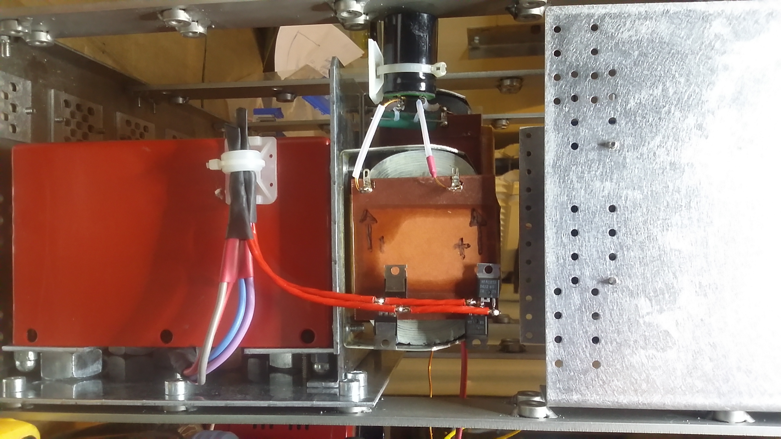

I did wire the transformer secondary side to the 4 diodes, the first ll2733 , then the first 10000 microfarad then the second ll2733 and then another 10.000 microfarad just for testing the dc voltage. Have to make something to support one or two 10000microfarad who will fit nicely next to the chokes.
Dc output voltage is 13,35 volts but it is midnight here so normally it will a bit lower. Load made with the big resistor is around 820 mA don't expect it to be much lower with the actual load 850 mA.
Could add another ll2733 but wired in parallel which will give an extra .850mA× 0,85 ohm voltage drop. The other two chokes which are not the standard ll2733 but models with a smaller airgap resulting in less current rating but higher inductance ( 700mH and 544 mH )
Greetings, Eduard

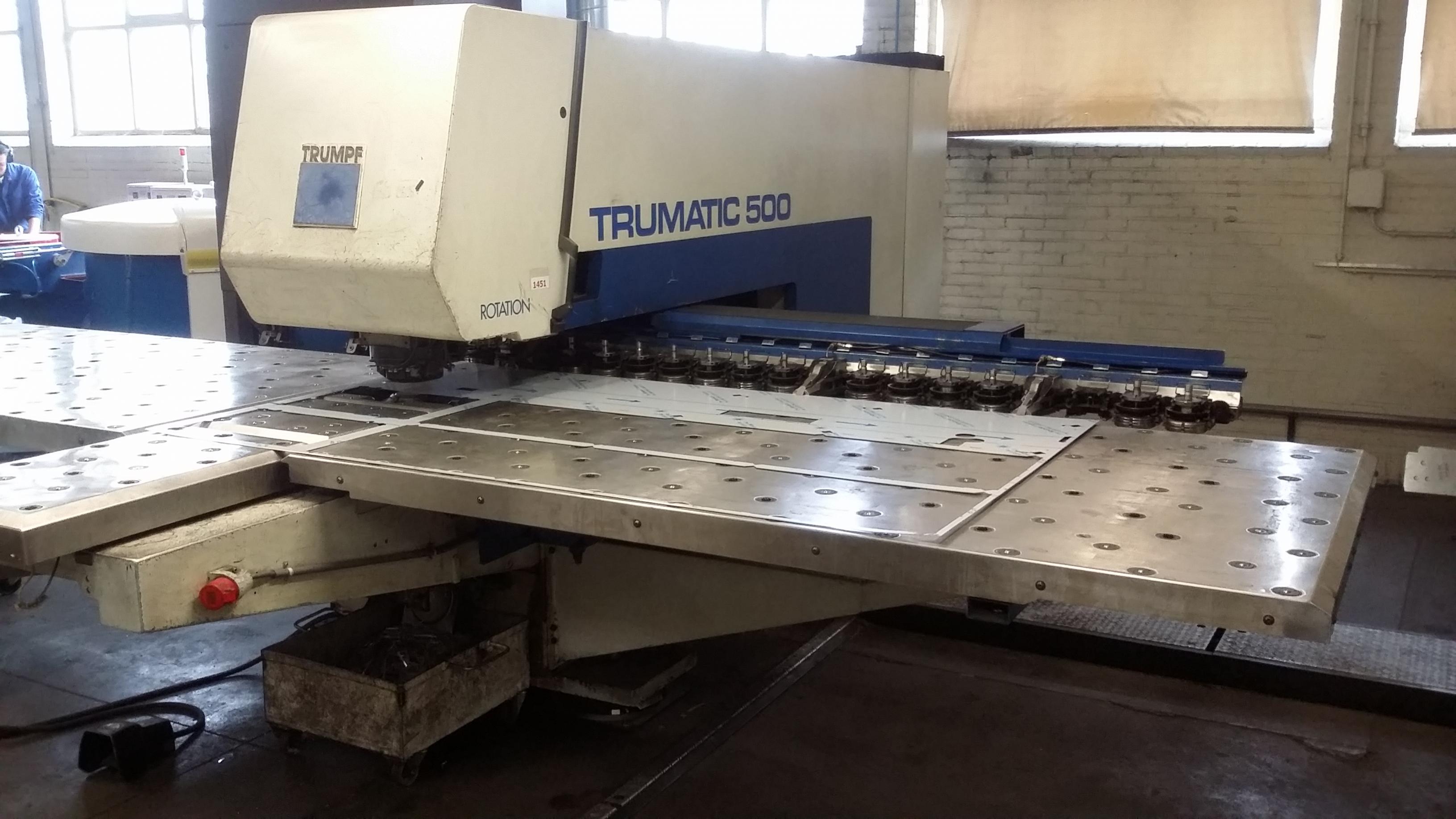

My chassis is in a stage that all metal work that still needs to be done is rather simple using my machine at work. Maybe one or two sheets will need a 90 degree bending but that is plain simple with several coworkers and their machines.
