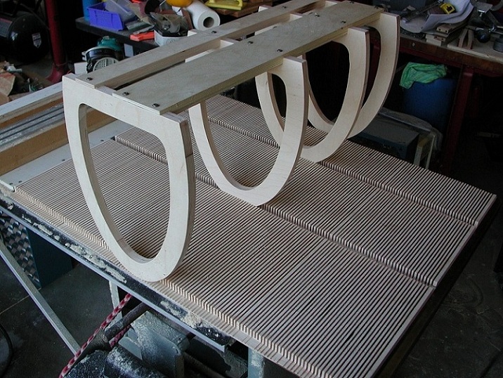

I've been experimenting with curved plywood in an effort to build cabinets for my Tang Band W8-1772's ("Curvy Tangs"....haha ).
The goal is to end up with a 45L BR cabinet tuned to 45Hz or so. These cabs will end up on tubular stands with the port and binding posts on the bottom of the cabs.
So far I've tried 3/8" wiggle wood, which didn't work because un-kerfed it will not bend tight enough, and after kerfing halfway thru at 1/2" spacing, it cracked since the grain runs parallel to the bend.

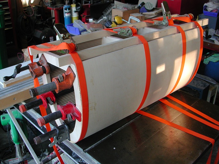

Similar results with kerfing 3/4" MDF. I cut almost all the way through every 1/4" with an 1/8" width blade, and the board broke apart when making the tight rear bend. 18mm baltic birch took a couple of attempts; the trick is to kerf down to the last lam, and make sure the last lam grain is running perpendicular to the bend.
The two strips on the flat face are fixturing to keep the formers aligned in the same plane when wrapping and gluing the sheet around the sides.
The formers were fabbed by printing a full size paper template, then carefully jig-sawing out the first one, and using it as a template to make additional formers with a router and laminate trimmer bit. They are also 18 mm BB.

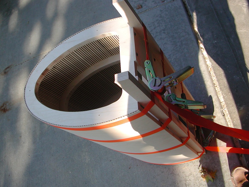

Next step is to laminate 1/8" poplar bending plywood on both faces (inside & outside) of the curved skin and then trim everything, including cutting the ends of the curved panel flush with the front baffle (which may be a bit of a challenge).

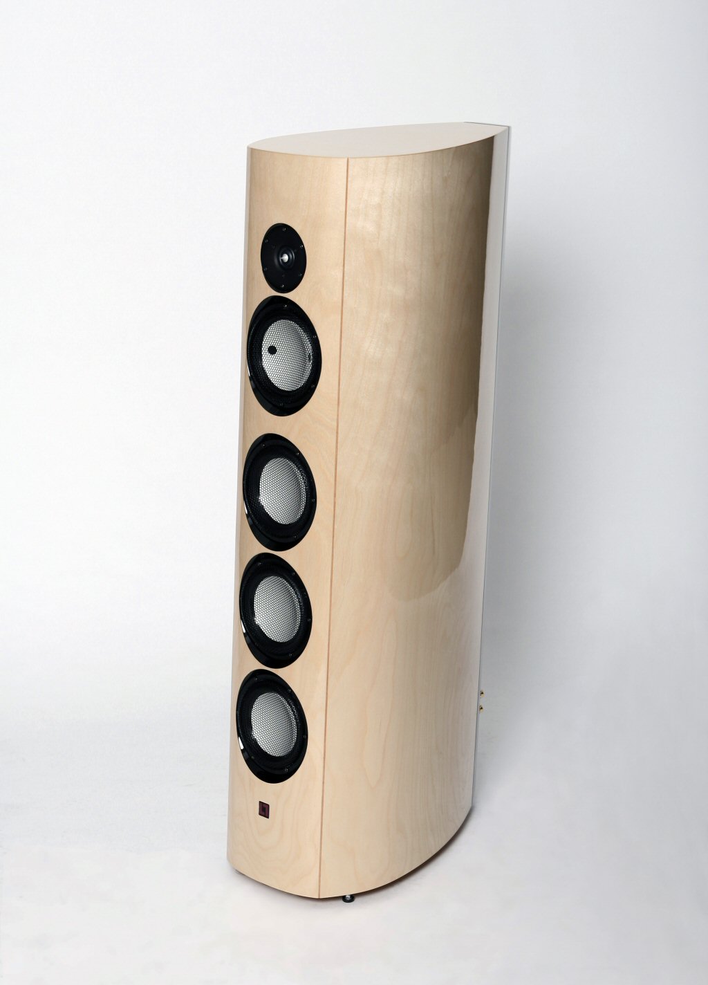

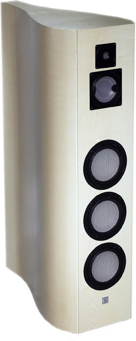

Your cabinet shape is becoming popular. I have seen stacked laminate or translam construction, as well as frame+bended board similar to your efforts on several commercial speakers. The old school construction discusses steaming thin plywood sheets and laminating them together around a frame.
Some speakers attempt to reduce cabinet edge diffraction, reduce speaker side-cone reflections, and taper the rear to reduce standing waves and rear cone reflections.
White Light speakers use an airfoil shape cabinet front in a effort to reduce diffraction effects. The bluge in front provides some space between the speaker side cone and cabinet walls. The tapering reduces standing waves. I wish I had the cabinet skills to build an MLTL for my Tang Band W8-1808 shaped like the White Light cabinet. I was surprised how much cleaner the bass from the MLTL was over past wide-and-shallow bass reflex cabinets.

Evan: Thanks for the links! I've been considering layering up 1/8" bending plywood if the heavily kerfed BB didn't work out. My hope with the kerfed 18mm BB is that I'll end up with zillions of little 7/8" tall I-beams once I glue the thin bending plywood to the inside surface. At least on paper, it should be lighter and stiffer (or at least as stiff hopefully, I haven't done any bending calcs) than one thickness of 18mm BB. With a layer of 1/8" ply on both the inside and outside surfaces, the walls will be 1" thick.

I've been building some fixturing that will allow trimming the front edges on the tablesaw. The test piece shown is also twisted about 1/4' end to end, so I've make some fixturing for that also.
My present plan is to still use kerfed BB (1/2" presently), then contact cement 3 or 4 layers of 1/8" bending ply around the BB, then veneer.

Well, once the first layer is wrapped/glued around the formers it's there for life, so no spring-back to worry about.
I'd love to use yellow PVA glue for the layers of 1/8" bending ply but I don't know how I'd hold everything together without a vacuum bag, that's why contact cement is so appealing......
For tooling, I pretty much have what's shown in the pics; various clamps and straps.
