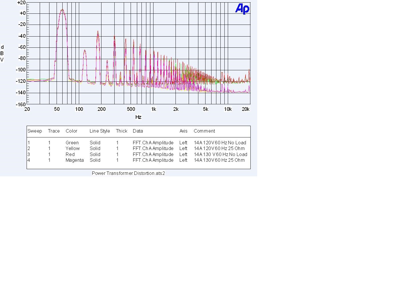

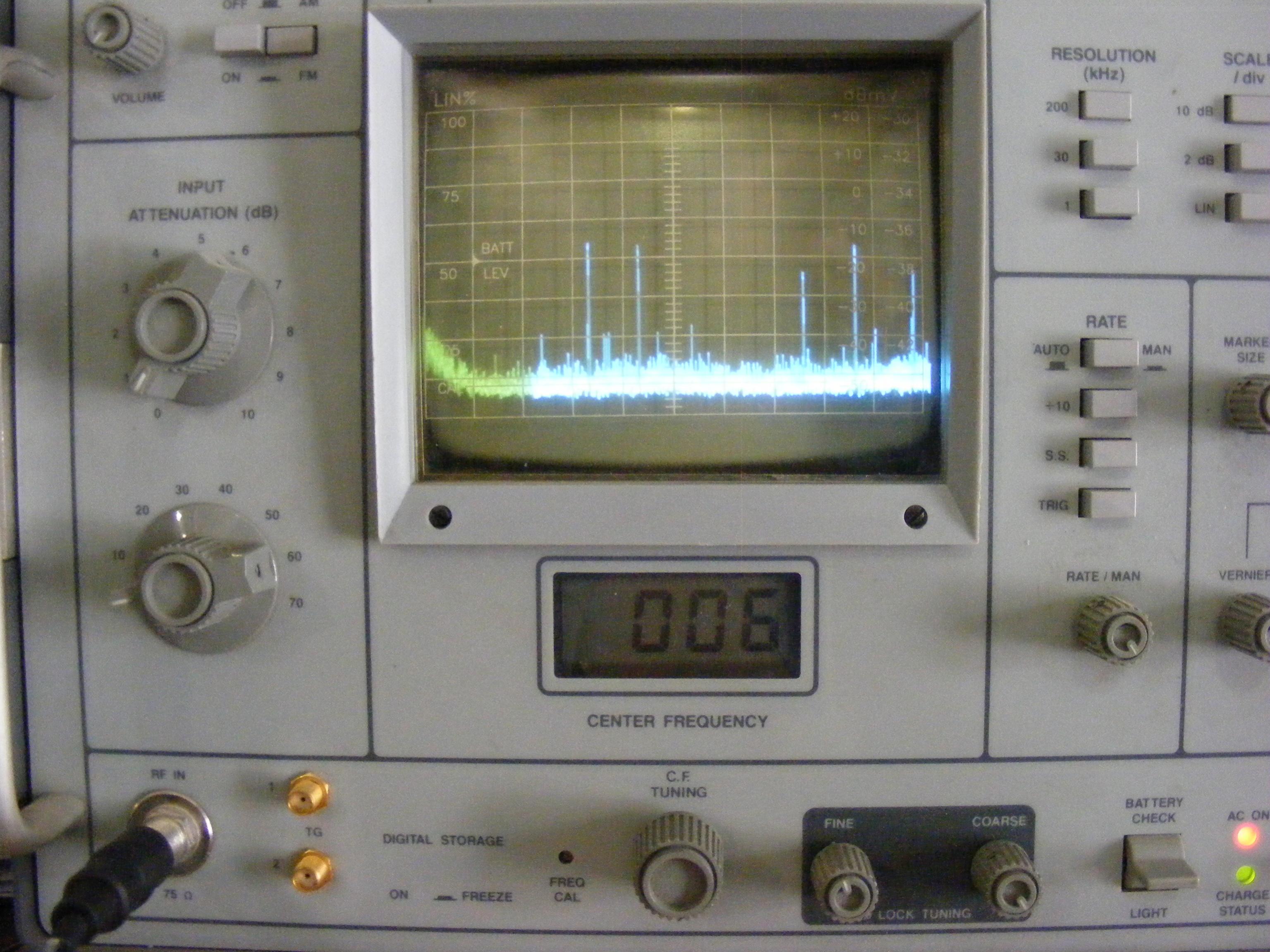

Attached is a DC to 12 MHz. spectrum of power supply noise. The power source was a sinewave generator into a power supply. All of the noise comes from the linear power supply under test.
Also attached is the noise created just by a power transformer.
And how much will a shield help line noise that is generated in the power amp and enters the pre amp down the hot conductor of the power cord? It's a direct conection, no coupling needed. The only thing to stop this is filtering. Shielding does nothing.
With a typical inductance of a microhenry or so and a shield to conductor capacitance of 1.2 nF for a 2M shielded power cord you would have filtering in the cable from 2.5 MHz and up. It also is effectively a balanced pair for the noise calculation as the common or neutral or grounded conductor has more than enough inductance at those frequencies.
Interesting stuff, Simon, and may explain why some people still recommend a filter even with linear PSUs.
