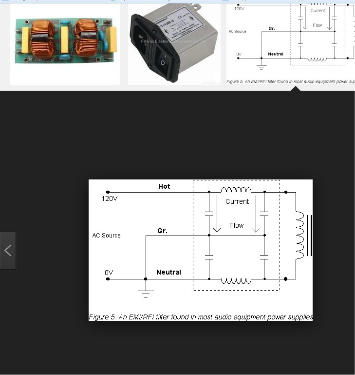

http://www.diyaudio.com/forums/atta...high-power-solid-state-power-amps-efi-rfi.jpg
This schematic implies that the Neutral and Safety Ground are connected together near the filter.
