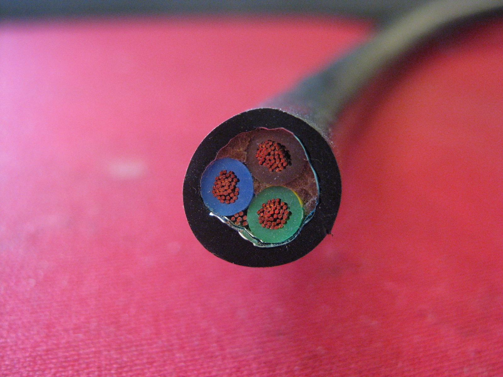

Here is a do-it-yourself description of such a cable:
DIY Belden 83803 Mains Power Cable - Audiophile Power Cord

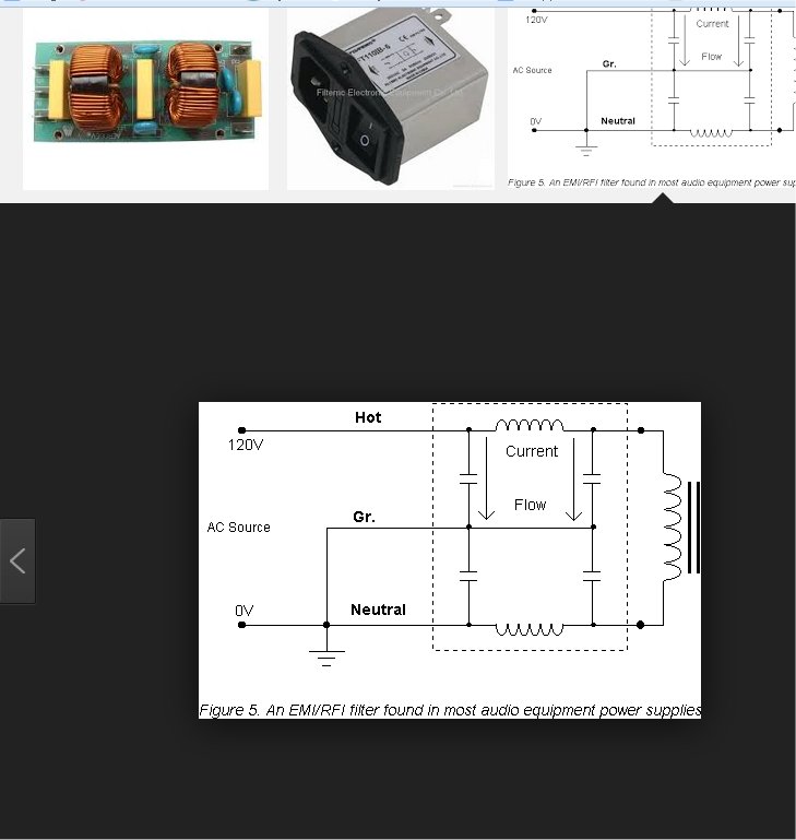

No, it's the AC input common mode /RFI filter that shields the mains from the "garbage" ....not a shielded cable.
Every PC SMPS has one right at the main AC input.
On the DC side to the SMPS , the quality of the inductors and HF decoupling keeps
this same "garbage" out of the amp .
You will also see these on the DC side of a PC SMPS , as well.
All the cheap CFL and mobile smps's has little or no filtering. This stuff "rides"
right along with primary 50/60hz waveform ... no cable will stop it !
