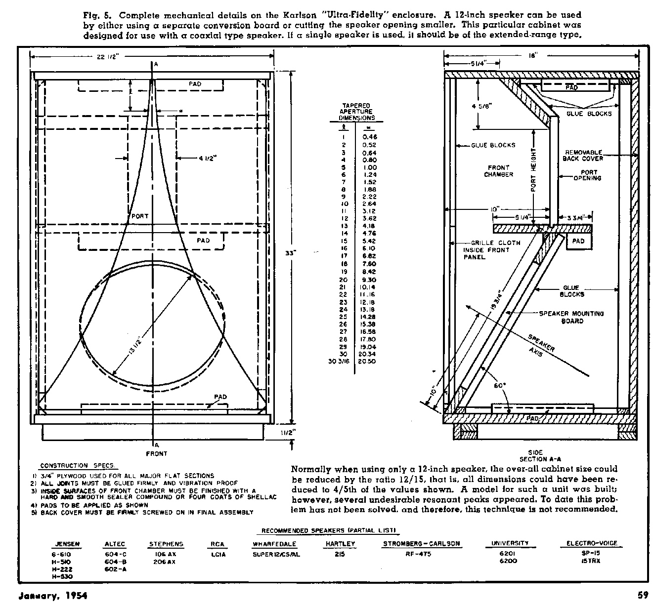

Also I think I found the K15 plans:

This image may be useful for you to help figure out the missing dimensions, however the two are not exactly alike:
Although I think the plan from 1954 is the definitive one, I just find the one by Ulfman in metric units to be easiest to implement.
1954 plan:

here's the official plan from January 1954 issue of Radio & Television News
http://i.imgur.com/oRygnBt.png

This picture of inside back is super helpful. I was having a difficult time imagining it from the plans alone.
in the January 1954 Radio and Television News article, John Karlson warned against scaling K15 by 0.8 - imo that isn't a much of a real problem - but it might be helpful to keep the front shelf short then adjust "by" ear/measurements by stacking on pieces - the front shelf in smaller couplers can keep some mids and highs from the upper half of the front section - Karlson never used the front shelf in smaller cabinets.
A 0.75 scale K15 would be pretty close in outside dimensions to factory K12s.
