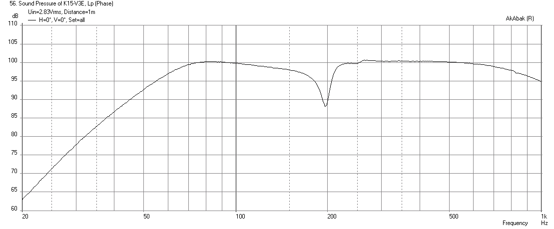

Here is the Beta 12cx in a K12:

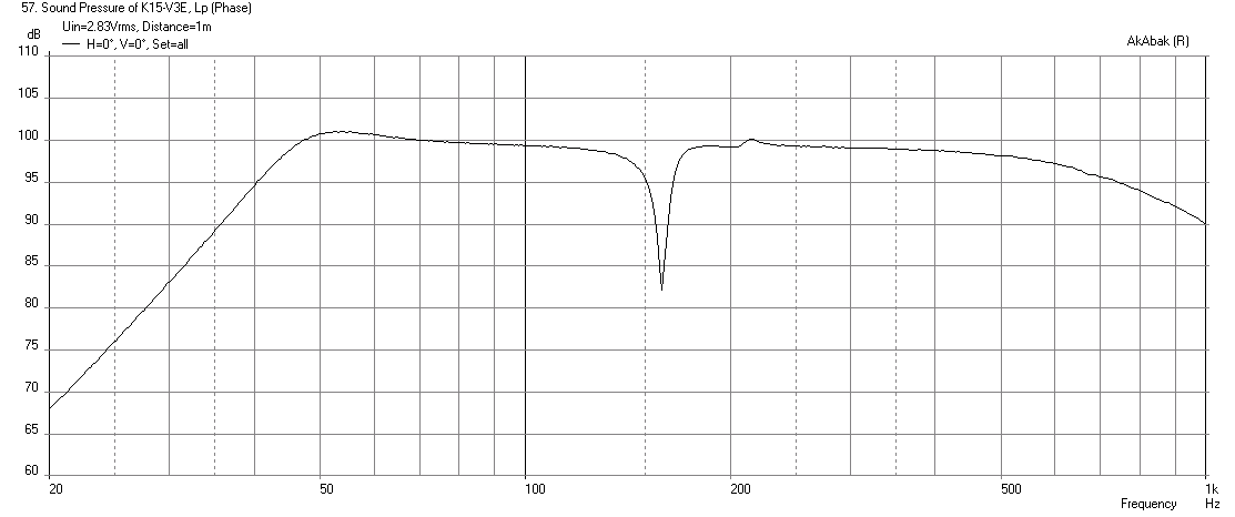

Here is the Beta 12cx in a Karlsonator (full scale 12in per GregB's drawing):
It has an early but very shallow bass roll off behavior, which may particularly match a room's gain profile very well and have a very hifi sound with deep bass. But in open space may sound anemic.
So my memory was wrong, I was thinking of the Beta 10cx which gives a nice reach to 40Hz. The large Vas and moderate Qts of the Beta12cx would require you to increase the cabinet width to 24in in order to get a flat bass shelf like this:
My suggestion is now to actually go with the K12 as you suggested earlier. Good thing I re-ran the sims. Although if you are good with an f3 of 64Hz, the Karlsonator 12 can work too. The two will sound different with the K12 being able to achieve higher SPL due to better cone loading and have snappier transients.

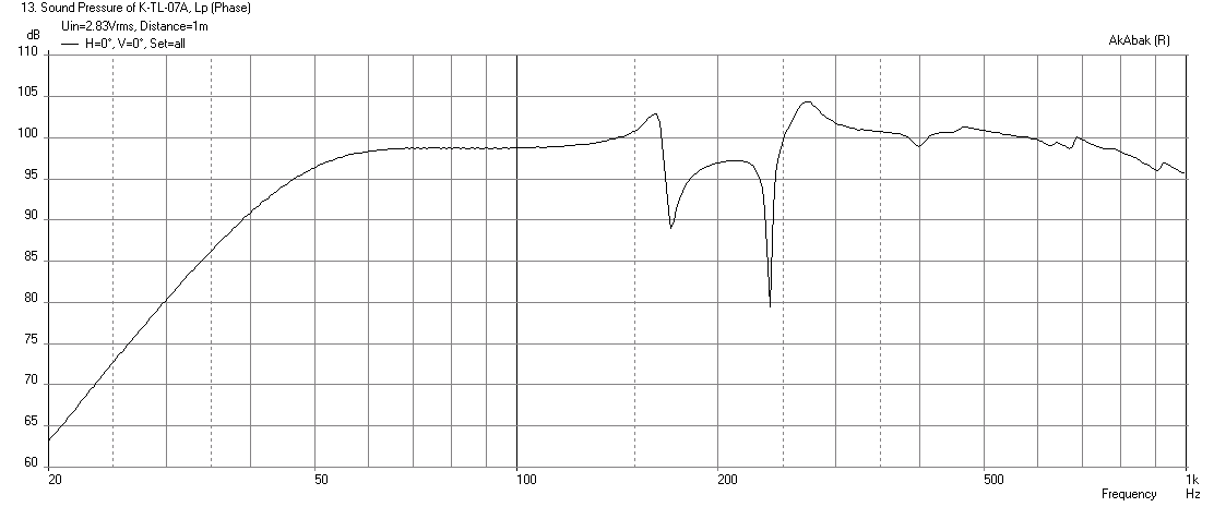

However, the Emminator is an ineteresting driver, and something I overlooked before. Glad you suggested it because it happens to have a magical fit for the K15! Bone crushing bass, deep, and lots of it. Here it is in a standard K15:

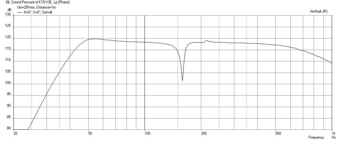

With a -24dB/oct HPF at 35Hz you can push 25 volts into the Emminator in a K15 to get 120dB at 54Hz!:

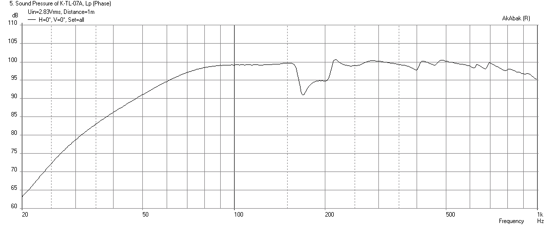

Here is the Emminator in a 1.25x scaled Karlsonator - not too shabby either:
Out of all of these, I am leaning towards the Emminator 15 in a K15. You can't pass up a special find like this without building it. 🙂
