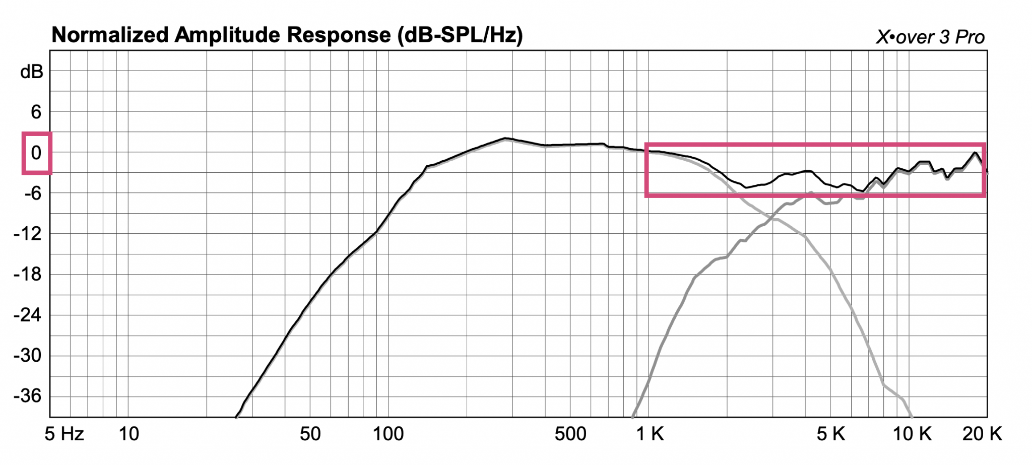

OK! Tweaking and videography done.
Video 1: The speaker as it was, the woofer connected to the crossover, with a +2dB tweeter level boost to compensate for a predicted wide trough, as shown in the image.
Video 2: The speaker with the woofer disconnected to the crossover ("Running Wild"), but with a +2dB tweeter-level boost still in effect.
Video 3: I swapped out the Tweeter Level-Setting Resistors, putting the tweeter at +0db, making it -6dB from the woofer, to compensate for the efficiency disparity between the ribbon tweeter and the woofer-mid.
I love the midrange! I cheerfully admit that I have to do a LOT more critical listening, especially to the bass, as it is getting no help from the non-existent crossover.
Thanks everyone for the interesting contributions, and I will send a link to Winslow can read the nice things people are saying.
As I said in the last video's text, the Pink Noise test is very promising, and I am loving the detail and speed of the midrange... but, what I might have done is to Frankenstein a "Sounds Great, but Measures 'Meh!' loudspeaker."

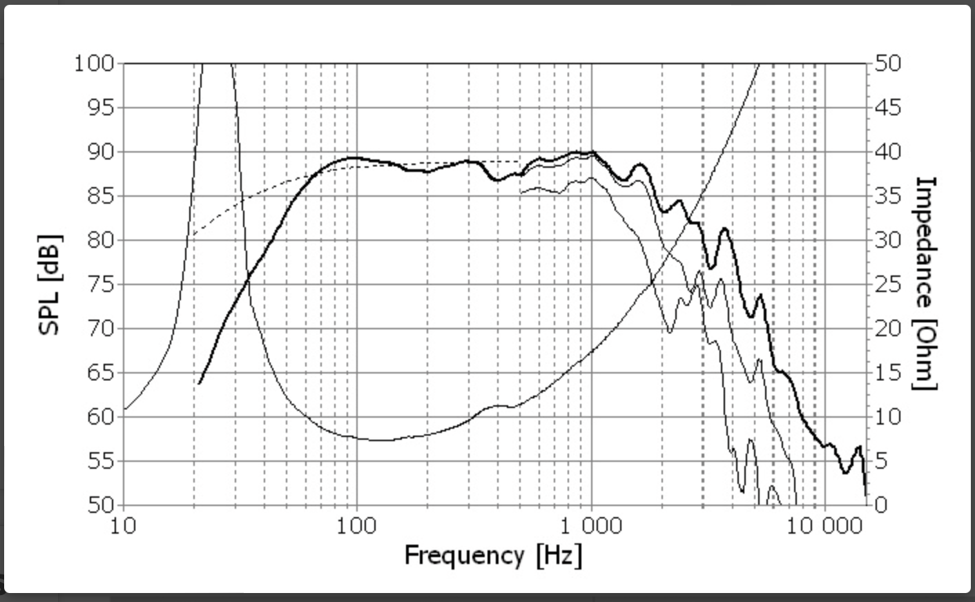

Almost every woofer or "mid-woofer" in existance has elevated distortion at higher frequencies. Don't let a smoothly falling frequency response lull you into thinking that you can run it as high as you want or avoid using a lowpass filter completely.
Consider the following frequency response. Looks pretty benign, right? No significant issues using this out to 6-7kHz?
Now consider the harmonic distortion of the same driver. There is elevated 3rd and 5th order distortion from 900Hz up to around 3kHz so you could not want to cross this woofer higher than 1kHz in order to maintain the lowest possible distortion
Another example with a less satisfactory looking frequency response. Should be ok as long as we can avoid that big peak starting at 5kHz, right?
Wrong. Distortion rises significantly starting as low as 1kHz.
Anomalies such as metal cone resonances high up show as distortions on related lower frequencies. That is certainly clear on the measurement of the Fountek. But here one should question the validity and interpretation of the measurement method itself too.
Not that I want to propagate 'free running mid woofers'. It's dumb. There is an electric LP filter in every dynamic speaker: the voice coil. It's acting quite badly, as it's value changes with the position of the cone. Apart from all other (breakup) issues, you seize to bring down a big nonlinearity by using that voice coil LP alone.
