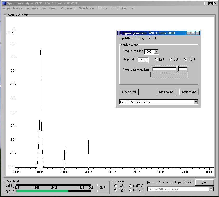

I am hoping someone can help identify what I am doing wrong while trying to adjust P3 in my BA-3 front end. I have biased each of the big mosfets at about 50mA each, offset is adjusted to +/-10mV (depends on whether you hold your breath or not) and I am using this real-time spectrum analysis software (it is the most simple to use one that I could find):
Soundcard Audio Tools and Toys
With a 47k resistor across the output, I can adjust the volume control of the BA-3 and see the results in the graph. I can change the frequency that comes out of sound card, and I can see the results in the graph. My problem is that when I adjust P3, NOTHING happens to the graph AT ALL. I know that P3 is actually in the circuit and functioning, because I can measure voltage drop across R3 and R4 and adjust this with P3 quite easily.
Attached is a screen cap of the software. 2nd and 3rd harmonics are there, but I am unable to change the relative magnitude of either. I am using a 25-turn Bourns pot and turning the pot as much as six revolutions either way from the "center" makes no difference in the graph, but does impact voltage drop across R3 and R4.
Any ideas about what I am doing wrong? Wrong software? Wrong technique?

Eric very strange indeed. Sorry to ask an obvious question but are you sure you're seeing the output of the amplifier and not a loop back from the sound card ? The only other thing I can think of is maybe that the load needs to be lowered to say 10k so the distortion products are larger.
I think you are seeing the output of the signal generator straight into the sound card...i.e., the amp is not in the circuit. Try raising and lowering the volume on the amp. Does the graph change? If not, you have the wrong input or something selected in the software. Either that or the sample time is pretty long. Depending on the software it could take minutes to react.
Also, six turns is not a lot. I keep turning until I see action. And your 2nd harmonic is pretty low right now, in fact it's right about where I like it (if that is actually the output of the amp) Also, depending on your soundcard or audio interface you might not need a dummy load resistor. I didn't use one when adjusting mine but I was using a USB audio interface.

Did some more extensive measurements and found some strange behavior. I think my original confusion with P3 was because the P1 and P2 bias adjustments are so VERY sensitive. P3, by contrast, needs some cranking in order to make small differences.
Anyhow, here is what I found after doing some FFT Spectrum Analysis and looking at input sensitivities, sine/square wave outputs. These results are with a 51k load resistor on the output and the volume level adjusted so a 1kHz sine output from the BA-3 into my sound card registers a -3dB signal level on the computer. The overall noise floor for my sound card setup is at about -100dB:
Left Channel:
I can adjust P3 to get 2nd order dominant (-72dB) with no 3rd order component (-100dB, disappears into noise floor),
I can adjust P3 so that both 2nd and 3rd order disappear into the noise floor (-100dB),
I am unable to produce a 3rd order dominant response at all.
The left channel will accept an input sine wave of up to 5v RMS before the output starts to show distortion at all volume levels.
Right Channel:
I can adjust P3 to get 2nd order dominant (-76dB) with 3rd order at -80dB,
I can adjust P3 to balance 2nd and 3rd order harmonics (both at -80dB),
I can adjust P3 to get 3rd order dominant (-80dB) with no 2nd order at all (-100dB),
The right channel though, will show visible output distortion if the input sine wave exceeds 2.0Vac RMS regardless of the volume setting.
With a 1.5v RMS input sine wave at 1kHz, both channels start to clip at about 15.5v RMS output (BA-3 has a +/-27vDC power supply). Square waves are clear and sharp-cornered at all audio frequencies.
I don't understand what is causing the differences with P3 measurement behaviors and the huge (2x) difference in input sensitivity. My input JFets are matched to within 0.01mV and the larger output transistors are matched to within about 0.05mV. All other component values match the schematic - I double checked all of the resistor and pot values.
Despite the differences in measurement, it sure makes beautiful music!

Kevin: I think part of the problem of not being able to measure differences as expected using FFT software is that my big mosfets are not precisely matched. I picked the best available that I had at the time when I built my BA-3. My J4 and K5: pair measure 2.16v & 2.18 and my J1 and K3 pair measure 2.14v & 2.20v. I've since left the pots so that both channels match in their 2nd and 3rd harmonics characteristics. I'm thinking they are 3rd harmonic dominant right now. Perhaps because of my limited ability to adjust the harmonics, I never was able to discern much of a difference in which harmonic was dominant.
