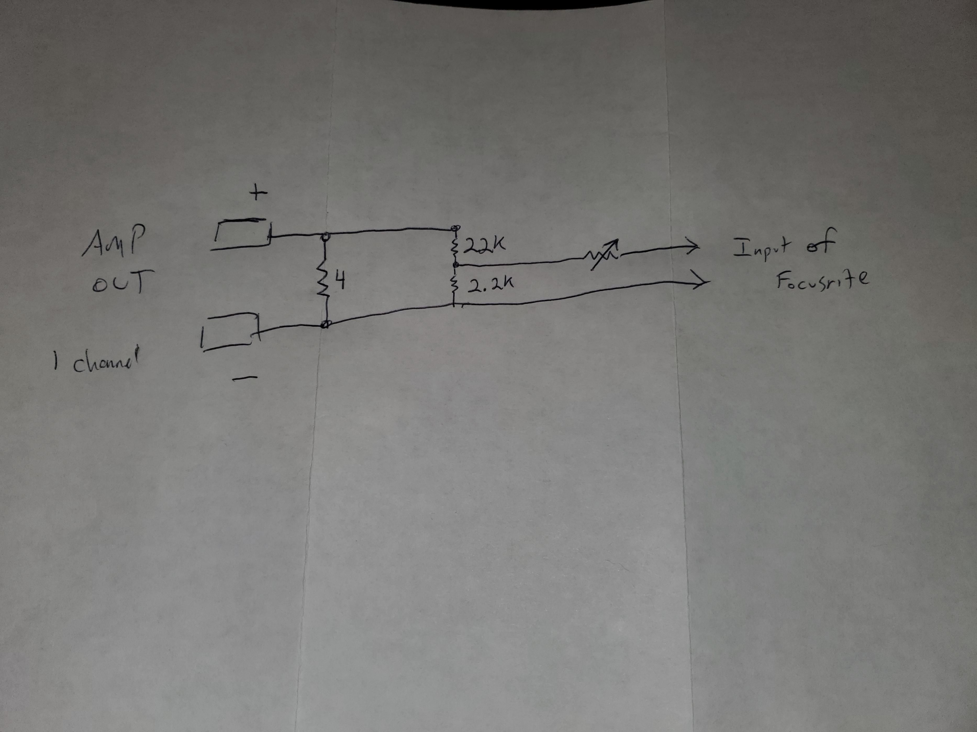

Output of focusrite is 1/4", so I need a 1/4 to rca for the amp input. Then I need to come out of amp output through a pot then back into a 1/4"jack on the input of the focusrite
I'll probably have to make something for that.
Do I understand this correctly?

I built this board that I use with the Focusrite solo. The input can be from a power amp (speaker binding post) or a preamp (RCA, one channel only).
For speakers, output of the power amp goes to the 8 ohm load from the binding post, then voltage divider of 22K and 2.2 k, then the output is taken on the 2.2k to make it lower, then RCA out, then to the attenuator (not shown but RCA to RCA) then to the Scarlet Solo input (RCA to XLR or RCA to 1/4).
For preamp, the same connection except input to the board is RCA then to 10k load resistor.

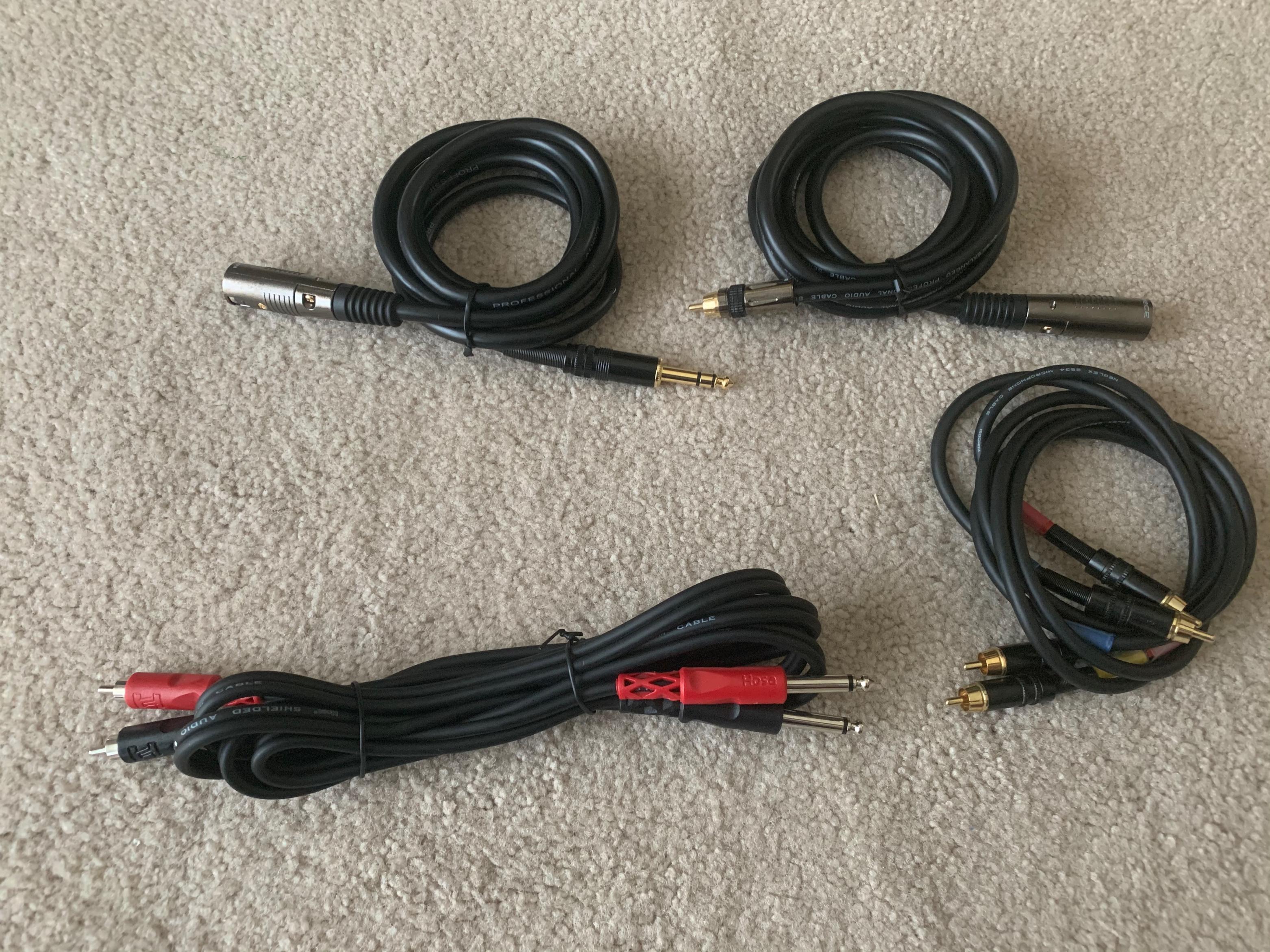

Cables that you need: XLR to RCA for loopback only. XLR to 1/4, RCA to RCA, and 1/4 to RCA (output of the Solo to preamp/amp IN) for testing.

So no XLR to RCA needed? or in addition? I'm making these as well, if I can't find ready made at Amazon or some such.
Russellc
My Focusrite Solo has female XLR and female 1/4 inputs, and L & R 1/4 outputs. I use the Male XLR to Male 1/4 cable as the loopback cable (output of the Solo to the input of the Solo).
When I test preamps or amps, I use RCA to XLR in my set up because I chose to have RCA output for the attenuator that I use. Hope I explained it clearly.
