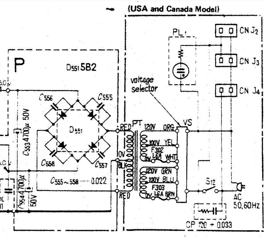

The result of the continuity check was:
Brown wire to green wire - no continuity.
Orange wire to white wire - yes continuity,.
I concluded that the wires you identifed by colour were those labeled on the schematic drawing of the transformer / power switch section?
ORG / WHT / GRN / BRN
The white wire and brown wire go to the fuses.
This excercise might have been pointless. The reason I say so is that I wondered why the power on lamp did not light.

That lamp on your diagram (PL1) is a neon and needs a high voltage to begin to work (70 to maybe 90 volts depending on type) so it may or may not work with a DBT or variac. It is also wired before the fuses and so on full mains would be expected to light whether or not the fuses were intact.This excercise might have been pointless. The reason I say so is that I wondered why the power on lamp did not light.

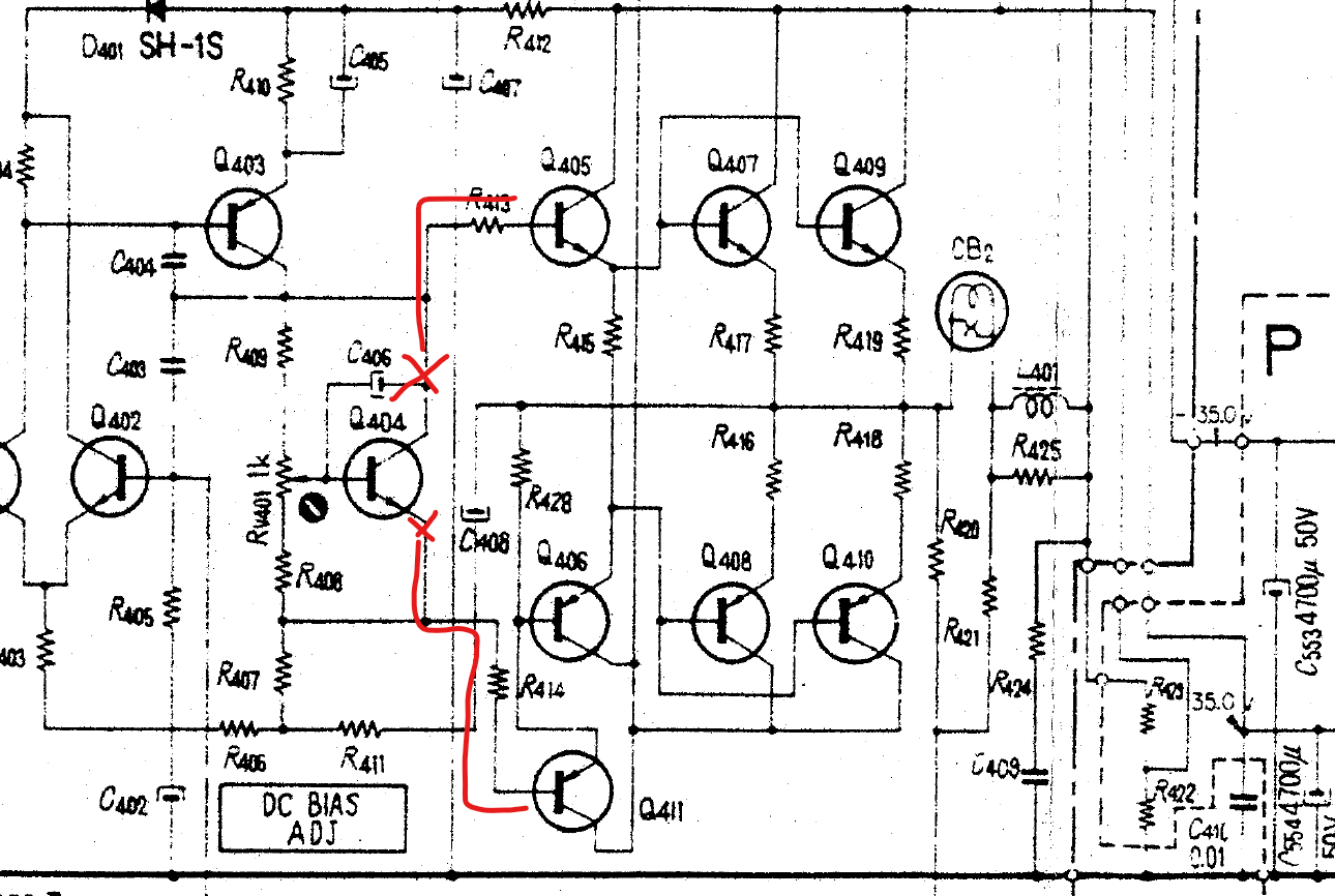

Something very amiss there. Just think about that, 7 volts across a 0.47 ohm. The current would be 7/0.47 or 15 amps and power dissipation over 100 wattsR418 however read 7.0 volts. R418 is associated with Q410 so I pulled Q410.
Lets work with that. Leave Q410 out of circuit. Now disable the bias generator by linking it out (short C to E on Q404) and see if the amp can be powered up to full mains. If it can then check the DC offset at the output and confirm it is close to zero.With no Q410 in place, the DBT behaved much differently. It did not begin the glow until the variac was near full power. And when at full power, the glow was not intense, just orange.
I did as suggested. Q410 is out of circuit and I bridged C and E on Q404.

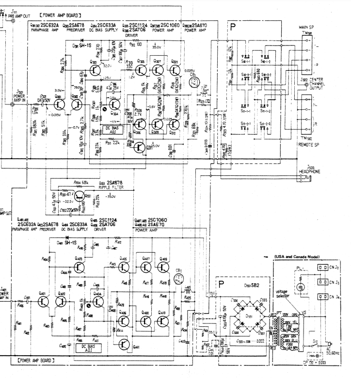

A nice amplifier, but (like some other models) it has a serious design flaw in the Vbe multiplier (for BIAS adjustment). The flaw is that the variable resistor R is not located between the base and emitter of Q404, but is connected in such a way that only the center tap of RV401 is connected to the base of Q404. As long as there is no contact fault on this pot, everything works as intended. In the event of a contact fault, the maximum possible current that the power supply is capable of delivering flows through the output transistors. This leads to the immediate destruction of at least the output power transistors, which is obviously what happened with your model. Probably also other parts are damaged due this deficiency as describe above.The unit is a Sony TA1150 integrated that I've had since 2018. It was unwell when I bought it but it did power up and it did pass signal. I did not use it per se, just hooked up for the odd listen over a couple of years then there came a time when it stopped amplifying.

With this level of destruction after such an event, the first step is to modify the power amplifier in such a way so that it works without the output buffer (which then corresponds to a discretely constructed OP-amp or a line stage in a pre-amplifier). I have described how this is done in detail somewhere here - in any case, R420 from the NFB network must be re-soldered from the speaker output to the collector or emitter of Q404 (this is now the output) in order to check the control range of the bias voltage between C and E of Q404.
Before that, of course, R401 must be moved and connect between B and E of Q404. (R409 directly connected to base of Q404).
Only when all of this has been done, the DC conditions of input stage (LTP) and VAS (voltage amplifier stage) are correct and an undistorted audio signal is present at the new output, can the output buffer be connected with new transistors (preferably only after a longer time of observation phase in this state and setting the bias voltage between C and E of Q404 to 1VDC).

Can you measure where the current is going? Do the same as before and measure volt drop across the emitter resistors. I would expect it to be zero on all four with the driver base's shorted. I think we can rule out fake parts if they are Digikey supplied.
One outlier in all this would be an intermittent short on the output line. Its very unlikely but still worth looking over. The output could be isolated here (not anywhere earlier because you must retain the Zobel network for testing). You would then have to measure offset and so on from before the speaker sockets.
