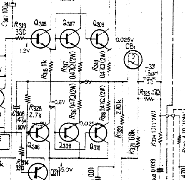

If bias is misbehaving in one channel and the other one is "good" then I would compare (between channels) voltages on bases in the driver stage - transistors Q305/306/311.
Those base voltages are as follows. I made the measurement in the order as listed beginning with Q305 and ending with Q411.
Q305 1.12 volts
Q306 (-)1.12 volts
Q311 (-)1.7 volts
Q405 1.06 volts
Q406 (-)0.7 volts
Q411 (-)1.35 volts

That all sounds promising so far as it seems basically to be working. The bias should be adjustable down to zero but this will need all four output devices per channel to be fitted.
It is checked/adjusted with no load and no signal and the final adjustment must be done on full mains voltage (no bulb) but do not remove the bulb until you are sure it is OK.
If the bias will not go to zero then the most likely reason is simply that the replacement semiconductors have different forward bias voltages. You need to increase the value of R308 to the next value higher such as 2.2k and try again. The voltage across all four of the 0.47 ohm resistors should be zero at minimum bias setting when you have full mains applied.
There isn't a 'polarity' as such for bias measurement as it depends on the polarity of the probes vs the resistors.
I did as suggested and replaced the 1.2 Kohm resistor at R308 with a 2.2 Kohm resistor. I then measured voltage across all four 0.47 ohm resistors in that channel and orbtained the following. I made the measurements on the component side of the board with full wall power. No DBT.
R319 (-)1.5mv R318 (-)1.6mv
R317 (-)1.3mv R316 (-)1.7mv.
With the 2.2 Kohm resistor in place, the scope of bias adjustment became (-)36mv to (-)42mv. I could not achieve positive voltage.
Should I reinstall the 1.2 Kohm resistor at R308 or leave the 2.2 Kohm in place?
Leave the 2.2k in place. Its normal to sometimes have to tweak the bias range following replacement of transistors as old and new manufacturing processes give slightly different characteristics in forward bias voltages.

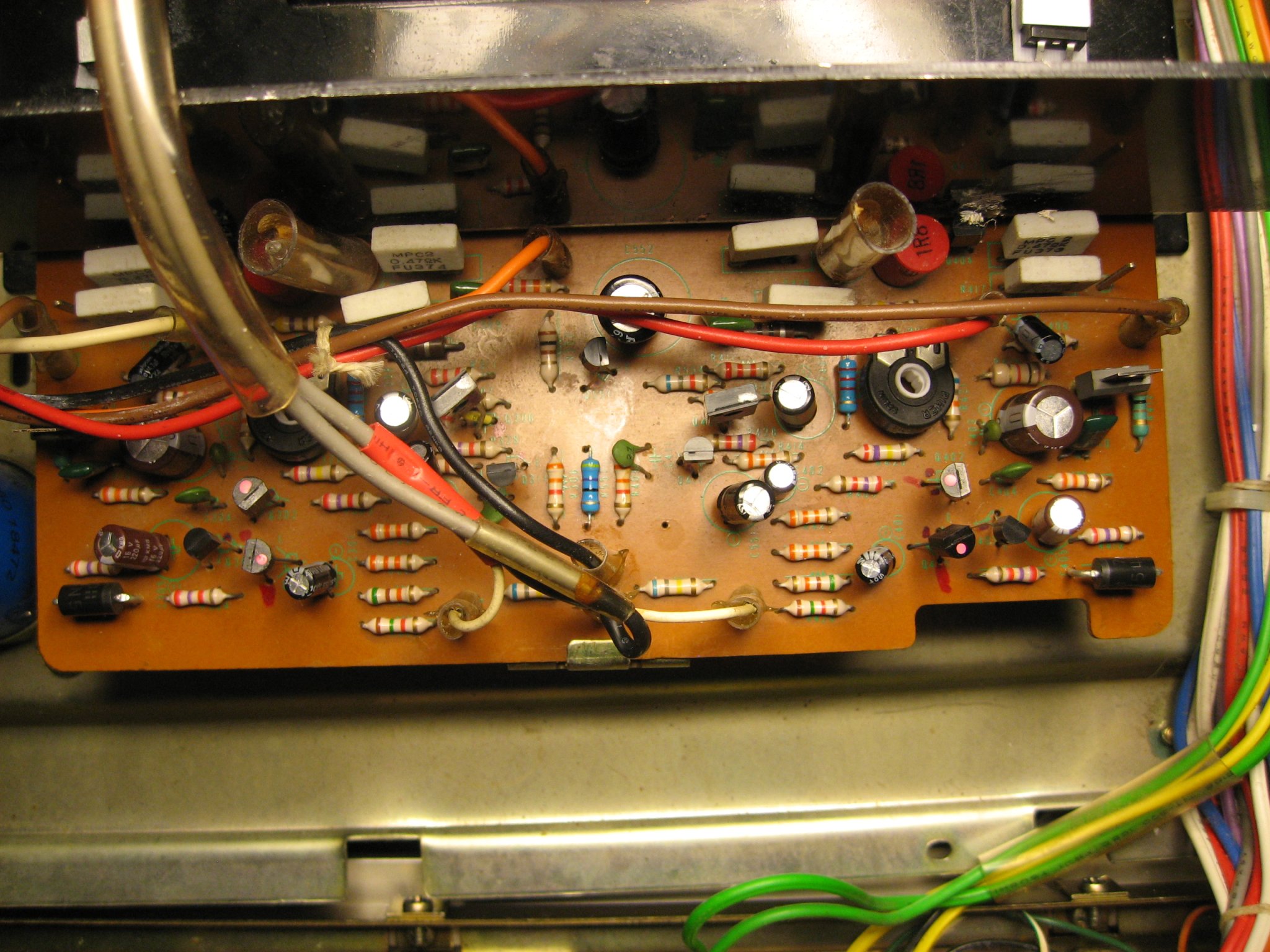

Photos as requested, such as they are.
There are a number of solder joins where there were once wire wrapped posts. I was not reposible for those. I had the two largish red wires (now marked with black and silver Sharpie ink) disconnected a short time ago to disconnect the btidge rectifier and those too were formerly wire wrapped then been soldered and are resolderd now by myself.
First pic is the trace side of whee the rectifier sits.
2nd pic is the top side of the same area showing the rectifer.
3rd pic is top side of power amp board in it's entirety.
The resistors to the right of the rectifier are worth noticing. I just now noticed them myself. A photo can be more revealing than the real thing. They are badly cracked and I imagine they suffered major stess from something.
A week or so ago when I was chasing after bad transistors, I did notice the wafting odor of an overheating component. Not seeing any scorched parts, I disreagarded it, At that time I was focused on the power amp board and did not pay attention to this section.
Both of those resistors are 1/2W 820 ohm and I have none of those. They need to be ordered. Since that is the case and its flat rate shipping, I am willing to order any other parts that might be suggested.

I took the plunge and powered up the amp using variac and DBT. The 100W DBT began to glow at 20 or 30 volts and was very bright when 120V was reached. And as you said, fuses did not blow.
My DMM set to AC volts did not display 24V AC at those two red wires - those with the Sharpie ink smears in the photo. The same red wires I unsoldered when wanting to disconnect the bridge rectifier. Instead, I got readings of (-)3.0V AC and 3.0V AC going left to right.
Given it basically powers up I think it will either come down to a shorted diode in the bridge or you have zapped the output stage in one channel.
Get the bulb so its glowing and then measure the DC voltage across each 0.47 ohm emitter resistor for all the output transistors. If any have significant voltage across them then you've zapped an output stage. Significant means 10's to a 100 or so millivolts (or more).
These should be the power transformer secondaries - how much AC do you measure between them when they are unsoldered from the board?My DMM set to AC volts did not display 24V AC at those two red wires - those with the Sharpie ink smears in the photo.
From the first photo (of the three) it seems that the rectifier bridge needs resoldering.
-/-35V (rail power) should be measured on the thinner brown and orange wires (winding pins) adjacent to the bridge.
