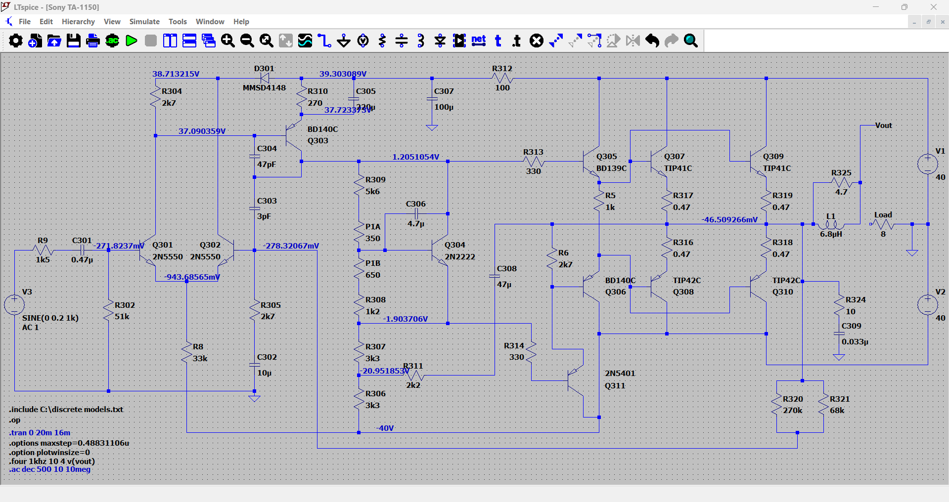

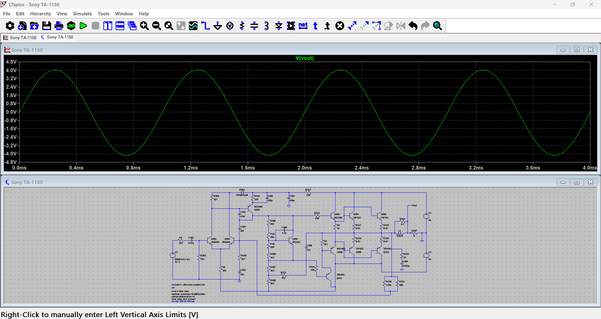

I've thrown the circuit into a simulation to see what is going on and it might be clearer to follow than the printed diagram.
Look at R306 and R307. The volt drop across two series connected equal value resistors is always identical provided there is nothing across one or other of them to unbalance or change the value of one or the other. R311 is the only connection to these series resistors and your measurement of no volt drop across this resistor suggests its not related... but to be even more certain you can remove R311 for test purposes and the amp should still work normally for testing.

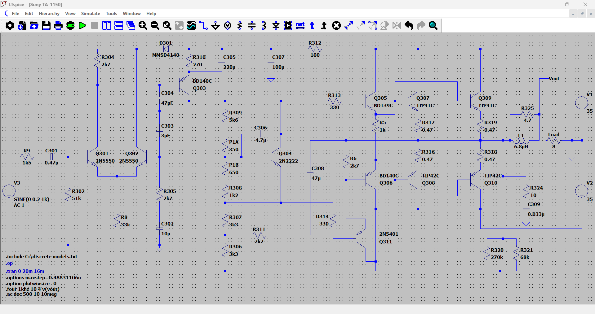

And these are the normal voltages:
Two series resistors of equal value have the same current flowing through them and that develops the same volt drop across each.

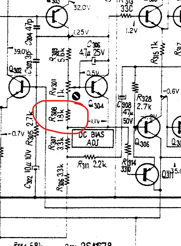

That still sounds good to me as nothing bad happens and it does begin to adjust. All you need to do now is tweak the value of R308 by reducing its value a little. It looks to be a 1k8 (printing is poor) but the parts list say 1.2k
Try adding a 10k across R308 and going lower in value gradually until you get the bias in range. Again do one channel at a time and set the bias back to minimum when you are happy with it.

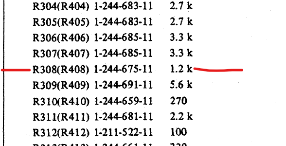

Beginning in post #164, R308 was discussed.
R308 was originally a 1.2K ohm resistor that was swapped out for a 2.2K ohm resistor. A 2.2K ohm is currently at R308 and at R408.
Would re-installing a 1.2K ohm resistor be of benefit here?
Or should I proceed by experimenting, as advised, paralleling R308 with different value resistors beginning with 10K and working downward?
You can try the original 1.2k on just one channel if you want. Keep the bulb in place and make sure the bias is set to minimum before switching on. So that is replacing the resistor, not paralleling the 2.2k with 1.2k
If the bias is to high (bulb lights) with a 1.2k then we will have to increase its value to a 1.5k or 1.8k.

During that time you could take one more measurement - measure voltages (against ground) on collector and emitter of Q304 while adjusting the bias. They should change in a similar tempo and end up (at max bias position) around 1,1...1,2V (according to the schematics).
That's right, and the voltage between C and E ultimately determines the bias current. As you turn the bias up the voltage across the transistor rises until the five transistors in the putput stage are turned on just enough (the Sony is an odd one with Q311 making an odd number of transistors, three drivers and then the output pairs)
With DBT in place, turning bias pot to maximum made voltage at Q304 base increase to (-)1.04mv. Voltage at Q304 collector reached (+)1.09mV.
