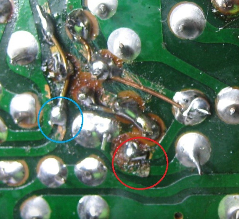

If you look at the attached, circled in red, to me looks like the solder pad is almost folded over and isnt connected to the component
The blue one could be connected to the other track, so i would take that off and re do the connection

That circled in red solder pad had lifted but looked still intact and was soldered to the component. But to be certain I soldered in a bridge. I re-flowed the circled in blue connection and it is not in contact with that other track - no continuity.

I then desoldered all components in areas where there was a soldering condition on the underside of the board as image of post #203 show.
Then I removed the solder and then the green solder mask (with very fine sandpaper). As next step I tinned all the conductor tracks and recreated the missing conductor tracks with pre-tinned copper wires. The second device with power amplifier in working condition served as a template for this.
After re-soldering the parts on the main PCB -,partly replaced with new ones - the procedure as described in post #113 (120) was carried out (additional introducing 0,47R emitter resistors on the power transistors, which were missing in the original state) and this integrated amplifier still works today without any problems.

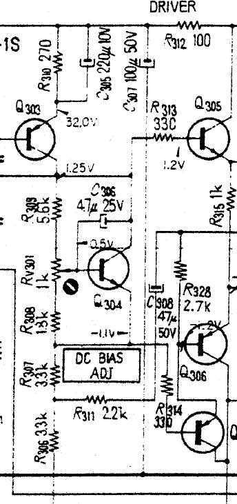

Working with -4.2v on the base of Q302 and -0.145v on the base of Q301 should totally unbalance those two transistors and that should cause Q301 to turn fully on. This means Q301 pulls base current through Q303 turning on Q303 fully. With Q303 fully on you should have a very high positive voltage on the Q303 collector and that in turn should switch on fully the upper NPN driver and output and give you an offset of +30 volts or more.
Now that is not happening because you have a -4.5 volt offset so we need to see where in that chain it all goes wrong. Remember we are measuring this in the faulty state and so these are the voltage I would expect in this state.
So things to check.

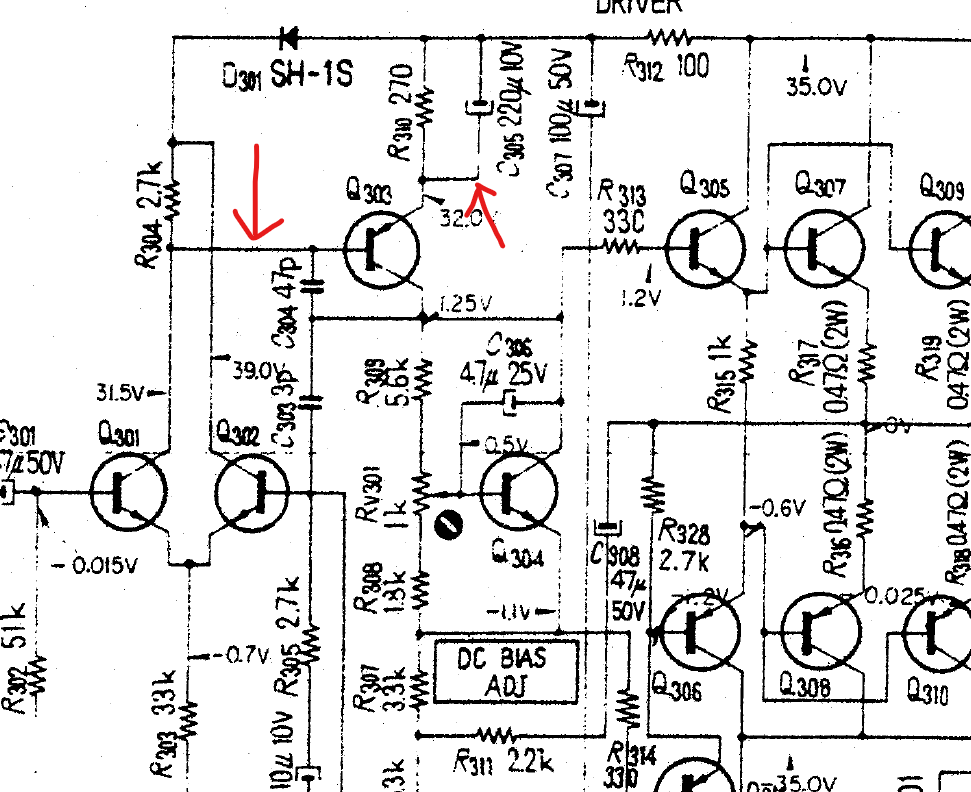

1/ Measure the voltage across R307. There should be at least 2v here.
2/ Measure the voltage across R310. There should be 2v or more across this resistor.
3/ Measure the collector voltage on Q303. That is the lead going to R313 and R309. You have already measured the voltage here as +1.18 volt so this double checks that result.
Q303 is actually a prime suspect at this point. Make sure you have it fitted correctly. Lets try and prove it all first though
4/ Finally one careful measurement (don't short anything 🙂) between Base and Emitter of Q303. You should see about 0.7 volts across this junction and the emitter should be the more positive.

1/ I'm sorry, I've given a wrong resistor reference for that. It should have been R304 (2k7) but no matter at this point because the next step shows it is probably correct and around 2v
2/ 2.9 volts is getting a little on the high side if the 270 ohm is OK. 2.9 v across 270 would over 10ma but where is that current going? Something amiss here I think.
3/ Hmm. -3.1v on the collector definitely doesn't compute. It should be sky high and positive in this faulty state.
Switch off and check that R310 (270 ohm) is OK and not high in value. You should isolate one end of it to get an accurate reading if there is any doubt. That resistor going high in value would give all the symptoms you have. A high negative offset (how high depends how much in value the resistor has increased), it would also give the -4.5 volts on the base of Q302 that you have and also give the -3.1 or so on the collector of Q303.

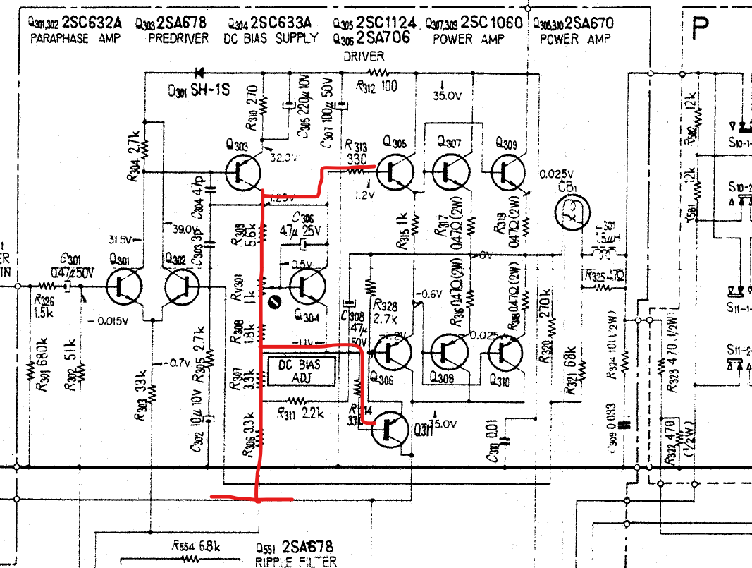

OK, we persist with the same line of reasoning now because something doesn't add up around Q303.
With 2.9 volts across R310 means there has to be about 11 ma flowing in that resistor. Look at the circuit and see if this makes sense:
The only valid path is via the vbe multiplier and the R306/307 chain to the negative rail. Base current into the driver stages should be miniscule so we can discount that. 11ma flowing in that R306/307 chain would bring the voltage up to near the positive rail value and that is not happening. You would get 11ma if Q303 was faulty (near short) but that would put supply voltage onto the collector and yet you have just -3.1 volts here.
The theory (2.9v across 270 ohm) is absolute. There is 11ma there. There doesn't seem to be any viable path.
Lets try and prove this. Kirchhoff's law... the sum of currents leaving a node must equal the sum of currents entering it.
Look at Q303. The current enters via the emitter and this is the 11ma we calculate. (Might be worth rechecking that 2.9 volt measurement across that resistor R310). The only place that 11ma can go is out via the collector and out via the base.
The collector current can only flow into these paths and we can calculate the total easily by just measuring voltages across the resistors, calculate the current and add them together.
The current in R306 should normally equal the current in R310 but that would mean around 36 volts across R306.
Non of this is making sense now for there to be just a single fault or problem causing this. Not that I can just see anyway... more than one problem could it but it becomes ever so much harder at a distance to diagnose this I'm afraid.
I say a single fault, I can see only one other possible single fault that might do this and it would Q311 but it would have to leaky from base to collector and open on the emitter/collector path.

But I did notice something, perhaps.
That is the solder pad and trace for emitter of Q306. It could be that there is missing pad/trace material. I cannot see well enough tonight to examine it. I need better light.
Maybe it's my aging eysight but with this board I find it hard to tell what is trace and what is mask between traces. There is little colour contrast.
If the emitter of Q306 was not connected, would that factor in to this problem? There was significant damage to solder pads of Q306 and was one of the areas I had to create jumpers. I may have missed one.
All I can report at this time is that there is 2.9 volts across R310.
That is high. Lets just go back on something I missed in your measurements on Sunday.
R306 and R307. These should have equal volt drop across them as they are in series and the same value.
(R311 that connects to the junction of these resistors is AC coupled by cap C308 and so should not play any part in causing an error here. As a check the voltage across R311 should always be zero)
Can you measure the value of these two 3k3 resistors and make sure that both are 3k3 as per the circuit. Make sure there are no shorts or solder blobs causing a problem around them. Have these been replaced before and maybe a wrong value fitted? Perhaps measure the value in circuit first and see if the one with only a couple of volts across it reads low in value in circuit.
I can't believe I missed not seeing that earlier. The voltage across those two has to be equal at all times.
Q306 emitter on its own if not connected I can't really see causing this. Obviously check it carefully though if there is doubt because having more than one problem is something I do suspect as possible. So it could be one part of the puzzle.
Voltage drop across R306 and R307 are not equal.
R306 2.9 volts
R307 31.3 volts
Voltage across R311 is basically 0,0 volts. It flickers between 0.0 volts and 1.0mV. Or perhaps it was between 0.0 volts and 0.1mV
The in circuit measurments for R306 and R307 are not equal. Only R307 measures correctly.
R306 2.2K ohms
R307 3.3K ohms.
There are no shorts or blobs around them.
Neither has been replaced, they are both original. And both are marked with correct banding for 3.3K ohms - ORN/ORN/RED.
I shall hold off on scrrutinizing the Q306 emitter trace for the momant.
