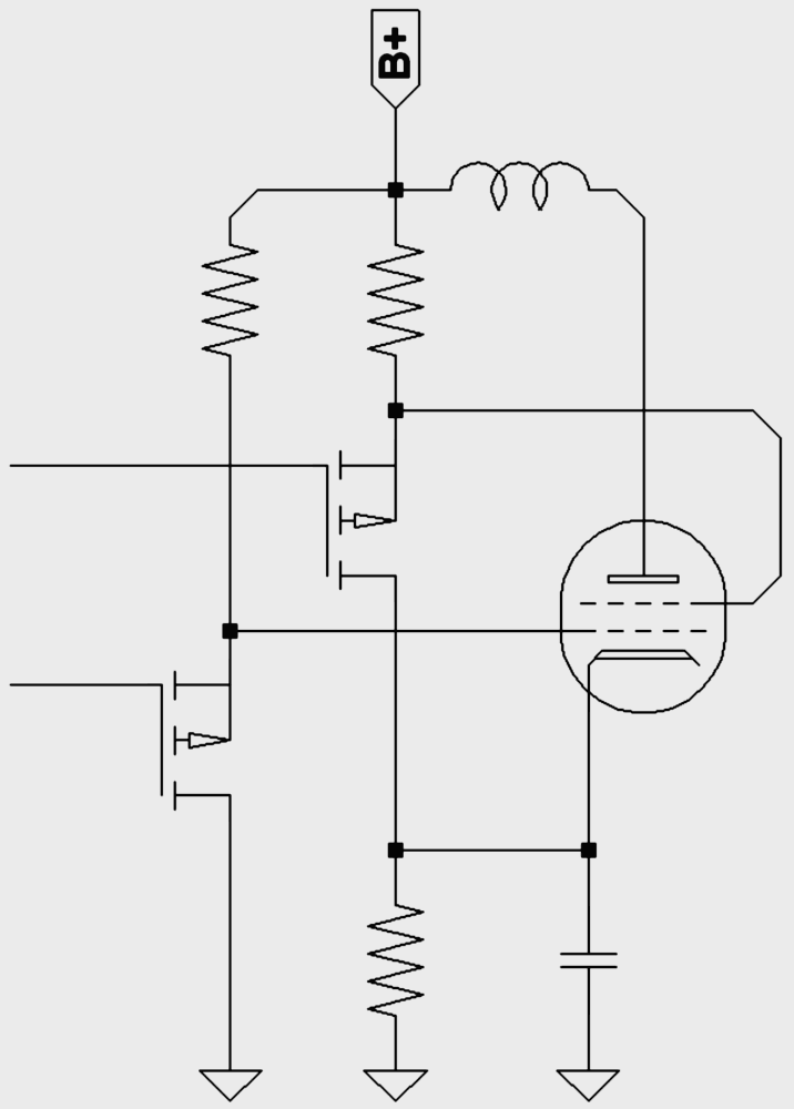

I thought I would resurrect this thread to share me experiments with this adjustable load topology. I really, like this topology it is very foolproof in operation ther is no Bias to adjust is extremely stable as well as tolerant of a wide variations of load mismatch without any stability issues. The impedance tap switch appears to simply determine the damping and output power, Unlike most tube, Amps where there is also a noticeable change in frequency response with load impedance on any given transformer tap. It also controls the cone of the Woofer in a vented box a lot better than other SE Class A Amps I tried. It is presently used in a second system with Loudspeakers that are not friendly to a solid state Amp let alone a SE Tube unit, yet this amp dose NOT Audibly follow the wild impedance curve the speakers present.
Another nice feature is the bias of the output tubes can be adjusted slightly as needed by a trim pot on the screen grid, however the circuit as shown accommodates such a wide verity of output valves I felt adjusting the Bias was not required.
This topology is as close as I have come or experienced in a Load tolerance from valve Amplifiers. I am presently working on a push pull version using KT88’s and three stages of amplification..
I have found that the cathode feedback is the major contributor to this effect since the feedback varies with the speaker impedance. Your circuit does not apply any AC feedback to the screen, but 13K of resistance in series with the screen must have some DC stabilizing effect.

I have built two different push pull driver boards and I have been hooking all sorts of things up to them. Some things (like the usual pair of KT88's) work well (as expected), some things blow up (expected as well) but every once in a while I get a stupid idea that just might work.
I built a multiple output PowerDrive board with each driver capable of independent DC voltage and AC gain and Phase controls. Wire one output to each grid (and even the cathode) of a power tube and you can turn knobs all day long. The present implementation used a P-P driver board to feed a SE amp. Further experiments are forthcomming.
I also have been trying different tube topologies from Triode to cascoded dual triodes to cascoded triode strapped 6L6’s. While playing around with these power tubes I remembered from the old ham days of directing the electron beam by strategic G2 voltages’. While researching this I found this article on OPTIMIZED ULTRA-LINEAR OPERATION http://www.webace.com.au/~electron/tubes/ulo.html
Prior to the addition of D3 as advocated also on above site, there was AC feedback from the Plate to the screen grid. Notice that this stage without D3 is similar to the Driver stage that is a cascoded operated in Ultra linear mode. The method I believe has all the advantages of using a transformer tap as in conventional Ultra linear operation, however without the stability issues. The disadvantage of this mode is not taking advantage of an opportunity to add yet another feedback loop around the output transformer further lowering distortion.
Now probably would be a good time (Since I am Going Push Pull) to think about adding a dedicated UL winding that is not connected to the primary winding at all to supply a lower screen voltage while also affording feedback around the transformer.
You are correct that adding cathode feedback totally corrected the coloration with wild Loudspeaker loads, although this was already getting quite good prior to the addition of cathode feedback. I did each mod in steppes and seriously evaluated the results prior to proceeding on to the next mod.

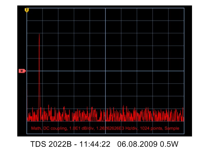

A others predicted, a straight 1Khz from a 20dB gl nfb UL 40% 7W ECL82 p-p amp into a resistive 4 ohm load at 0.5W produces sterile results. THD = near nothing. math graph pic.
