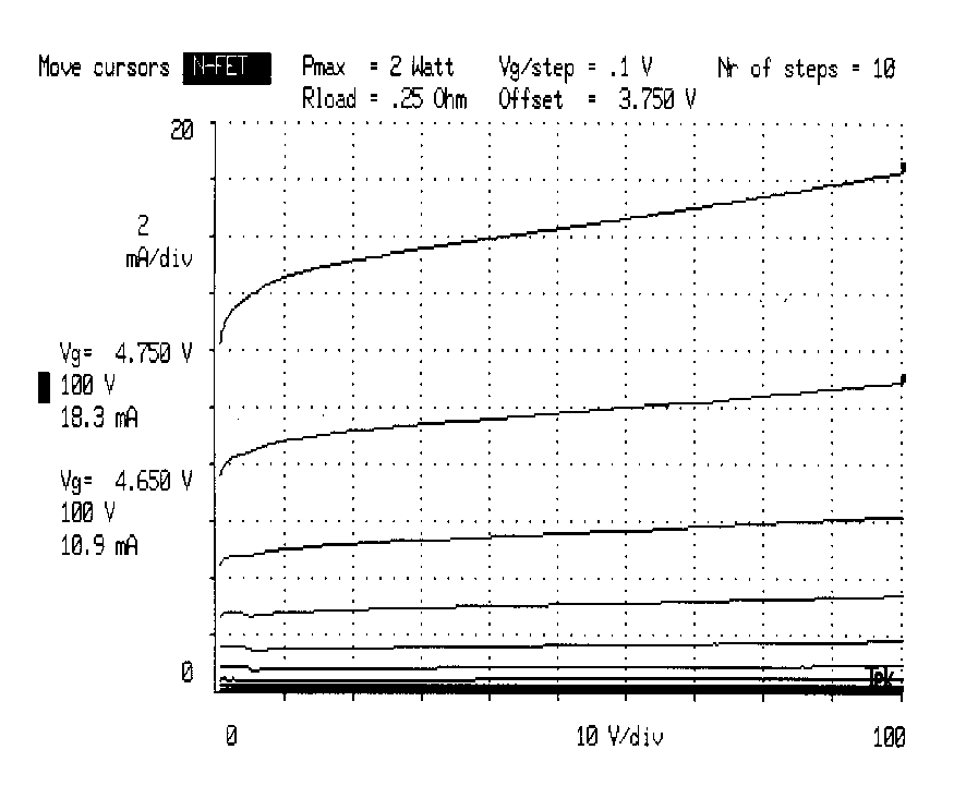

And now a set of curves at the currents we're more likely to use. Transconductance is well over 50mA/V, so a source follower using these devices will have better driving ability than any cathode follower using a single valve. At 10mA, the drain looks to be about 40k, so with 50mA/V (all WAGs), that makes mu = 2000, so there's plenty of feedback available in a source follower. My curve tracer won't go >100V, but there's a definite upward curving trend to the curves, so any source follower delivering a large voltage swing will probably want another FET wrapped around it to keep Vds constant, and a CCS load to keep gm constant.
Hey-Hey!!!,
Thanks for the FQP curves. I have the 1N60's qued up for use in the cascode PI of my amp. Triode on the bottom, MOSFET on top. If they pop there's 2N90's in my box...🙂 I think the low voltgage region in that circuit should just get labeled 'here be monsters'

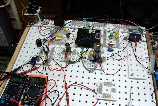

I set this amp up on my breadboard to test all sorts of screen grid experiments, but there have been several diversions along the way. Last weekend one of my power supplies blew up and I spent most of my time fixing it.
Today I decided to test out something that I have been wanting to try for 2 years. What will the typical audio tube do in A2? I have been told (by several people) that it will distort badly. I had never tried it, so I decided to test the same old 6L6 that I have been torturing for almost 2 years. The amp was tested in triode mode for its baseline performance. I set the bias for some more realistic operating conditions, 400 volts (across the tube) and 60 mA. All measurements were made with a 5K transformer into an 8 ohm load. The drive was increased until 5% distortion was reached. Power was 4.5 watts. Clipping was visible at just over 6 watts. Distortion at 1 watt was 1.9% mostly 2nd, with some 3rd, and 4th visible.
Next I added a PowerDrive circuit and fired up the amp. It was plainly obvious that A2 is not a bad thing with a 6L6GC. I was attempting to measure the peak grid current by observing the voltage drop across the grid stopper (scope in differential mode). Of course there is no drop until you get close to A2. As you approach A2 the grid current shows up in pulses. At the edge of clipping (over 10 watts!) I was seeing a distorted sine wave of 10 volts P-P across my 100 ohm grid stopper! The grid stopper was a source of nonlinearity, so it had to go. With the grid stopper eliminated, the clipping point was just over 11 watts! This was from a 6L6GC in triode. The grid voltage was swinging from -75 volts to +15 volts.
At 5 watts I was seeing 2.8% distortion, mostly second. Cranking the power up until I hit 5% brought 9.5 watts. Clipping was reached at 11.1 watts. The distortion at 1 watt was 1.1%, almost entirely second. The third was -60db. There was some 60, 120, and 180 Hz from the ground loop created by the UPS running the computer that limits the measurement floor, so the distortion was likely under 1%.
Next, I will try UL mode. Then I will try some other tubes. I may even try this out with a black plate RCA (I'll be nice to it , I promise) and a Sovtek 6L6WXT (they can take more abuse) as well as some other tube types. It would also be nice to try different load impedances.
I will get back to the screen grid experiments, but I now have removed the grid current limitation that was mentioned heavilly in the earlier posts. This was a useful diversion.
