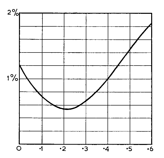

You've stirred my memory and I found a reference to UL in one of my books "High Fidelity Sound Reproduction" 2nd Ed. E Molloy (ed.) Newnes (1958).
"It will be noted from Fig. 5 that the optimum point for operation is approximately 0.2 or 20 per cent. This is applicable to KT66 valves, the optimum ratio for Mullard EL34s being 43 per cent.
An even more efficient variation of this circuit is used by the Quad II (Fig. 6). Here the common portion of the winding is inserted in the cathode, resulting in the voltage being effectively applied to the grids as negative feedback.
Fig. 5: (below) Ratio of common to total windings for an ultra-linear circuit. (Showing reduction of harmonic distortion obtained by choice of optimum tapping point for tetrode. Main feedback loop disconnected."

Optimum Transformer Zload thoughts:
I have been reviewing the data and have come to some conclusions on why an optimum transformer impedance exists (and hence an optimum %UL too) for UL (and pentode too).
If xfmr. Zload impedance is too low, then B+ and screen voltages are low, which leads to low bias voltage on grid1. Since more current is needed for the same power at low Zload, g1 headroom dissappears. So a miminum Zload exists, where g1 headroom is just sufficient to stay out of g1 grid current and distortion.
On the high xfmr. Zload end, the plate voltage swings around hugely, and plummets far below screen voltage, causing screen current distortion. See L-S & C page 70-71 figs 1A & 2A for 10K and 20K xfmrs.
Another factor affecting screen current is the %UL tapping as seen in L-S & C page 57, fig. 4. Low %UL taps prevent the screen from following the plate to minimise screen current draw when the plate voltage bottoms out. This effectively rules out %UL taps below 18.5% (impedance) or 43% turns (at least for the tube used for the graph).
Screen current distortion is obviously the main criteria limiting lower %UL and higher Zout xfmrs. Lower screen current tubes and better grid alignment might allow this balance to shift toward lower %UL. (Lower power output toward the triode mode end being the other major constraint in the optimum selection balance, due to DC screen voltage boost being lost.)
[Conclusion: Using a MOSFET screen driver with its drain current returned to the plate tap (using a floating + boost supply) should allow elimination of this screen current distortion and improve overall UL distortion noticeably, for pentodes too.]
I now suspect that matching the effective triode Zout to the xfmr Zload via %UL selection is a second order affect that just happens to be doable within the main constraint window (window from screen dist. versus power out). This matching allows an additional dip in distortion through what appears a novel mechanism. My reasoning follows:
1) The match calculated between effective triode Zout and xfmr Zload always seems to occur (for the cases analyzed so far) for the Zout occuring at the maximum signal peak when optimum %UL is being used, so is signal level dependant. (Zout varies with signal amplitude due to the Ik^(-1/3) term.)
2) Looking at the fig. 5 graphs, page 59 in L-S & C, you will notice a minimum notch in the THD curve versus input signal that can be moved over to near the max. signal (zero grid condition) by selection of higher %UL tap. This is following exactly the effective Z matching expectation versus %UL.
3) L-S & C mention on page 57-58, "overload characteristics & dist." that the output signal peaks look different in optimized UL versus pentodes, with a flat top instead of a rounded saturation.
My guess is that the Z matching is straightening out the usual curved saturation plate curve by providing better matching at the peak output versus low signal level.
If so, then this scheme should work for P-P class A triode output also. Zload = Rp instead of the more usual Zload = 5*Rp
I say P-P class A output because setting Zload = Rp makes for bad 3/2 power law current distortion in SE triode. But this is likely mainly 2nd harmonic, so it can be cancelled safely in triode class A P-P. (and it cancels out in UL mode as well) The Z match also maximises power output for triode mode.
So MY design criteria for UL would now be the following:
1) Use an XFMR Zload that is toward the lowish side, but above the minimum Zload that avoids grid1 current for the maximum pentode rated power.
As L-S & C suggest, this should occur about 10% to 25% above the optimum Zload for pentode, due to the effective drop in screen voltage in UL versus pentode (because the screen is not staying put at the DC level, needs a higher operating V, hence higher Z xfmr)
2) next calculate the %UL to get the effective triode Zout to match the xfmr Zload. [One may have to reverse this order due to the limited availibity of anything other than 43% taps. (ie. figure the optimum xfmr Zload for a 43% tap) But see below on MOSFETs.]
3) use MOSFET followers for driving the screens (primary taps used for the gate drives, or resistive dividers if no taps are available or at a suitable %) and connect the MOSFET drains to the plate taps with floating +boost supplies (to allow the MOSFETs to operate when peak plate V is below screen V). This way, screen current is returned to the plate winding and does not cause distortion.
Note: it is probably possible to come up with some bootstrap scheme using diodes and caps to make the + boost drain supplies from just plate V swing. To be continued....
Don
