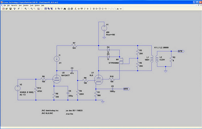

I just got home and saw two pages of new posts on this topic. I have been quietly experimenting with a technique that allows a continuously variable knob that goes from triode to pentode (variable UL percentage). I started with a circuit that bears a striking similarity to EC8010's napkin. In fact it is exactly the same.
There is a minor problem with that circuit. The plate is working into an inductive load (the OPT). Because of this the plate voltage will swing above the B+ voltage. If the pot is in any position other than pure pentode the mosfets gate will swing above the B+ voltage (the drain of the fet). This will cause extreme distortion, and possibly blowing the silicon fuse (mosfet).
There is a solution to this issue, and it involves sprinkling a little more sand into the circuit. I am including a screen shot of the schematic. This has been added into an LTspice simulation of a SimpleSE amplifier. Everything works fine in the simulation world, but I haven't had the time to build it yet.
I tend to give circuits like this dumb names like PowerDrive. I call this one VariLinear. I have LTspice simulations of the unmodified SimpleSE and a SimpleSE with VariLinear. I have another simulation that seperates the DC and AC signals in the manner shown on the napkin. I haven't found it yet. It is on my old computer. I can post these if there is any interest.
There are no potentiometers in spice, so the pot is modeled as two resistors. You can play with the values to see the effects. If the resistor values are too low they will dissipate some of your valuable output power. If they are too large they will interact with the fets capacitance to cause a phase shift at high frequencies, leading to higher order distortions (ugly).

Hi Tubelab,
Excellent point about the B+ being exceeded. I like your diode commutating solution too. I was originally thinking of just using a higher voltage source for the drain, but that would stretch the voltage rating of my 500V MOSFET to the limits. Voltage excursions for the MOSFET are likely to be a problem no matter what approach with only a 500V rating available.
One can also make a second voltage divider with a 50% divide point that splits the voltage from the drain supply to screen voltage in half. Then using two MOSFETs in series, the second one has its gate connected to the halfway point. Each MOSFET then drops half the voltage at all times. This idea can be extended to more series MOSFETs too, but two should be fine here.
Another problem for this test will be to come up with a variable range of load resistances for the tube plate. My output transformer stock here is very limited, and it might be best for this distortion spectra testing to avoid a transformer altogether. Using a bunch of power resistors could work, but will require twice the B+ supply voltage to simulate the voltage doubling of a transformer load. I have 600V available for B+. Also, it would be nice to be able to continuously vary the load resistance.
Still working on it:
There is a technique for making a variable power resistor using a MOSFET, source resistor, pot, and OP Amp. The Op amp compares the voltage on the MOSFET source current sampling resistor with an attenuated sample (using the pot) of the total voltage across the MOSFET. The Op Amp controls the gate of the MOSFET so as to maintain the pot attenuated sample of total voltage drop equal to the voltage on the source current sampling resistor. That way the total resistance is 1/(atten. ratio) times the source sampling resistor. This whole circuit has to float around at the plate voltage. This may require some effort to get debugged and stable. The Op Amp is not going to like flying around 500 V or so.
Another approach is to make a CCS for the plate that has some variable resistance across the CCS MOSFET to its gate reference voltage. (another resistor in the MOSFET source to B+ to set current) This makes the CCS current increase with voltage across the MOSFET, which looks like a resistance then. This is simpler, but does not give a perfectly linear resistance versus drain voltage swing due to the MOSFET gate drive being summed with the voltage reference. Putting an OP amp in to fix this ends up with the previous circuit. A bipolar transistor would come closer to linear due to its nearly constant 0.6V Vbe drop, but requires a lower value resistor divider from the collector (ie. 7W 100K Ohm Pot). Maybe a Darlington to reduce current drive.

Poynton: It' simply easier to do the tests on SE and the results are more easily interpreted. Distributed load was invented by Alan Blumlein.
smoking-amp: The variable resistance anode load isn't a problem at all. There's nothing to suggest that frequency affects this particular distortion in any way, so all tests can be done at 1kHz. Any output transformer is perfectly capable of accurately reflecting a 4:1 ratio of secondary loads at this centre frequency. So all you need is an adjustable dummy load...

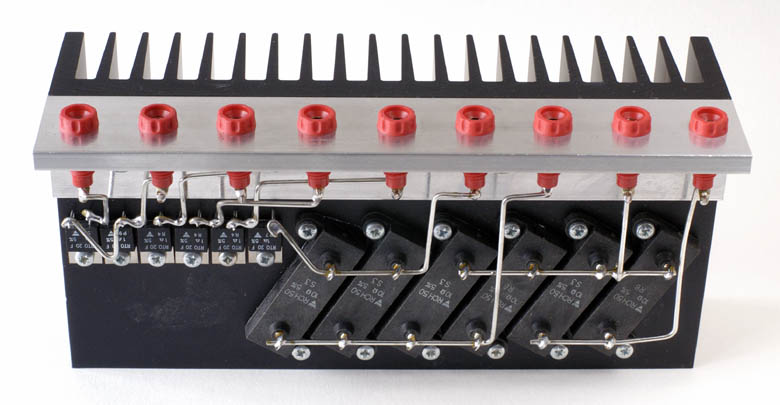

This one is made of non-inductive (essential) metal film resistors. There are three parallel pairs of 10R 50W resistors wired in series with taps at each junction. That gives, 0R, 5R, 10R, 15R. After that are four 1R 20W series resistors tapped at each junction, giving 0R, 1R, 2R, 3R, 4R. Finally, a pair of 1R 20W in parallel, to give 0.5R. The upshot is a load that's variable in 0.5 Ohm steps from 0.5 Ohm to 19.5 Ohm, with a current rating of 4.47A on all settings. You merely need two leads to go to the load, and one link lead to obtain any setting you like.

First, thanks goes to our moderator for splitting this thread out. This will eliminate some reader confusion hopefully.
I do have some ST P2NK90 900V MOSFETs on hand, fairly similar to the FQP2N90. Since we are powering the gate from an output tube in source follower mode, the ~400pF gate capacitance shouldn't be a problem. Or I can just use two FQP1N50's in series mode, 115 pf gate Cin then.
As Sy suggested, the monotonically increasing screen current with lower plate voltage swing in SE should produce mainly even harmonics. Operating P-P mode in class A will eliminate these even harmonics without generating much odd harmonic. So this is likely to explain Douglas's amplifier experience. Also there is the effect of global feedback to consider too.

progress report
I have rounded up the Edcor CXPP100-SP1 (5K OHM CT P-P) output transformer for the testing. I will use an ST P2NK90Z MOSFET for the balancing current source on the second half of the P-P primary. (so SE mode for the tube)
I have three pentodes that allow high screen voltages: 6BQ5/EL84 (it has a suppressor grid), 6HB6 (have both suppressor and beam versions), and 6L6GC (beam ). I will use an Optimos SS amplifier to amplify the sound card signal to grid1 drive levels. And I will use a 2nd ST P2NK90Z MOSFET (900V) to buffer (source follower) the g2 drive from an attenuated plate signal with separate DC level adjust. (I will use a 600V supply for the MOSFET drain supply, explained below.)
Some comments:
The screen current is not re-inserted into the UL primary tap with this adjustable %UL scheme. Hafler and Keroes' article correctly comments that re-inserting the screen current into the UL tap reduces distortion. The BEST (perfect actually) solution would be to re-insert screen current from the MOSFET drain to the plate/primary connection, but voltage levels do not cooperate on this.
(This is an area that requires some additional work for this variable %UL scheme to succeed in the longer run. I was going to use Tubelab's diode cummutation scheme for the drain connection, but later realized that this will cause abrupt distortion as the drain current switches from B+ to plate/primary connection. So some re-thinking called for on that approach. )
This all points towards the necessity of reducing the DC level on the screen to avoid this non-linear screen current capture of plate current whoes in the first place. I might also add that the usual CFB setups also suffer from screen current distortion problems, but at least they provide for easy lowering of the screen DC level to minimize this.
I will take a spectrum and scope trace of the screen current while testing, so we can see just what we are dealing with.

It just occured to me that the MOSFET follower (for the screen drive) can have its drain terminal connected to the plate/primary connection IF the DC level of the screen is reduced (from the plate DC level) slightly more than the UL% reduces the peak screen voltage swing.
Example: lets say the plate is swinging 100 to 300 V (200V DC average) and the screen UL% is 50%, so the screen will be swinging + and - 50V around its DC level. If its DC level is reduced by more than 50V below the plate DC level, then the MOSFET has some headrome to operate. Let's say DC screen set at 140V, so the screen varies 90 V to 190V. The 90V minimum staying below the 100V minimum of the plate. And the 140V max. staying below the 300V max of the plate. (In P-P the DC MOSFET current component will cancel in the xfmr.)
This scheme won't help for my present testing, since I need to check for screen operation up at plate voltage levels, but this will work for other practical variable %UL amplifiers that use output tubes with reduced screen voltage operation, like TV horizontal and vertical outputs. Ironically, their reduced screen DC level already mostly fixes the screen current distortion problem anyway, but this zeroes the effect altogether. Hi-end specs!
Hmmm...., alternatively, one could put a floating positive boost supply on the plate(s)/primary(s) to power the MOSFET drain, again a little more boost than the %UL reduces the peak screen swing. This WOULD work for my present experiment I think. Have to check this out. Got some nice Power-one 150V, 200V, & 250V linears and some similar Acopian linears setting on the shelf here. Tempting, have to check their float voltage ratings. Where's that isolation xfmr. at?
Don
