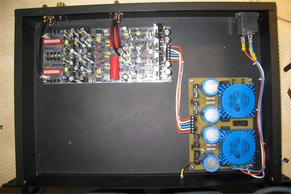

Re: Re: Re: S/N measurements
syn08 said:
Unobtanium... No wonder that kit costs (if you include all the accesories, power supply, etc...) around $2000, and you barely made it to the case 🙂
Mine costs to build end-to-end probably $300 in parts, PCB, case, etc... I could myself use a more decent case, but finding such on this continent is more difficult than sourcing SK147/SJ72.
Now I understand why you have problems with grounds: that socket with filter inside is meant for SMPS. In your case capacitors between 0, ground, and phase pollute your ground by garbage.
Re: Re: Re: Re: S/N measurements
a) In this configuration (see the grounding schematic), I have no problems with ground. Have you bothered to read the noise results?
b) What do you think is the best option for an input filter? This is what I'm currently using:
http://ecommas.tycoelectronics.com/...6pdfEnglishENG_DS_1654001_1099_EF_0406.pdf
EF1FC model.

Because if phase contains some garbage in respect to null it will be divided by capacitive divider in the filter and fed on the ground. If both phase and null have common mode garbage if will be summed by that capacitors and fed to the null. This was discussed many times in other threads. Filters designed for SMPS to comply UL and similar regulations protecting mains from a garbage the gear produces don't protect the gear, especially that uses asymmetrical ins/outs.
