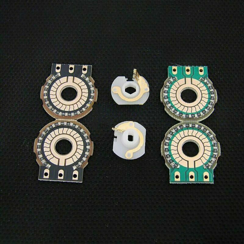

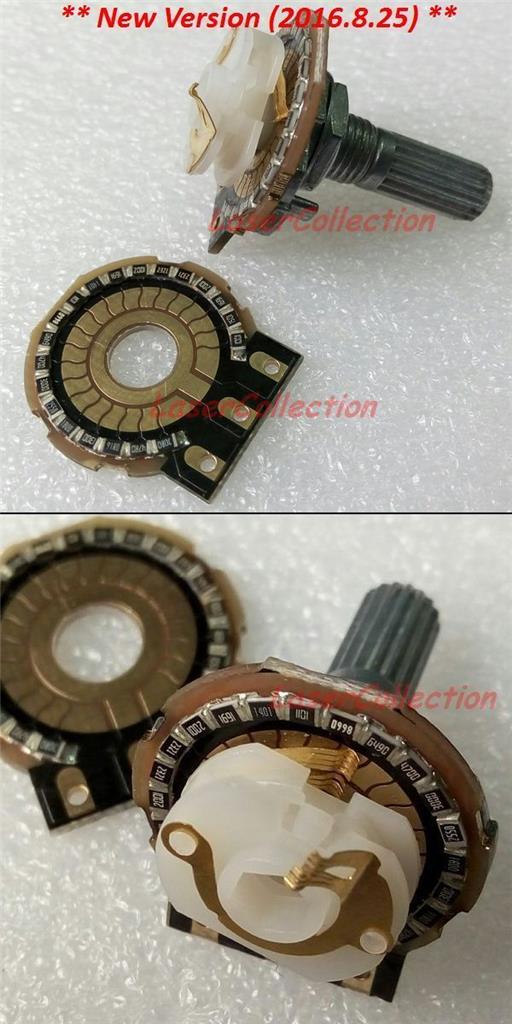

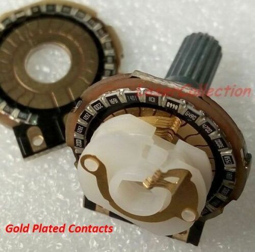

Using DACT Type SMD Stepped Attenuators I am repairing a NAD 3500 volume control. The control has dual concentric stereo stages, the front one is a 20K audio taper with a loudness tap at 5200. The balance is a 50K MN control. The following is what I have done.

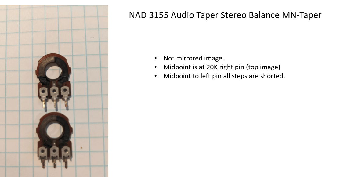

1) I had to make a MN control, so I took a 21 step SMD attenuator and removed the SMD resistors, and soldered in 4.7K SMDs up to the mid points and shorted the remaining contacts. Make sure to do the right sides (these are NOT mirror images for stereo).

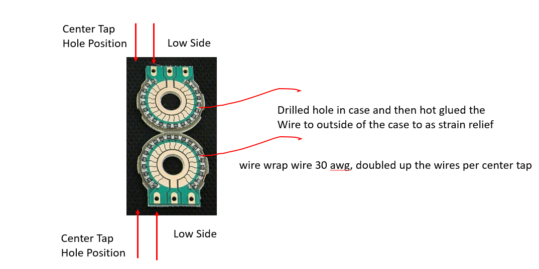

2) The 20K audio taper stepped attenuator is easy to get. I took it apart, and filed the side of the case so the center tap can come out. I used twisted wire-wrap wire to make the tap at the 5.2K step. Strain relief with some super glue.

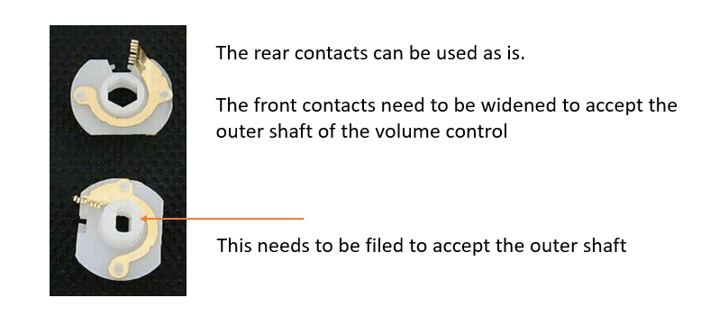

To get the concentric control to work, I need to file the front wiper to accept the outer control shaft. Tolerances are a bit close, but not to hard to do.
The only issue is I don't have detents on the unit, since the concentric shaft is too large for the detent part of the control..
To solder the surface mount parts I used low temp solder paste. I placed the part in a cast iron pan and heated it on an induction stove until the solder reflowed. A little solder paste goes a long way, and the parts will self align if you get them close to being in position.

I hope you took some pictures!

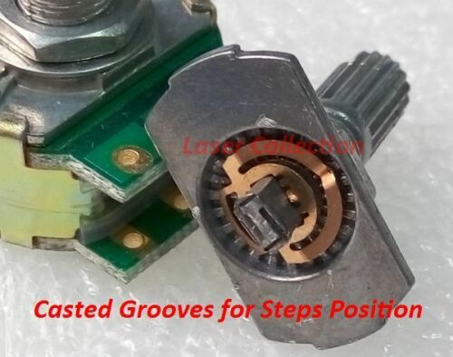

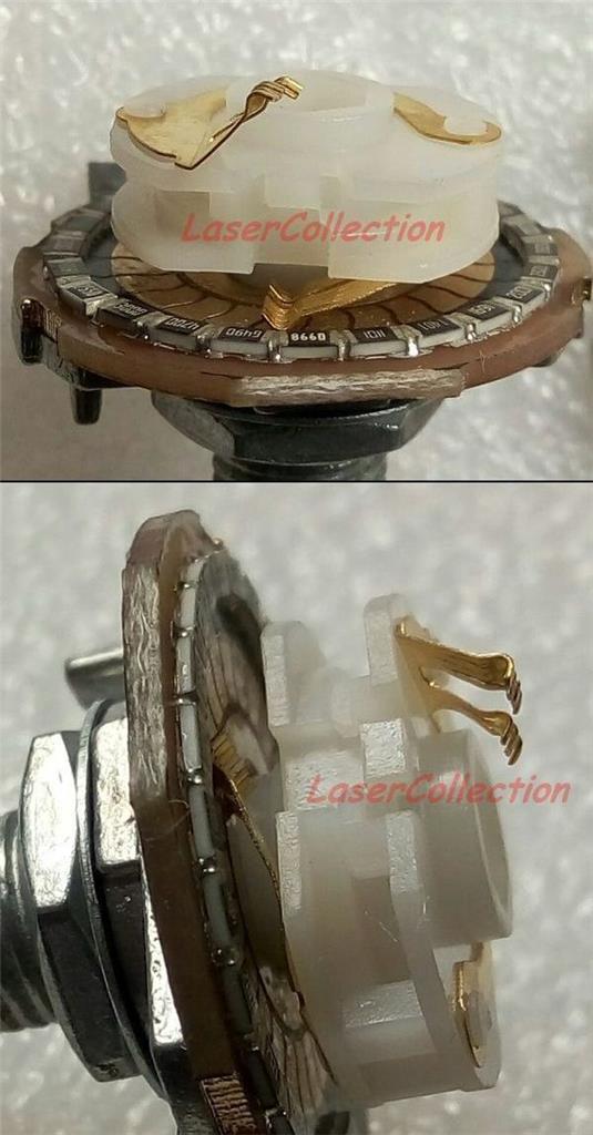

We're looking at one of these, right?

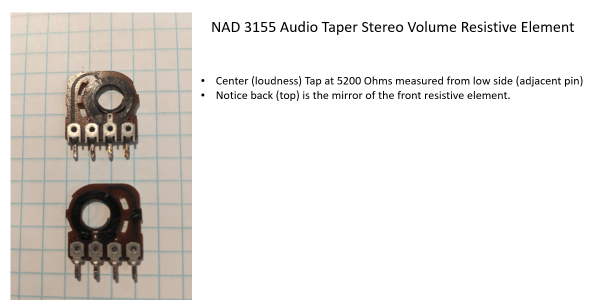

Yes, these are the units. The detents I refer to are in the face plate, attached to the shaft with a copper spring shown in the third photo above. Since the unit I have is a concentric shaft( dual control ) I had to change the shaft and thus the face plate ( loosing the detents), but the control still works fine. I will post photos tomorrow.
Finally got the modified smd stepped attenuators installed. I didn't want to post updates before testing. Sounds like new (I did a recap before breaking and having to rebuild the volume control).
I think this is the solution for rebuilding broken multistage loudness tapped units. I post details based on measurements of the original resistive units.
I will also post some resources for the mechanicals for dual concentric controls if you need to harvest them. I reused the mechanicals from the original NAD controls and modified the stepped attenuators to make it fit.

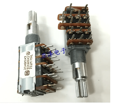

First, I reused the mechanicals from the original unit, but this unit (AliExpress) has mechanicals which will work. Removing the rear switch and moving the tapped section to the front works in the NAD 3155, but it is not to spec. So used the approach documented here in.
