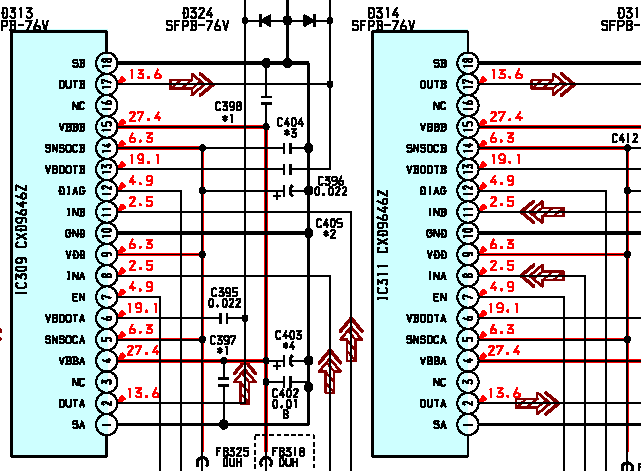

I hesitated during the last 14 years to do this project because on my receiver's schematic (Sony STR-DG500), I could not see the obvious location where I could tap into a low level analog signal path to create the new pre-outs.
So back in 2006, I simply created pseudo pre-outs for my external power amps by putting a voltage divider across the receiver’s speaker outputs with a 100 ohm power resistor substituting for the speakers no longer connected there.
But in recent years, my receiver’s right channel speaker output which was driving the pseudo pre-out was getting flaky, losing about 10 db. compared to the left channel.
So I decided that if I created a real internal pre-out, then I could bypass the bad receiver power amp. Yesterday I discovered on the web how someone else succeeded with a Sony STR-DN1050, so tried the same approach.
After installing the new pre-outs, I learned the hard way that it wasn't the receiver’s right channel power amp that was faulty, but the decoupling capacitor connecting the input selector processing chip to the input of the receiver’s right channel power amp.
Since my new pre-out tap was attached to the downstream side of this faulty cap, my new right channel pre-out was just as flaky as the previous right channel pseudo pre-out.
Fortunately, all I needed to do was place a new decoupling cap in parallel with the old one. I didn’t actually remove the original 4.7 ufd bad cap since it was too much work to remove the main PCB without removing 5 other boards stuck in the way.
My only problem with these new pre-outs which are driven directly off the DSP chip is that the full signal strength is about 100 mv. instead of the preferred line-out voltage of 1 v.

Here is part of the schematic from the Sony STR-DG500 service manual showing where I tapped into the two audio signals feeding the UPC2581 pre-driver chip. In all, I made 3 taps for the 3 pre-outs that I needed, for Left, Right, and Center channels.
