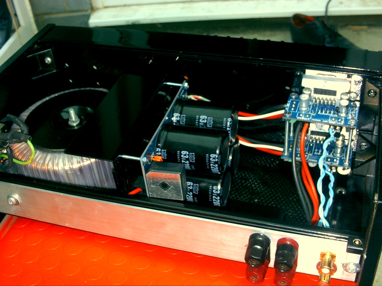

They suggest 4 x 10,000 uf caps for the power supply board but I had an opportunity to buy bigger ones - so I did - 4 x 22,000 uf.
The bridge rectifier was rated at 35 amps @ 1000 volts so - what the hell.
It's fantastic in the bass, the mid and hf.
You can use whatever quality you can afford - look at the original Gaincard
picture attached to see what that means - 😉
( other one is my first effort with the bigger caps )
You'll know if it was good idea as soon as you listen to it - or not

I beefed up the caps in the power supply of a chipamp I built from salvage- I ripped the whole power amp board out of a fubared unit and grafted it into an integrated amp. Doubling the capaticance (to merely 10,000 uF per rail ) made a very significant difference in the bass "punch" delivered by the amp- it made the difference. This was with the original large but inefficient and hot running transformer, and the original rectifiers.
It is a concern that bigger caps can destroy or shorten the service life of the rectifiers, but that is easily rectified too (pun intended😛). If you look at the data sheet on a typical rectifier, you will see that the peak instantaneous current is at least a magnitude of 10 greater than the service rating. You must take into consideration the transformer used too; if it's a wimpy, old technology transformer, your rectifiers will probably be safe. If it's a really beefy unit, it's a good idea to upgrade the rectifiers anyway.

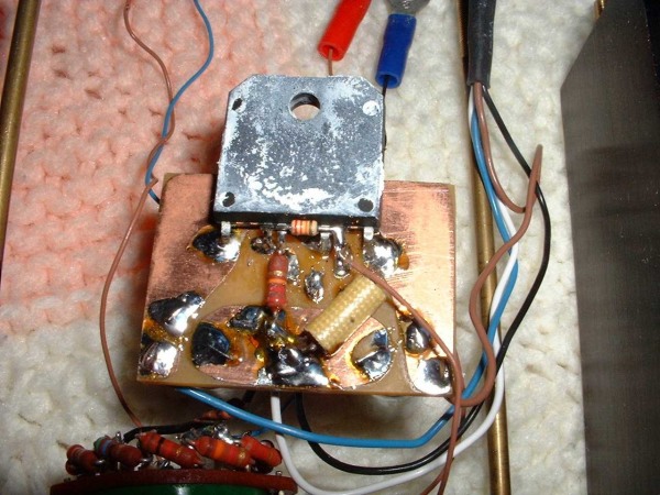

I've built a few of Peter's LM3875 kits and found I preferred it with the 1500uF caps on the power supply PCB (replaces the 10uF) and installed 100uF Elna Cerafines on the amp PCB near the chip. If you look at Peter's commercial amps, it uses this arrangement. See the pic for the caps on the amp PCB that were changed.
I did try a snubbered power supply but seemed to lose some character in the mids and as well as had an odd tonal balance..... over blown maybe.
For lower impedance speakers I found lower voltage power supplies using a 18VAC-0-18VAC transformer works well but you do lose power (but gain current).
