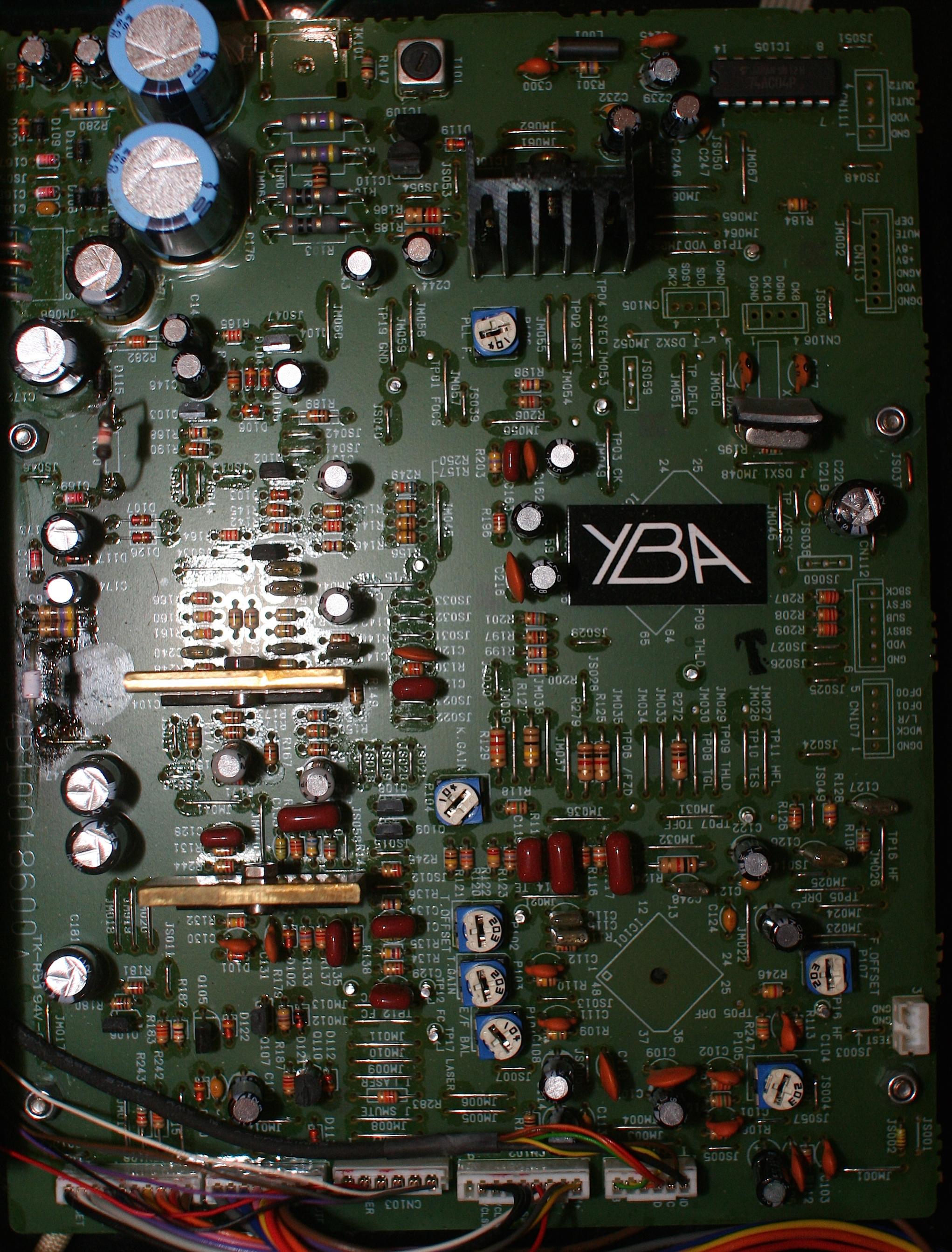

I browsed the French forums a bit to gather more about the YBA players. From the picture, yours is a CD3, right ? The manufacturer is very secretive about what's inside, the dac are supposedly 18bits "custom modified". Doesn't help much...
I wish it were a CD3 but that was too expensive at the time. Mine is a Lecteur CD and it is easily upgradeable to a CD1 / CD2 by adding an external power supply. I bought it before I was into DIY, nowadays I could readily tackle the design and build of an external power supply so I could also do an upgrade. However, the top of the case is hard to remove, the screws holding it on are a proprietary design and I have nothing suitable to remove them. They look like Torx screws with a centre-pin and I read on the internet that there is a way to get them out so I may try.
Those are security torx and there are bits available for them.
e.g. Set 9 security(pinned)Torx screwdriver bits 25mm long | eBay

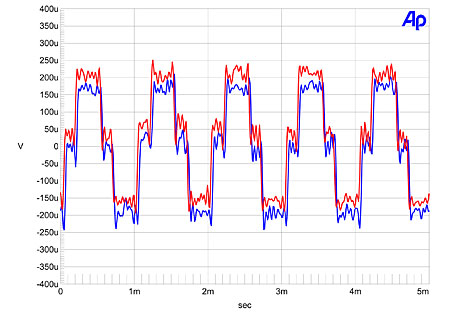

Hi ... my biggest problem with digital is to accept that this is a sinewave - needless to say that i do not like its shape at all mainly because it hardly resembles the input waveform.
Just that ...
taken from here
Abbingdon Music Research DP-777 D/A processor Measurements | Stereophile.com
regards, gino
Just that ...
taken from here
regards, gino

As dmills points out, that's a sinewave about 3dB above the broadband noise floor. I'd be more concerned about fig21 in that test suite myself which shows only 2dB or (at a pinch) 3dB suppression of the images of the IMD test tones above 22kHz

That plot is with an input 90dB down on full scale in a unit running in 16 bit mode....
Of course it is in the noise floor, where would you expect it to be?
Regards, Dan

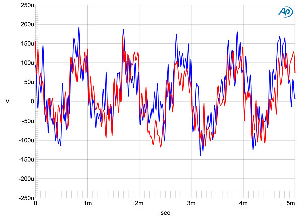

Hi well i have seen better shapes just that. Like this one ... not perfect but better
http://www.stereophile.com/images/archivesart/509Camfig06.jpg
I understand that is very low level by the way.
regards, gino

<edit> That second waveform you've posted is going to be coming from a DAC with a much lower noise floor than the first. Probably not a 16bit DAC. Which review is it from incidentally?
If that is measured at the analogue output then somebodies dither or reconstruction filter is very, very broken.
I would guess 16 bits, undithered @ -90dBFs or so, undithered quantisers are broken pretty much by definition.
The first plot is actually likely to be better, as it at least shows evidence of noise shaped dither.
Regards, Dan.
this one here Cambridge Audio Azur DacMagic D/A converter Measurements | Stereophile.com
