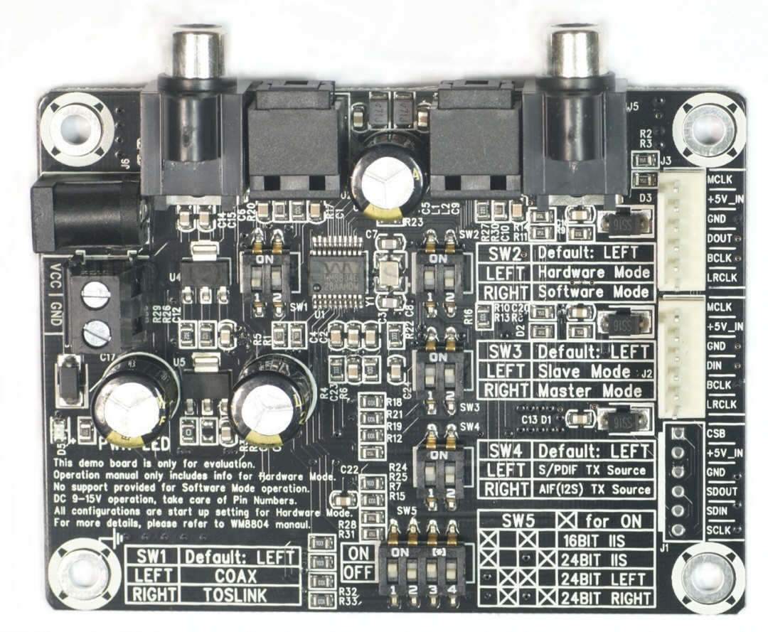

What about instead the Wolfson 8742 ? is it in the same league of the 8740 ?
The wm8740-1-2 are clearly in the same league and probably indistinguishable.

The wm8740-1-2 are clearly in the same league and probably indistinguishable. The suggestion for the arcam was simply that they're pretty well built, the analog output stage is very decent and they're sold for a fraction of their original price, especially when the transport is dead. If you already own a cambridge dac100 though, not sure I'd bother modding a cdp.

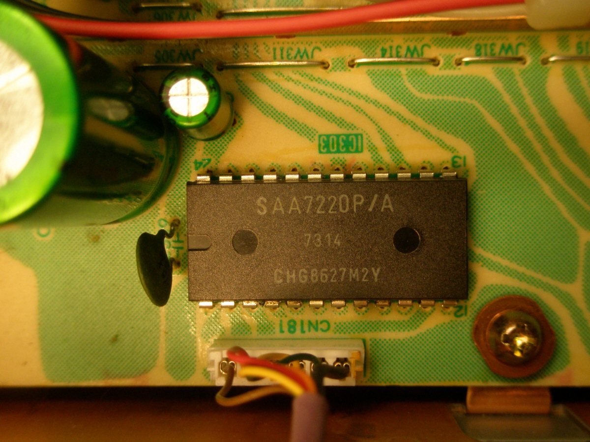

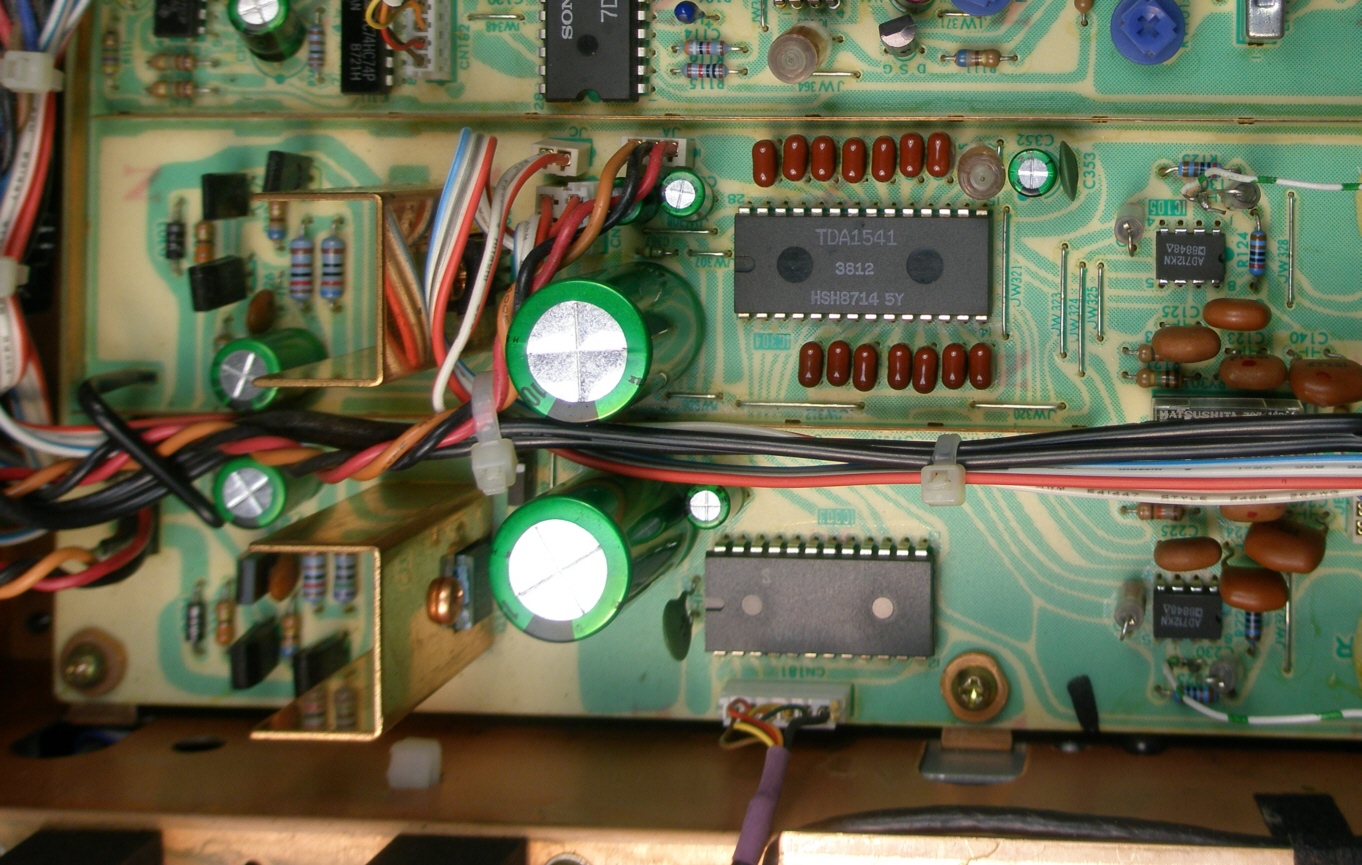

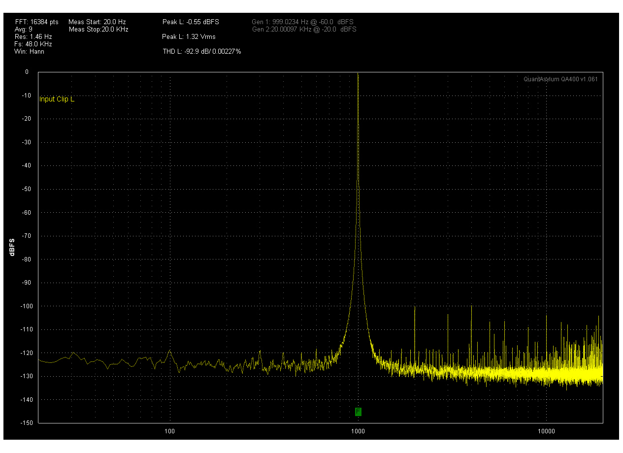

I tried something like that, by taking a Sony DAT-s DAC board with the TDA1541 and the SAA7220 with I2S input and connect it to a SPDIF to I2S converter ,from ebay. It worked fine. I'm one of the lucky ones who only can hear differences between discs, not so much between DAC-s. I made some measurements and they looking fine to.
I browsed the French forums a bit to gather more about the YBA players. From the picture, yours is a CD3, right ? The manufacturer is very secretive about what's inside, the dac are supposedly 18bits "custom modified". Doesn't help much...My reason is simple - my CD player, with good CDs of course, sounds simply amazing so I assume the internal DAC is to my taste. If I could use it as an external DAC for audio tracks off my computer it would increase the usefulness of the CD player as I rarely buy CDs but do plan to buy more on-line. I have no expectations that YBA will ever release a service manual to me though.
One solution which could work if the internal protocol is I2S could be to use an I2S multiplexer fed from either the signal coming from the cdp drive board or from a digital receiver of your choice followed by a src4192. Clock the asrc from a local clock. That would allow choosing one or the other input.
