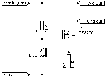

@Elvee, i'm Happy to see that we are on the same page. Granted LM317 seams a better ideea that it's big brother, but anything will be used it will require a fuse rated so as it will blow at shorted ouptut cus in that case the reg will dissipate a great deal of power, so if let say the Vin is 24Vcc and the limmit at 2A that means over 48W of power will be dissipated by the regulator prior to overtemp prot comes in, if ther fuse is well rated than it will blow up as soone as the output will be shorted, and the fuse holder can be a pannel one so it can bea easy replaced, this way the unit is well protected but still as you say, it is not a verry good ideea to abuse it...
Another saolution could be this in the attachement, the current limit is the same with overload as with shorted output, there will be a few tens of volt drop on the series pass resistor depending on the load current but i think it can be worth it in many cases, the only real vdrop will be at current limmit when the voltage delivered to the load will drop in order to maintain the current, the limmit is verry precise and with a sturdy mosfet there should not be any problems, i luv IRF3205, especially it's Rds-on but the T220 case not so much... something in T247 case with as littl Rds as possible could be the answear in many cases.
PS: Agreed, LM317 only seams the best solutios here, but there can be sutiatuations in witch this CCG could be usefull.

That is indeed a possible solution, much better than trying to meddle with the regulator itself.
To make it completely transparent, it should be placed upstream of the regulator, and to make it safe, a 12V zener should be added between the gate and source of the MOS.

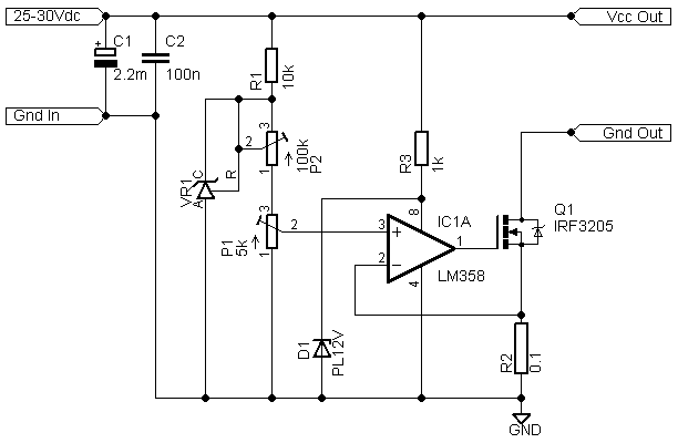

Good ideea, in fact here is an Iadj variant, this config permits precission current adjusting, or it can be set just above 2A in witch case it will not interfeer with voltage regulation untill after the treshold has been reached, an ahmmetter wired across the shunt can show the load current.
That variant will mostly probably have stability issues: when you throw the gain and phase shift of an opamp into the game, compensation is almost always required. Better to keeps things simple and predictable.
