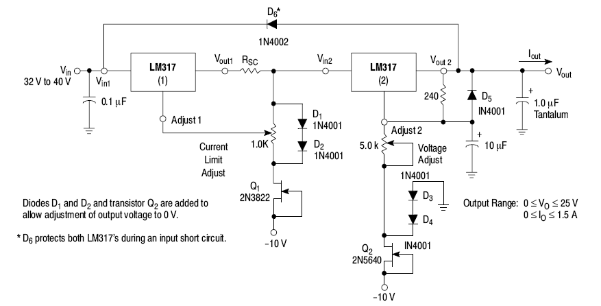

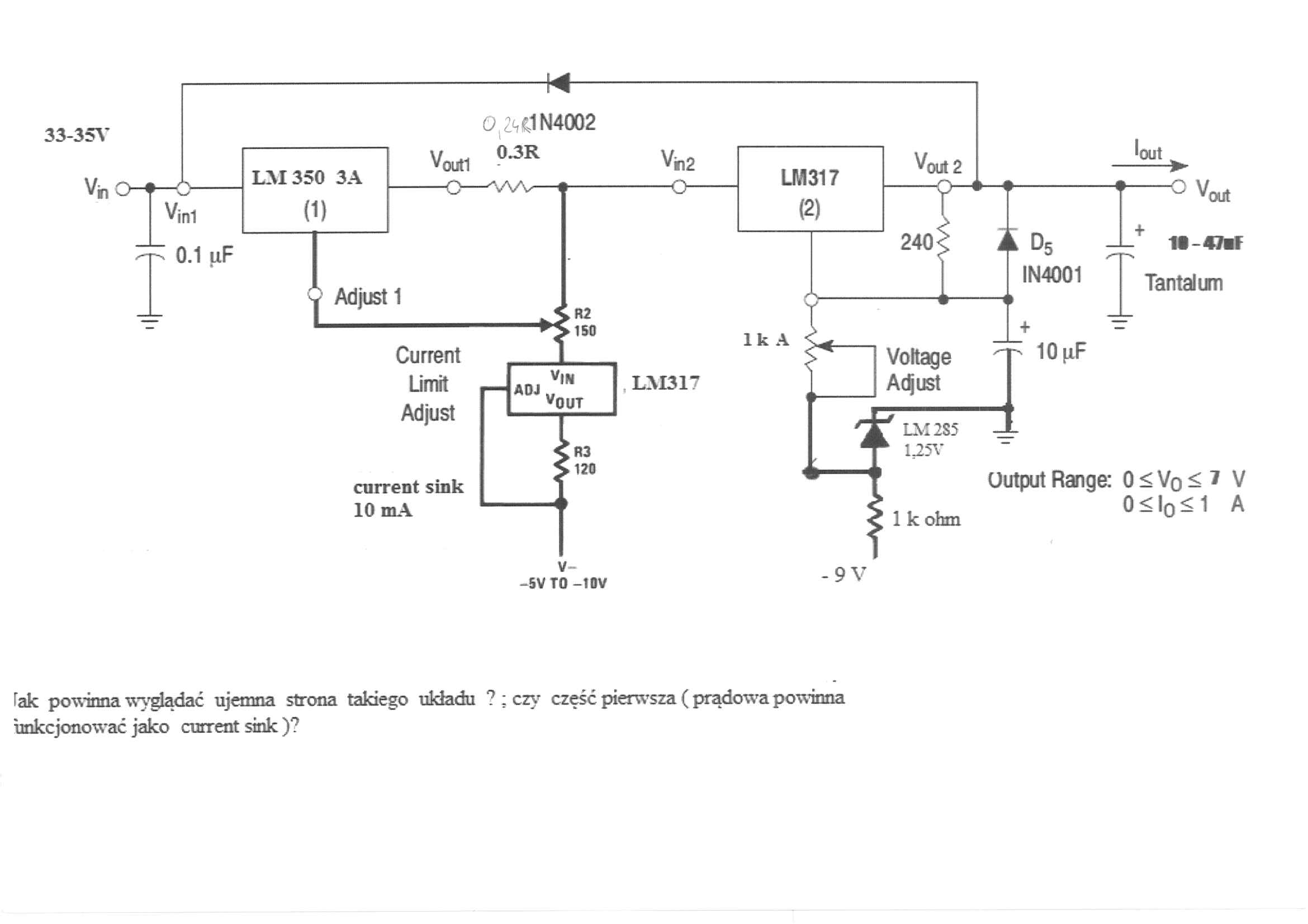

adding current limiting to a power supply
@Elvee you seem to enjoy contradicting me just for the fun of it...
Initial load regulation is 0.1%. If you add 0.33 ohm in the output, this will be degraded to more than 10% for a 5V output. I don't think a degradation by a factor 100 is negligible.
ANY active current limiting would imply a shunt resistor and so a voltage drop on it, but it is small enough so you are not worryed, and for the life of me i cannot understand what is souch a BIG issue few tens of volts drop? the author did not mention the exact purpose of the supply, but as i sayd mV preccision and preccision current limmiting is not likely to happen with thys tipe of regulator.
ANY decent regulator includes this resistor in the feedback loop, making it completely transparent. That is the case with the LM338 for example.

Anyone opposed to just installing a panel ammeter?🙂
Engineering is often a study in compromise (OK, maybe not so much with engineers) and the OP has been given a plethora of options. I suppose he can pick his poison.
thanks sofaspud and everyone else. at this moment i'm not sure exactly which route i will take but between everyone's posts i've got quite a number of possible solutions.
@dietnews there are litteraly loads and loads of ways to go, linear or switching, you first have to make sure what you need the most, what you want the unit to be used for, do you need preccision voltage regulation, preccision current limmiting, low ripple and/or noise line... make up your mind exactly what you want and what compromise you would be able to make, then it will be werry easy to choose the way to go.
That worst case scenario of voltage regulation less precission would be at the minimum Vout/max Iout, i doubt this unit will power something that sensitive... for real performance lab power supply a much more powerfull transformer is rerquired along with much more complex regs... this unit i think it is just good enough for general testing. As for that 4A, that will only be at shorted output, witch u do not seam to get it that this circuit is not intended, a 2A fuse along with this circuit will make sure nothing bad will happen with it, the regulator will be able to witstand the stress for those few seconds untill the fuse blows up as for the power transformer, well, if a 50/60Hz transformer blows up at the first shorted output then the hell with it, it's not wort anything.
So thing is either you do not see, don't want too see that you are just looking for problems where they are not... as i sayd, this cind of behaviour it is sad...
Depends on the meaning of "precision" and "safe": in this case, a worst case error of 50%, and a current that can reach ~4A.
There is also the unresolved issue of loop stability in the current limit mode.

Didn't I tell you the OP can current limit it to *any* value he wants?🙄
Loop stability in the current limit?
Don't worry about that , all these regulators are *designed* to be able to be current limited.
No designer worth his salt will release an unstable design.
