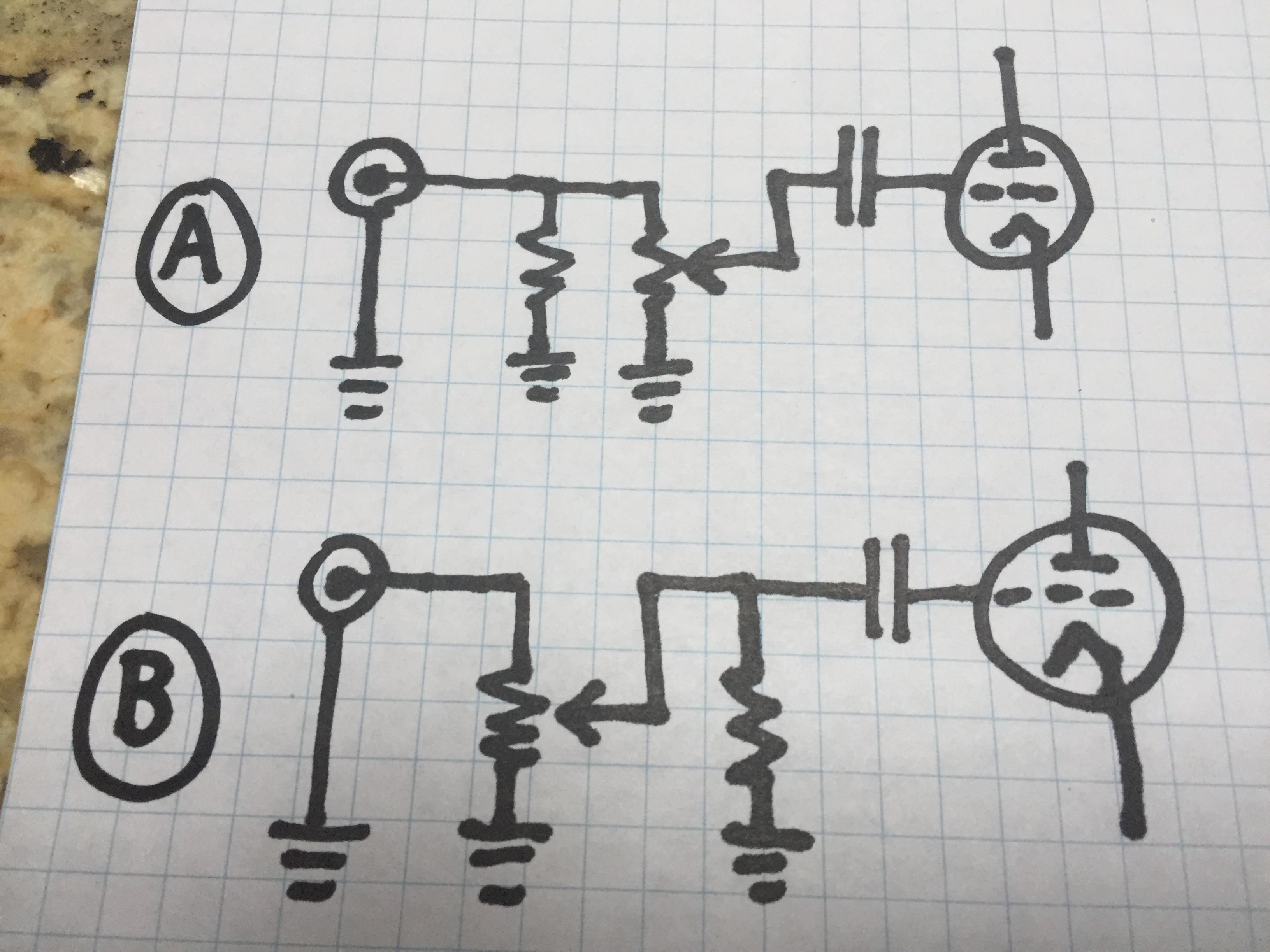

Hi Folks.
A friend asked me to add a volume pot to an amp his father built many years ago. I don't have a schematic for it, but basically it is a single ended stereo amp with a 6SL7 as the driver and 2X 6L6 as the power tubes, one per channel. He wants to be able to use it with a CD player that does not have a variable out. I have a 100K Alps pot I would like to use, and a 50K and a 250K in pots of lesser quality. My main concern is what to do with the resistor that goes from the input to ground. It has a value of 220K. Do I leave this resistor, and put the pot after it and then put the output of the pot to the grid of the driver tube? Do I attach the pot to the input and then put the 220K resistor from the output of the pot to ground and then hook up to the grid? Do I remove the 220K resistor to ground and replace it with the pot? What is the purpose of this resistor? I have built amps with resistors in series between input and grid, and with the normal volume pot set up, but this is new to me. Any advice would be appreciated.

The cap is a coupling cap, with low signal voltage and almost no DC voltage, so any decent film cap will do. It is necessary if you want the volume pot to have a long and happy life.
The signal cap. to be added will probably not be exposed to DC. "Run in" might be problematic. With that info. in mind, I suggest you use a polystyrene film part. The amp's I/P resistor is 220 Kohms and a 0.15 μF. part will avoid phase shifts inside the audio band.
Full compliance with the 1:10 rule requires the resistance of the pot. to be <= 22 Kohms. A commercial CDP will drive the IHF "standard" of 10 Kohms. So, I suggest your friend acquire a 10 Kohm PEC of Canada hot molded carbon control.
So, use the 100K pot with a 470K resistor? Or should I use the 100K pot with a 1 meg resistor? I don't understand the function of the resistor. I have built amps that have a 100K pot and a 1K resistor in series (a Decware SE84CS clone), just the 100K pot by itself (Alex Gendrano KT88), and one where I added a 100K pot to an existing 1meg to ground at the input (RH84 Rev2). None that I've built had a capacitor before the grid of the driver tube. A brief explanation would be greatly appreciated.
I am confused. Is it A or B?

The capacitor prevents grid current from travelling across the wiper-track interface. Any DC current here can lead to noise developing eventually. Omit the cap and the thing will work fine for a few years, so most circuits omit it.
Am I right to assume this has a lot to do with "static-y" noise on old pots in cheap radios? I haven't seen many coupling caps in the input from pot to grid.
I built mine without it. 300 ohm grid stopper right into the 100k pot. If I understand properly this will lead to an early pot failure?
Thanks.
Lots of circuits omit the capacitor. Lots of circuits end up with noisy pots. All pots go noisy eventually, but pots with DC across the wiper-track interface tend to go noisy earlier. By 'earlier' I mean years rather than decades; if you frequently change your gear then this would not be a problem, but I am of the generation which expects things to last.
