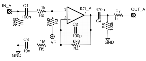

Adding a (variable) gain boost to this non-inverting opamp buffer circuit?

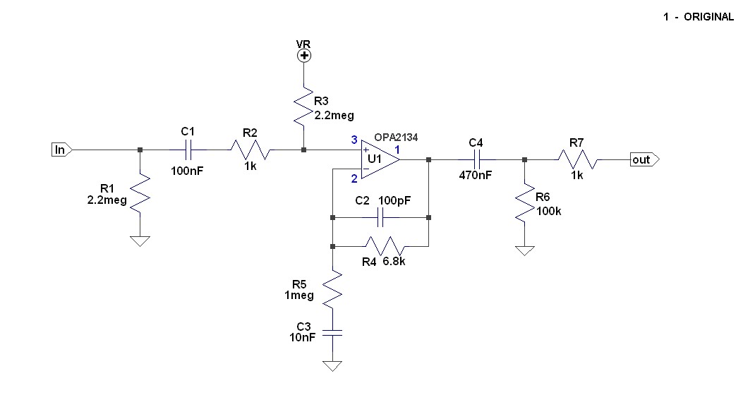

You're the second person to suggest dropping R5/R12 from 1 mOhm to 100K. What is the rationale for this?
I don't know if it matters, but keep in mind the buffer is for receiving high input impedance signals (guitar pickups).
Bear in mind that the feedback circuit is part of the op amp, it's made exterior so gain will be adjustable.
This means, among other things, that the feedback circuit has nothing to do with the input circuit, or input impedance (Zin). You have:
Input circuit ~> op amp ~> output circuit. All different circuits.
(these might or might not be connected together in some way, but they're still different)
That this is used with guitar pickups matter a lot, because you want a very high Zin such as one-half or one meg. Ordinarily you'd see a Zin of something like maybe 10-50k.
The + input handles the high impedance part. The - input is for setting the gain, and is best at lower impedances for better hf response.
You don't want a bipolar op amp with this high impedance circuit. Even 1M for R11 is a much higher value than most would use there.

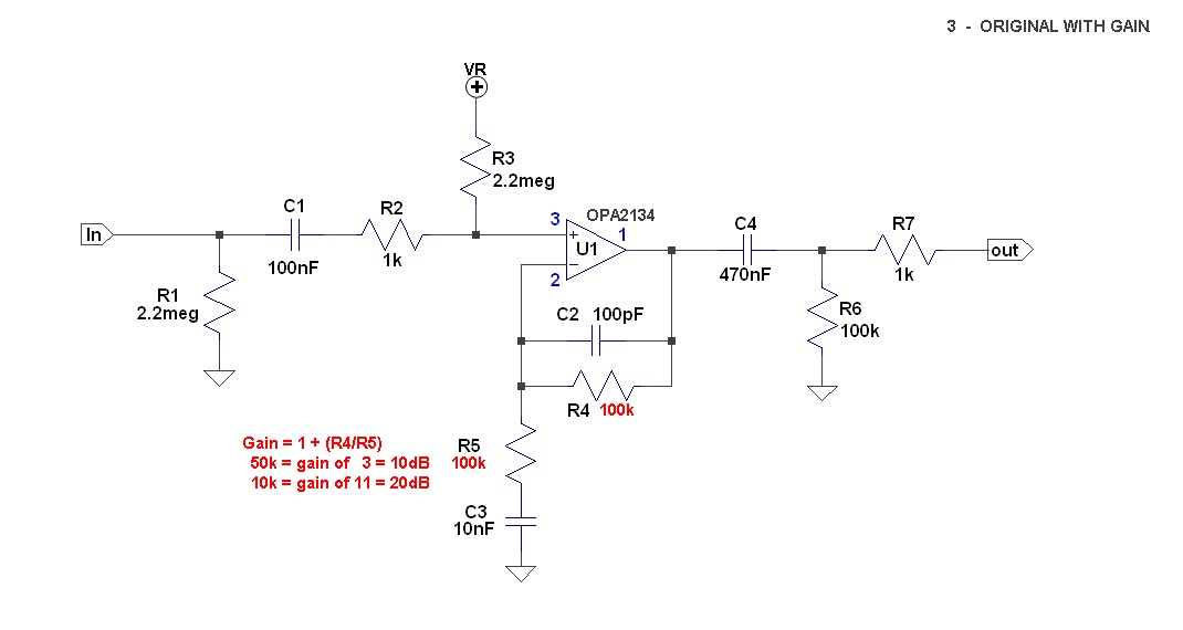

Okay. FYI, if it matters I'm planning on using OPA2134 opamps (it's a dual channel board like pictured in OP and I'm using both channels).
So you're saying using too high a value for R4/R11 (feedback resistor) will compromise the high frequency performance of the opamp?
So I could then set R4/R11 at 100K (feedback), and R5/R12 (to ground) become ~47K.
On the other hand, what happens if I drop R5/R12 too low? Ie. Is there any performance loss with going down from 1M vs. 50K?
Signal to noise is more important for me that too much high frequency perfection if that plays a role.
Only R4 and R5 affect--control--gain.
The purpose of C7 is twofold.
1. Some capacitor of some size is always needed in that location to block DC in a single-supply circuit, which this is.
2. It restricts DC gain to unity. The DC that's of concern is just errors that every op amp has.
However, the value of 10nF is small, really small. Does this thing have any bass at all? Suspecting no.
You're talking about C3 (10 nF) which is the capacitor to ground. If I'm changing that ground resistor I'll have to change that too I know. I'm wondering about the 100 pF C7 in parallel across the feedback resistor.

That op amp should be ok in this case.
The R5 or R12 and the caps set the lf rolloff. Usually you want it around 1-10Hz.
If R5=50k, then for 10Hz bandwidth, C3=1/(2*3.14*10*50k) or 0.33uF.
For 1Hz, it's 3.3uF.

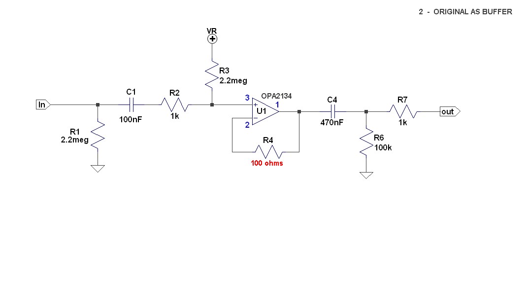

Still I'm bemused about what R3 and R10 are connected to.
The circuit isn't sensible for purpose, i.e. a guitar buffer.

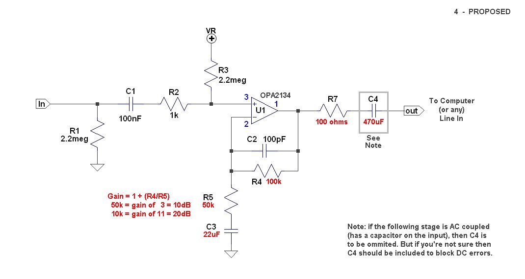

Due to being easily amused I've redrawn the circuit from post #37 in a more conventional way. Also posted a proposed circuit with some of the suggested changes made. This might help, might not, I dunno.
Still one problem remains. How is the thing powered? Assuming R3 to be one-half of a voltage divider (albeit misapplied), where's the other half? Or is R3 actually supposed to go to ground? Maybe something I don't know about? More I dunno.
PS it seems there's little point in using an OPA2134 as a buffer, since it has ridiculously high Zin (input impedance) to begin with.

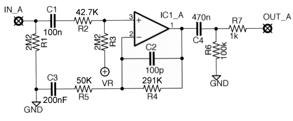

I think I understand what you mean. I assume you mean the bias resistor won't be matched if there is an adjustable feedback resistance pot. So that won't work. Agreed. Fixed gain it is.
I've edited the schematic with all the changes I'm thinking of.
I've got 291K feedback resistor R4, 50K resistor R5 to ground (gives 16.7 dB gain). I set the bias resistor at the positive input of the opamp R2 to the parallel resistance of these two other resistors, which comes to 42.7K.
Ground capacitor C3 I set at 200 nF to filter at 16 hz.
Is this a reasonable design? Anything else that should be changed?
Thanks everyone. Getting there. 🙂
