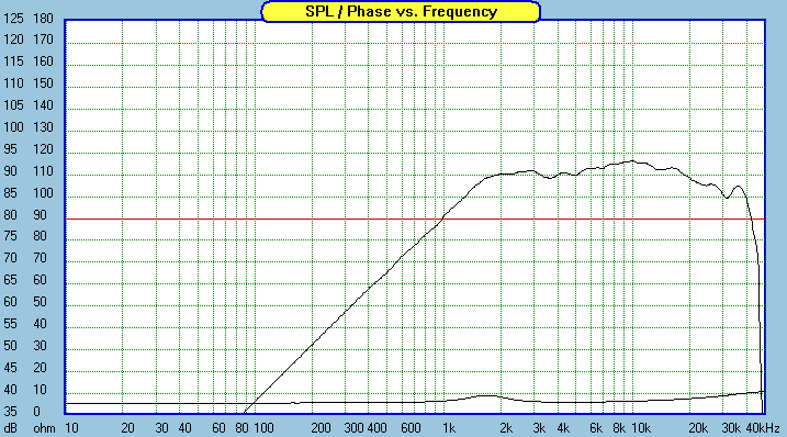

Thanks again Dave and Sreten. That was well explained. I think I may buy the Dayton's. They are cheap and are pretty small. And now I have a bit more info, I can at least experiment now and roughly know what to expect when inserting different values of resistors and caps.
On second thoughts, Dayton ND20FB-4 or the CSS ERT26? I'm leaning towards the Dayton's
Make sure you can mount the Dayton properly.
rgds, sreten.
In fact the easier flush mounting version Dayton_ND20FA-6 (6 ohm) :
Dayton Audio ND20FA-6 3/4" Neodymium Dome Tweeter 275-030
Looks like it would suit the capacitor only approach much better for a 10KHz x/o.
(Noting a normal 10KHz x/o is -3dB @10KHz, designing for 20KHz is -9dB @ 10KHz.)
Its peak at 10KHz means you'll get a defined roll off at that point with whatever
capacitor value you choose for relative attenuation, probably the best option.
rgds, sreten.
Interesting. Never saw the ND20FA-6 when looking for a tweeter. The mounting will not be a problem of either of these tweeters, so the question now is, which one would be better? Has anyone have any experience with these?
Thanks again
Thanks again
My opinion is the flush mount will be better if 10KHz is the right
x/o point and you simply want to adjust the series capacitor
to effectively set the level of the supertweeter, not the x/o.
Its a minimalist approach. It will be flatter than the
rearmount just using a single series capacitor.
The rear mount is superbly flat, its more flexible, but more
complicated to use in some respects, but gives more options.
Me ? I think I'd go for KISS, and take it from there.
rgds, sreten.
rgds, sreten.
