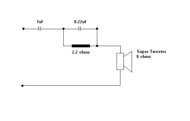

Favorite Hi Tweeter Crossover
Here's an example of my favorite crossover to use on a high tweeter or additional tweeter. It keeps the harshness of voices out of the tweeter, but also raises the end of the response curve some, where the tweeter starts to roll off.
I used this crossover to add some 2 inch 8-ohm tweeters to a pair of speakers each with a pair of 2 inch HiVi A2S Fullrange Aluminum cone drivers in them. Each HiVi A2S Fullrange was 8 ohms, so 4 ohms total with parallel per speaker. I added the 8 ohm tweeter only to help where the A2S rolls off at 15khz, and also since the HiVi speakers are low efficiency, the louder tweeter being crossed so high in frequency made them blend right in without being too quiet to hear them, but not too loud to drown out the speakers either. They were VERY transparent, it made the Full Rangers seem to appear to be producing the upper highs, when it's really the tweeters.

I would consider mounting a second tweeter on the back. It would give an extra 6dB and great spatial sound.
