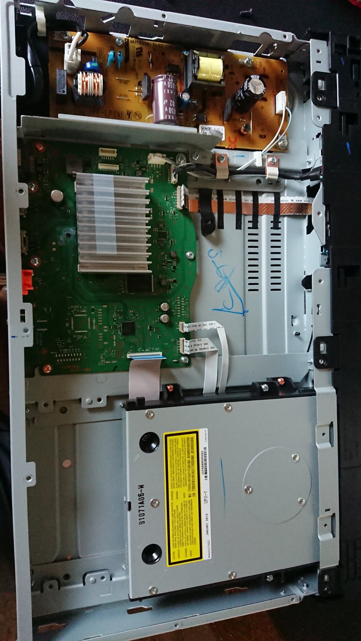

Anyway, looking at this pic from the other thread...
If this is the board you have, then you can try with the power off, measuring resistance from the white wire to ground, and from the gray wire to ground (the ground screw at the lower left).
With the power on you can also try measuring volts between the gray and while wires. The Red (V+) lead of the meter will read a positive voltage if the red lead is more positive than the black lead (COM). If the red lead is less positive than the black lead then the meter will measure a negative value. From that you can figure out which power supply wire is + and which is -, what the actual voltage is, and if either power supply wire is connected to what looks like its a chassis ground screw (which you can check with your ohmmeter function by measuring resistance from the screw to another point on the chassis).

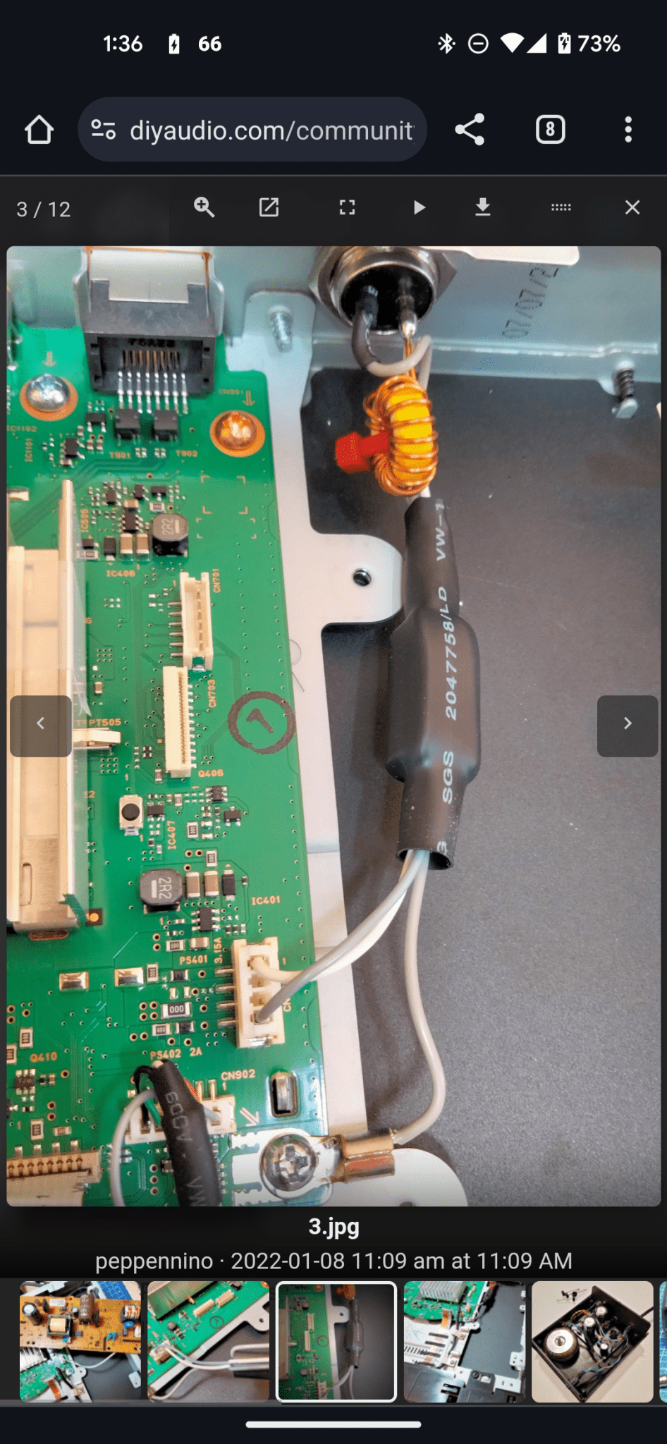

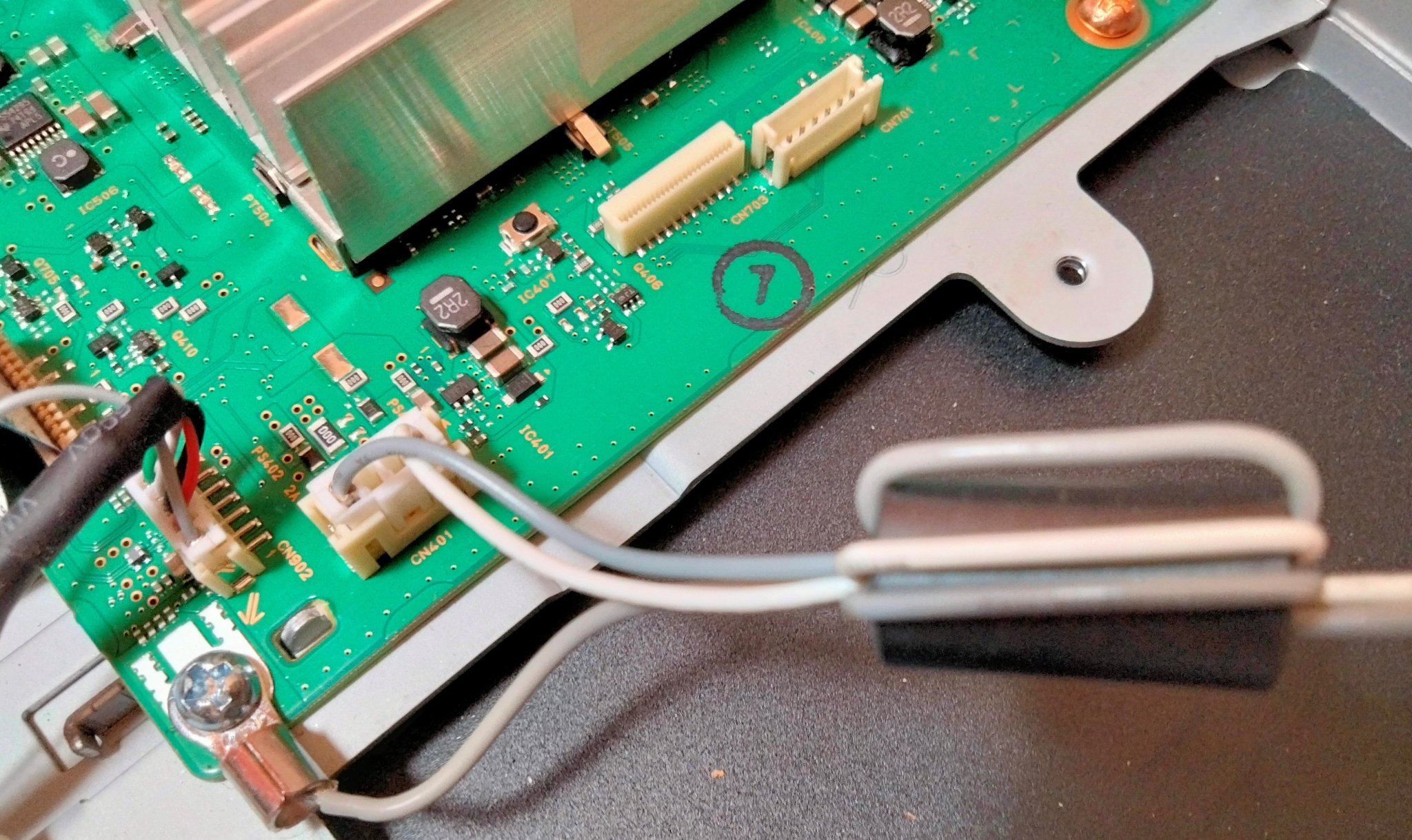

I finally figured out how the original guy wired it up. The grey (positive) goes from mb directly to the gx16 positive. There are two white wires which are grounds. One goes from mb to the choke then to the gx16 negative. The other ground goes from the mb screw directly to the gx16 negative.
Now my question is why have two grounding points? If it's better why and how?

Not clear if 'gx16' refers to the existing power supply?
Regarding the term 'ground' we have to be careful about what we mean by it. There is Earth ground, AC power line ground, chassis ground, etc. There is also often a common node in a circuit we refer to as ground.
It means I need to understand what you mean by saying there are two white wires that are grounds. Do you mean they form a ground loop? Do you mean the both connect to the chassis? Regarding the white wire that goes through in choke, does the gray wire also go through the same choke? If two wires go though the choke, do they both wrap around it the same number of turns?
The best way to understand what is going on is to draw a schematic that shows all those things. Schematics are often much easier to analyze that pics.
In order to draw a schematic is may be necessary to ring out the wiring with a meter, and or examine it visually. For one thing, I don' know if you have determine that white wire going into the connector on the MB is grounded at the other end, or where? I don't know if its only ground through the screw in the corner of the circuit board? I don't know if the screw in the corner of the circuit board connects to the white wire in the connector in the circuit board or not?
All the above sorts of things need to be clearly understood to make sense. So what to do is turn off the power, remove the power plug from the MB, remove the white wire and the screw in the corner of the board, then start measuring ohms to chassis ground. Is anything still connected to chassis ground, the MB, any of the wires, etc. If the wires are connected to ground at their other ends, then trace out where.
To emphasize again: Once you have clearly understood the all of the grounding circuit, then best to sketch a schematic of it which includes showing every point at which wires are connected to the chassis and or AC line ground.
