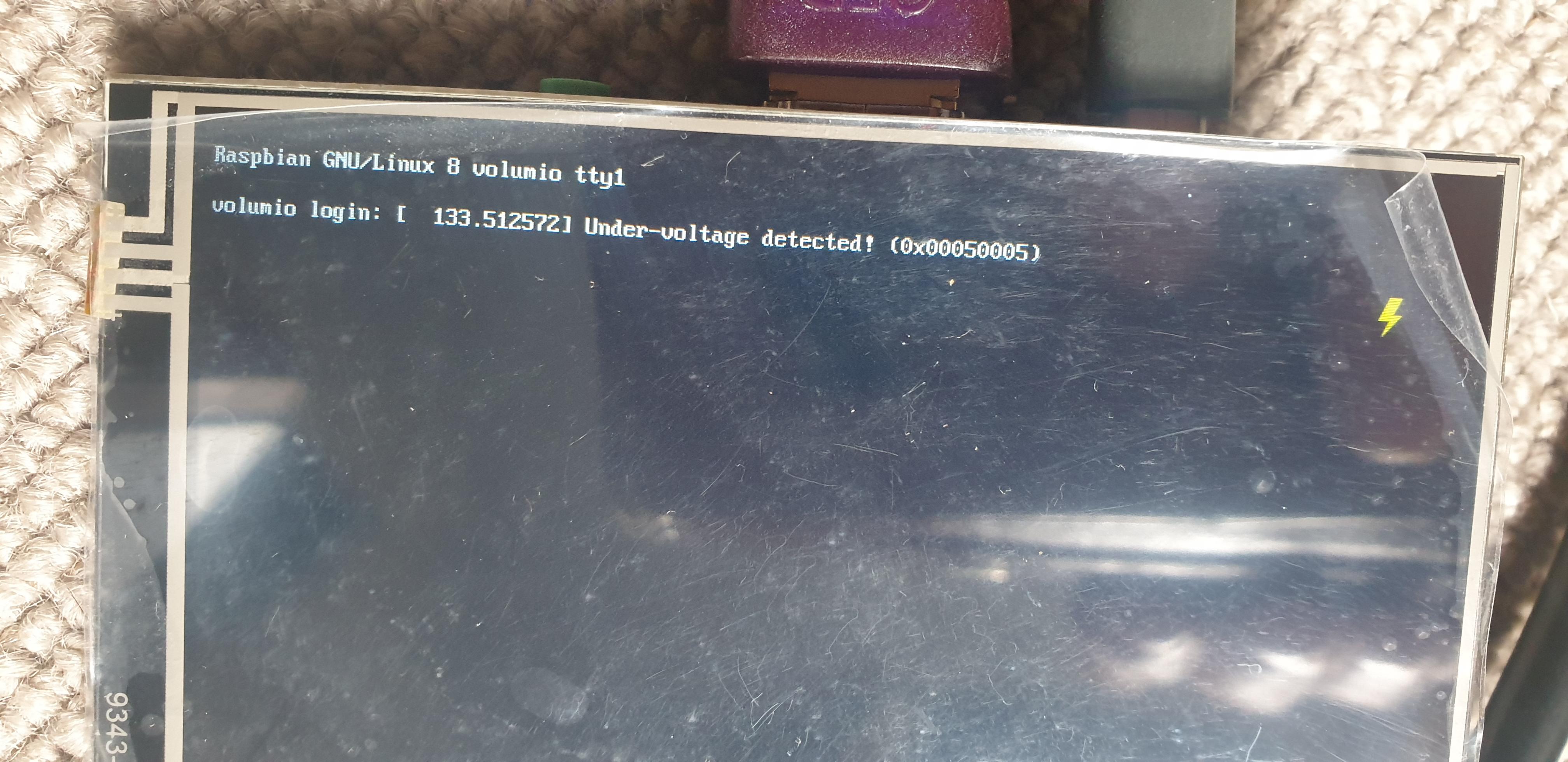

So a bit of progress but something not quite there yet.
I installed those lines into the Volumio SD card...been using Moode for a while. I forgot how nice Volumio looks with thr album art etc.
So when it all booted up I saw the 'VOLUMIO' branding across the screen....looking hopeful! But when it settles in and playing music it has this screen.
attachment.php
Any further advice for me....seems so close!
You're almost there! It's a long while since I've been anywhere near Volumio, but I think there's a plugin you need to install and launch, perhaps the 'Touch' plugin?
You are literally one step away from having it working...
EDIT: Here's the plugin, called Touch Display:
Volumio Plugins Collection - #3 by chsims1 - Plugins - Volumio
Well that didn't work! Even less showing than before! Don't even have the Volumio boot logo now or that other screen i attached before. It just cycles between blank black and blue.
Hhmm!
