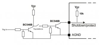

I got an ICE Power 1000ASP module all hooked up and running but I do not understand how to connect a 3.5mm 12volt trigger to it. I’m trying to get the amplifier to go into a standby mode triggered by my HT Pre.
The ICE Power modules already have this feature implemented however I cannot understand how to connect the 3.5mm 12volt trigger to it.
I have attached a diagram from the B&O manual of how the 12volt trigger is supposed to be connected to the module, could someone please translate it to me into lamers terms and help me get it working.
Your help is very much appreciated, thank you.

The circuit shown (whose external components I assume you have to add) will put the amp into shutdown when the "Control signal" has sufficient positive voltage applied. This would be the opposite of what you want in a 12v triggering setup (if i understand it correctly). To get a circuit that will default to shutdown/protect and then go active with a constant 12v applied, you could put another pull-down circuit in front of the one shown (that is, replicate R1,R2,BC546B,10k and put it in front of the circuit shown.) Such a circuit would *require* an applied voltage to get out of standby, so a switch might be needed to enable/disable the trigger circuit.
BTW, hooking your 12V trigger straight up to the standby/protect pin (without the pull-down circuit in the manual) might seem to work, but could potentially prevent the amp from activating the protection circuit (during power-up/down ,over-temperature, or over-current conditions).

If the voltage at the standby pin in 12V, that means that the external circuit shown in the manual is NOT there. You must construct an external circuit to drive the standby pin. (Now someone with more experience with the ICE POWER module might say something like "just connect the trigger to the standby pin through a 5k? ohm resistor, it works fine and won't break anything", but without a threshold voltage spec or knowledge of the detection circuit this is impossible for me to say.) The complexity is that you have to share this pin with the internal shutdown protection circuitry, so you must play nice with it.
I have no hands-on with that particular equipment, but I think I understand the requirements. Without the external circuit, the shutdown pin is pulled high. The BC546B transistor is used as a switch to pull the pin low and enable standby mode. You want to enable standby mode via a trigger from your HT Pre. What trigger signal do you have coming from the HT Pre? Since the transistor is used only as a switch, other types can be used, so it seems to me it makes sense to match it with the signal sent from the HT Pre.

Hi, thank you for this but I am not exactly sure how the Trig would enable the switch you got in your diagram?
The way i follow your diagram is as follows: the Trig would deliver a 12volt signal, the first resistor would reduce the current a lot, then the transistor would amplify the signal again? or switch the Vcc signal on? (Vcc signal is 12 volts as well btw). then the current would be reduced again by the next resistor and come to the next transistor where it would be applified and supplied to the Suspend pin?

OK. thune understood from the get-go. I don't suppose you can change the HT Pre trigger so it is 0V when on and 12V when off? Because somewhere that signal needs to be inverted. That's what his circuit does. Neither transistor is used to amplify; they are just switches. Either on or off. And the Vcc in his circuit is a dedicated voltage, ie it is always supplied. So that when the first transistor is on, the second is off. And vice-versa.
I'd like a second opinion for the idea that what may work for you is a normally closed reed relay. Without the trigger the relay pulls the standby pin low, and with the trigger the opened relay disables standby.
Or configure the manual schematic to use a PNP transistor.

If you have 12 volt DC when the pre is on, where is the problem to use a relay? You prevent all kind of trouble like ground noise and have no galvanic connection to the amp.
Cheap as well and build on a small universal PCB,together with pull down resistor, solid and reliable.

So would something like this work:
DC5/12V 1 Channel Relay Module Opto Isolated board for Arduino and MCU projects | eBay
; with the following connections on the relay:
+ COM: GND from amp (Pin 6 on P2 Connector)
+ NC: Standby/protect (Pin 2 on P2 Connector)
+ CH1: Positive from 12VDC remote trigger on preamp
+ VERF: Negative (ground) from 12VDC remote trigger on preamp
+ DC+: Positive from external constant 12VDC supply
+ DC-: Negative from external constant 12VDC supply
: and no other components in the signal path (between relay and amp on the COM and/or NC connections)? The idea being that the Standby and GND pins are shorted ("pulled to ground"?) when the relay is NOT triggered by the 12VDC from the preamp.
