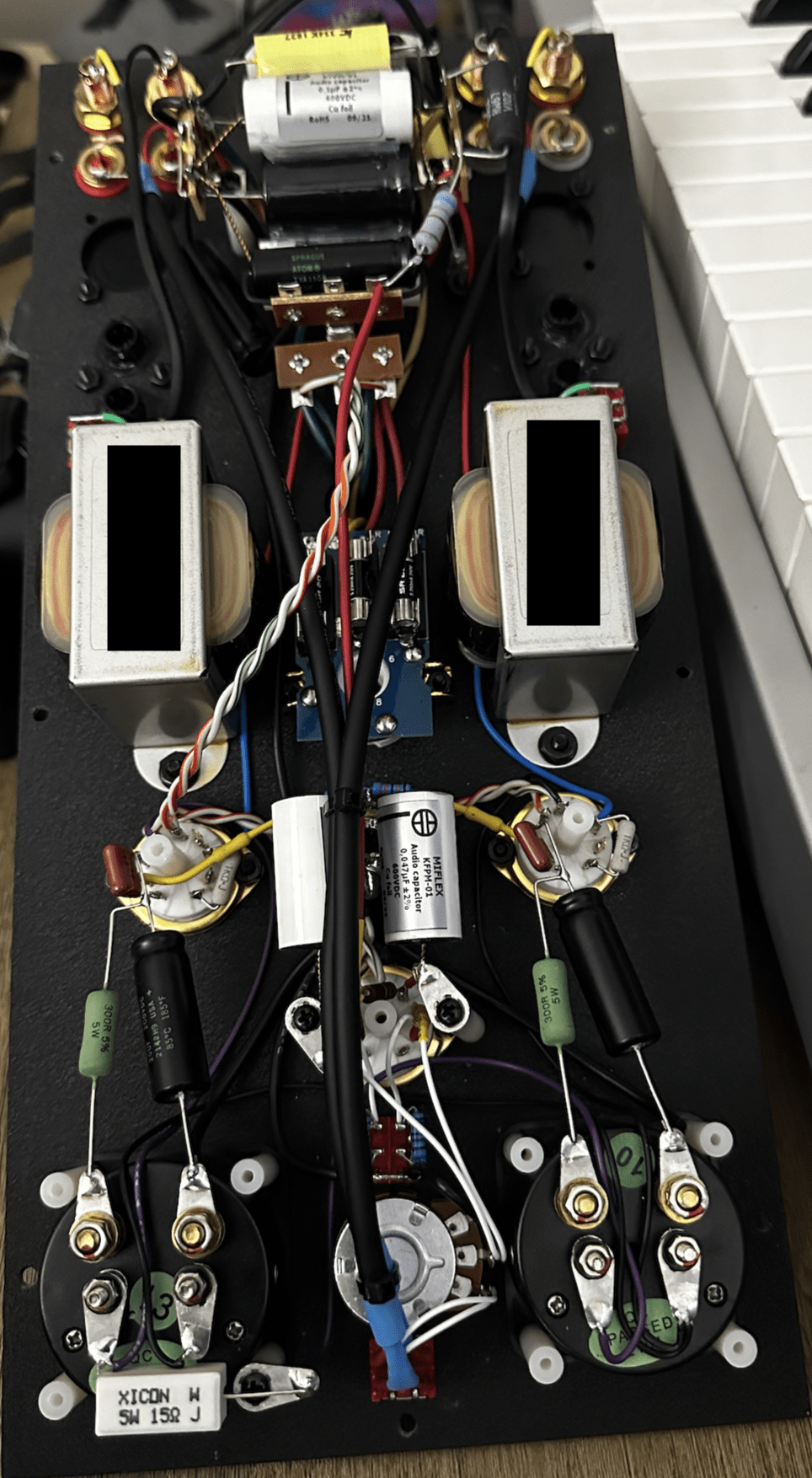

Is it possible to ask the manufacturer/designer? Since it is not DIY, the presumption is that many units of such layout/construction are successful. If the amp is new to you, perhaps some builder built it differently than the "usual" ways? Just asking. trobbins is always rock-solid, it's just that perhaps everyone reading would likely approach different things to figure out what's happening. Just one free opinion, but my sense is that there are fundamental (routing/layout) things to fix before considering application of an external choke with nice wire. I know you said it's 120, but I'm seeing a lot of inductively coupled stuff in there, shielded or not, large current next to small signal, etc. I think you need to disconnect things, jumper things, measure, etc. to find the causality of the inputs-shorted hum. FWIW. Are there other support forums for your specific product, maybe, that you might inquire on?

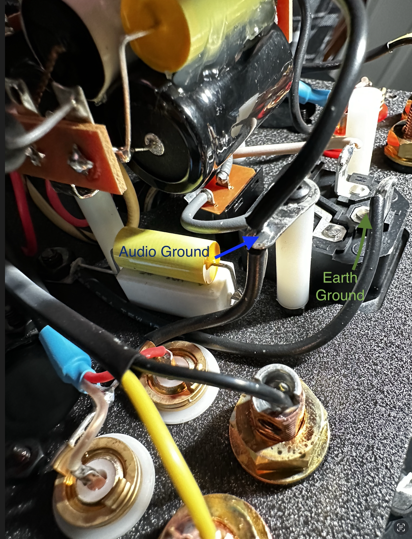

The 'audio ground take off' is the black wire running just above the yellow cap in the photo. The other end of that wire is connected to a 10 ohm resistor and capacitor in parallel, then the other side of those are connected to the ground (earth) of the socket where the power cord plugs into. I will work on a schematic of the rest of the amp. Did you see the schematic that I posted initially, of just the power supply?
The black wire in the photo below, starting just to the right of the 'audio ground' is the 'take off', it connects to the node in the previous photo, at the negative terminal of the first filter caps.

Different names mean different things to different people, so well worth trying to clarify imho. Your first schematic does not show the actual node connection layout of the 0V bus, only a simplified schematic representation. The 'audio ground take off' is also described as the link between mains/chassis earth and the 0V bus, even though that link has an RC network in it.
I doubt that the chassis-to-0V link is a significant issue to your hum concern, but like all things, the devil may be in the detail and suggesting mods or tests is best done with a good appreciation of exactly what you have.

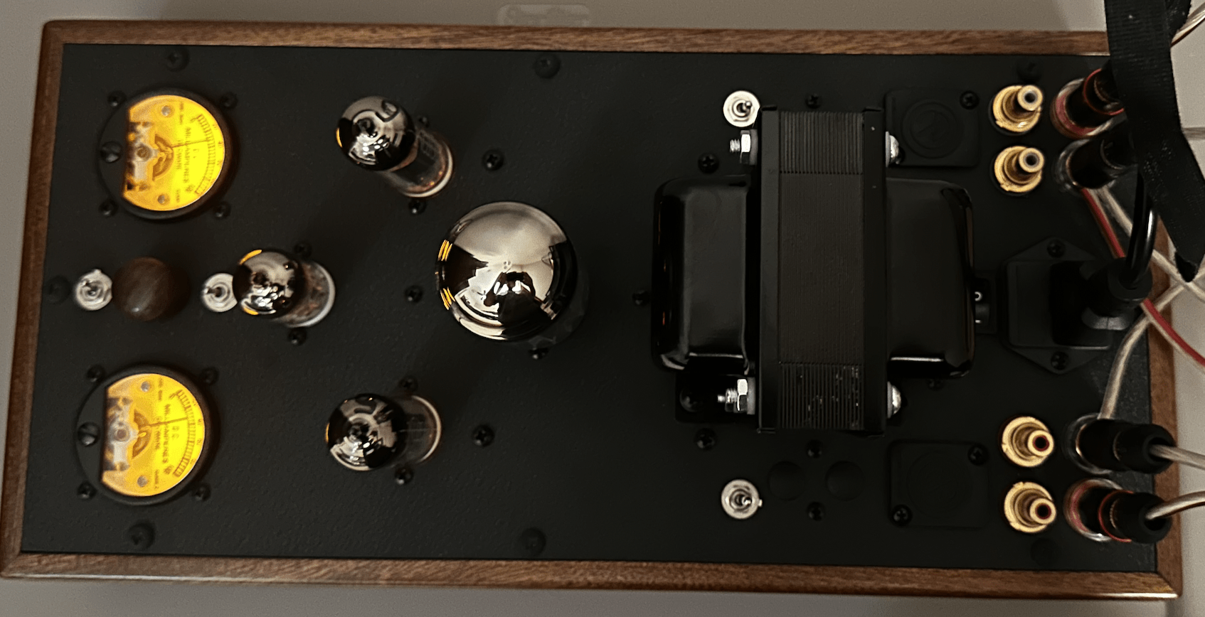

Where is the power transformer located? I think I can see input jacks next to the AC power jack. The layout does not appear to be ideal.
Also, would have been better to use more filter capacitance rather than the film bypass capacitors. You can probably squeeze in more electrolytic capacitors if you removed the film capacitors.
The power transformer is located near the back of the amp. I have attached a couple of photos for clarification.

The location of the input jacks, next to the AC power and power transformer is not a good arrangement. It would have been better if they were located at the other end of the amplifier. I guess some people wouldn't like the look, but it wouldn't bother me.
