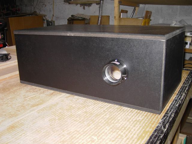

Right now I am finishing up a horizontal folded model with a 10.6" panel in it.
