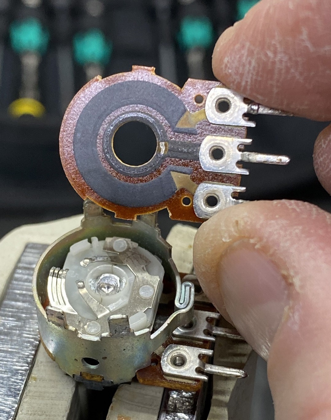

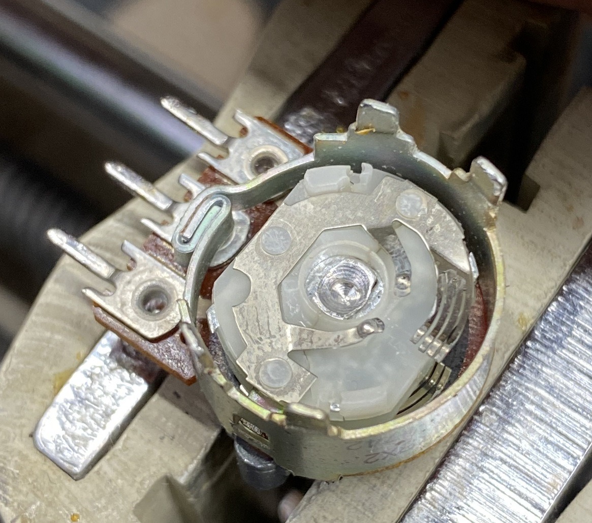

Looking for recommendations on sourcing a replacement potentiometer for Adcom GFP-565 Treble pot VR203 which is a 4tr 1742 20k bx2
Symptom = Left channel treble adjustment has no effect. Right channel works as expected.
I used my meter and measured the pot. It is open on the left channel. I tried some Deoxit but that didn't help at all.
Thanks for your consideration and advice.
-Steve
Just going to have to find a dual 20K, linear (B) taper pot. that will fit or you can "kludge" in there. Personally, I would remove it, disassemble, and repair the existing pot.
If it's a conductive carbon pot, get the Deoxit out of there.
Dan
Following up. I took Dan's advice, removed and worked on the potentiometer today. First time I have taken a pot apart, but it went smoothly. The springs for the left channel were weak so I adjusted them and cleaned everything with contact cleaner before reassembling. Success! Now the treble works well on both channels. Thanks Dan 👍
