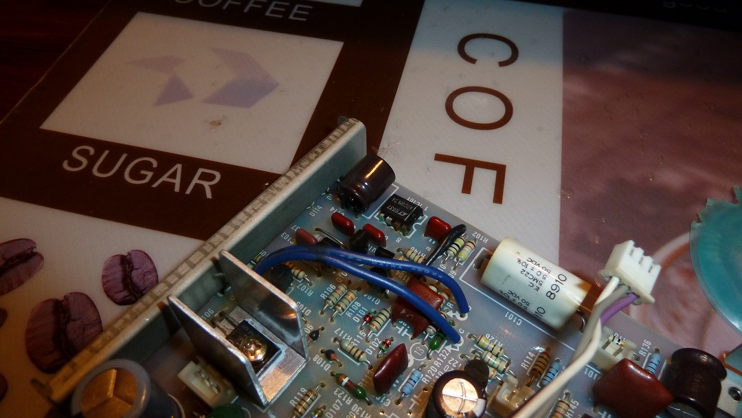

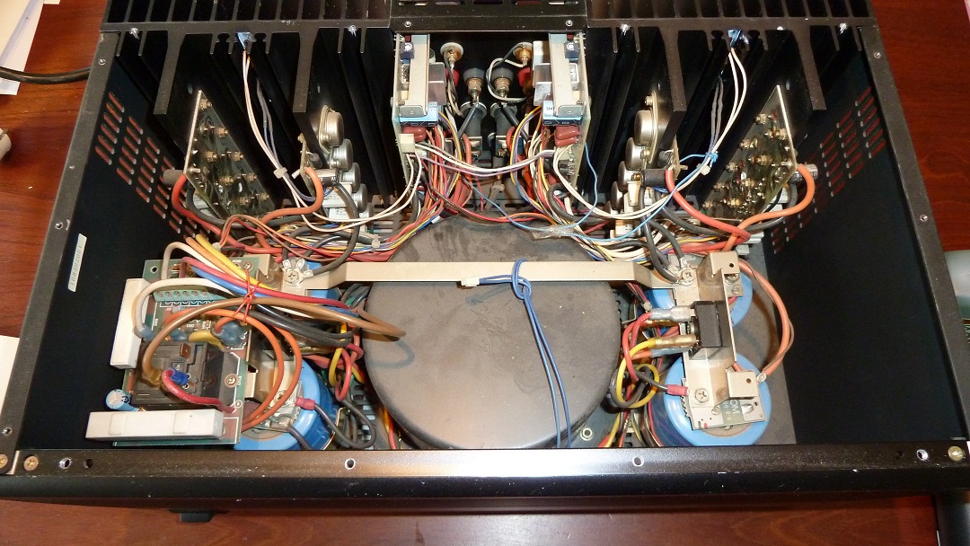

At home I started immediately to make notes off all the connections at the boards. One strange "diy" light blue cable (no not the optional fan one) was attached to both boards in a T from R101 at the Leftchannel Audio Input and R186 of the Righttchannel Audio Input the soldered together and isolated with adhesivetape you can see on top of the toriodal and both the running to Connection 7 at the Right NPN board (this is connected with thick black wire to the minus post of one of the large can capacitors. Total amaeuristic job probably ment to keep the thing stable after the serious damage at the leftboard.

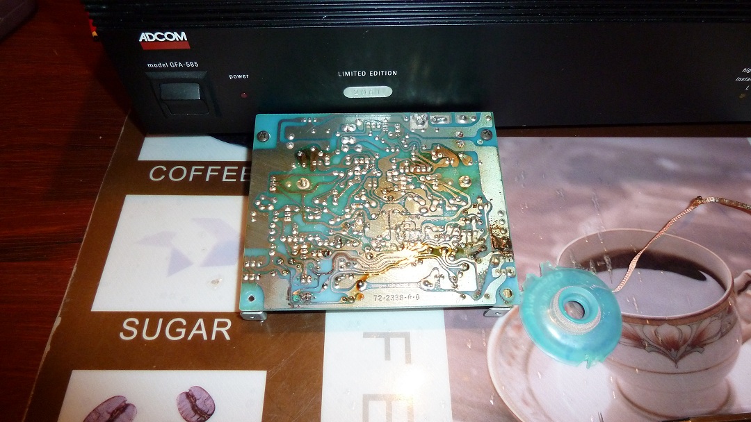

The three Elna 'longlife' caps are definitely leaking and corroding the leftboard.
The servo IC 101 was had some of it legs corroding and two resistors (not the fusible 10 ohm ones) were burned out and open (R206 & R208, 1.21 kohms 1/4 Watt)
It's amazing the amp played at all.
The right board was already been taken care of with a possible easy cleaning and cheap electrolytes.

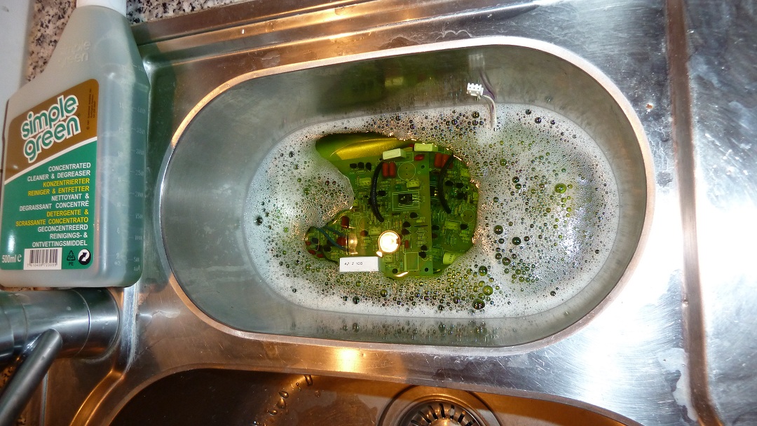

I cleaned boath boards by letting them bathing in a hot 1 to 5 Simple Green solution. After that I dried them with a blower.
Then I cleaned leftboard again by sparying Simple Green directly on the board and cleaning it with a toothbrush especially on the corroded spots.
