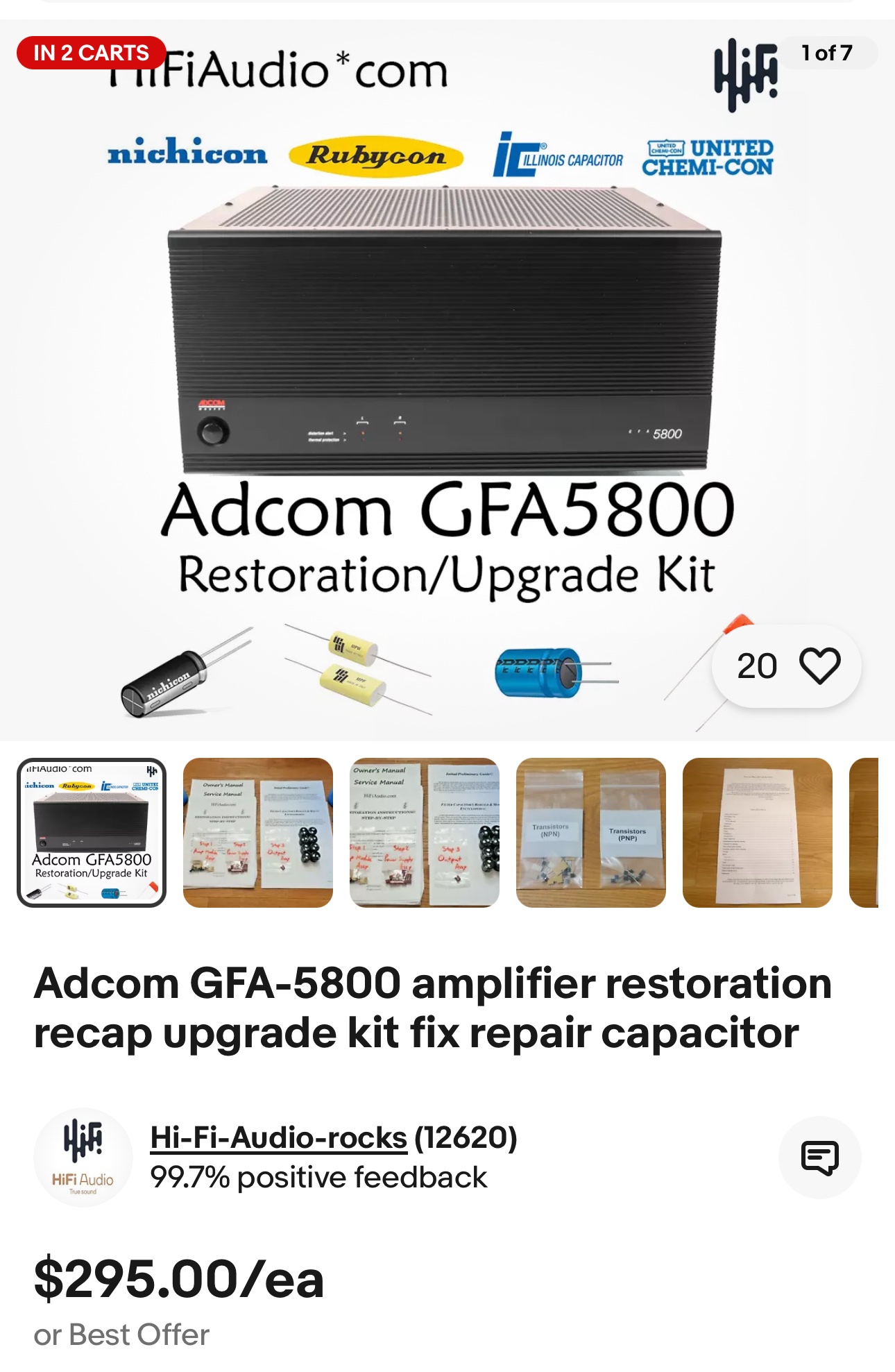

I got all the parts from a guy on eBay, he will also give you the instructions for replacing them, many are higher quality than the originals , he gives you all the caps even new film caps, very responsive if you have questions, I found the biggest problem with my 5800 was the power board caps. The big screw caps were still perfectly fine. 300 bucks for all the caps was very reasonable, especially being as you get 4 of the big screw caps. They are normally like 150 for 2. From what I’ve found.

Yes I’ll post a link, this guy has all the caps, upgraded plus he gives you instructions, you probably won’t be able to find a better price, 295 bucks for all the caps, he includes the j/fets, but he recommends only to change them if there is a problem with them. I do have the adcom service manual which is all you really need to install the caps. Some of the new ones he provides have a bit higher uf which is good.

If the big screw caps are fine then you are paying for nothing?
Because I wanted them. Great deal if I need them or I can resell them as well.
