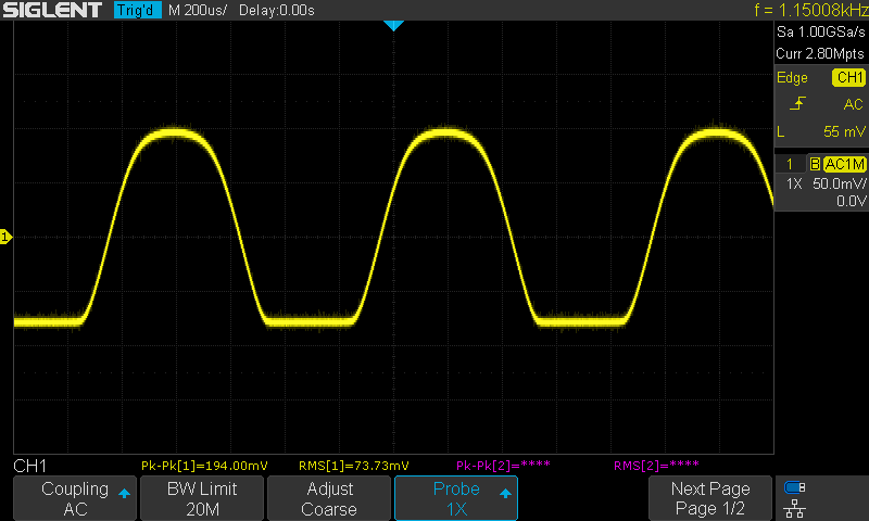

If I disconnect the output from the input board and measure the voltage at the output to ground, would I still see the +1.6V and the -1.6V?
Or do I need to install the two 1k ohm resistors like you show to check the board with?
I disconnected it and got +-87V.
Trying to figure out if the output board is messing with the bias voltages.
Gary
I disconnected the input board from the output board, installed the 2 1k Ohm resistors as outlined in the instructions and provided the feedback.
Below is what I'm getting from the input board;
Looks like in all my trouble shooting, I killed something, maybe Q108?
On a positive note the bias voltages look good!
So I'm thinking my original problem is still on the output board.
I remembered this morning that I still had the output wire connected to the output stage. So I disconnected it and it was better.... for awhile and then it went back to the same waveform. Not sure what would cause that.
Could it be the matched pair Q101 & Q102? They are the only ones I haven't replaced. I did check them.
Another new item is the distortion LED is coming on now.
